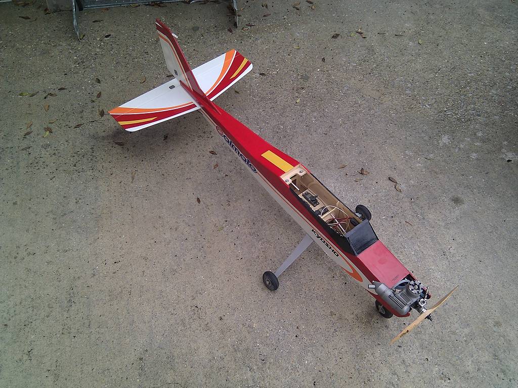

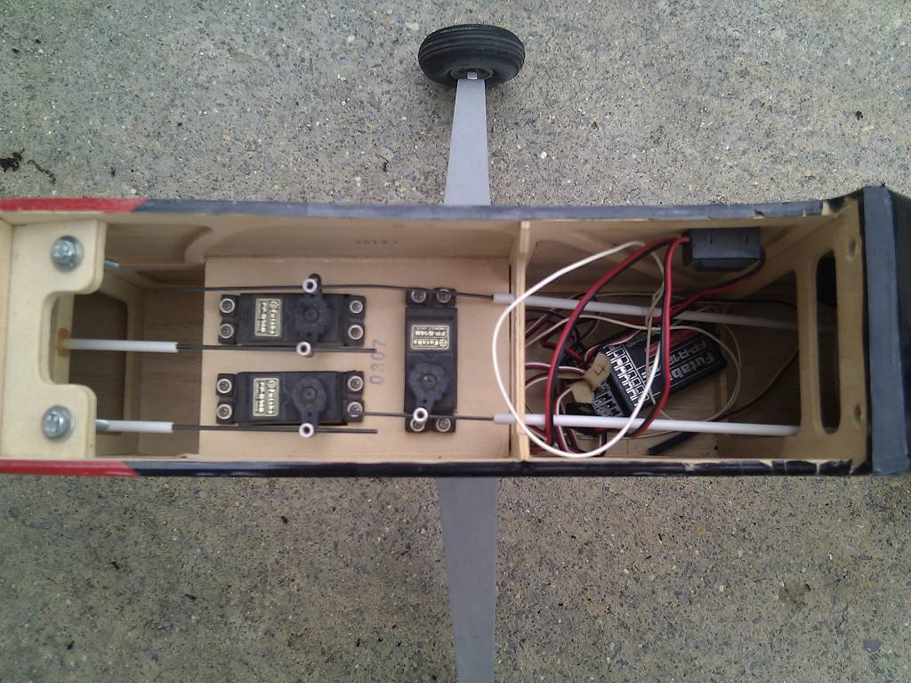

I'm about to leave on a sailing trip, which will delay getting in contact with a RC group. In the meantime, I took some pictures of my plane.
Do you name planes?<br type="_moz" />

We sure do. That one looks like a Leroy to me.
One thing I noticed is that you have kwik links on the servos. Those are fine when they work, but the flexing in use sometimes can work them loose with rather unpleasant results. The big problem is that one that's about to fail looks exactly the same as one that is working fine, so they tend to surprise you. An L-bend with a plastic keeper or Z-bend are about as fail proof as you can get on linkages.

wrap that receiver in foam, the rattling will make it malfunction.
After fueling you can blow into the hose that is fitted to the muffler, this will/should start the fuel flow to the carb, you can also remove the needle valve to clear out any clogs, careful not to get fuel in your mouth. Needle valve likely needs to be open 3-4 turns to let enough fuel into the carb to run it.
Wise to change out the glow plug now too.
A little shot of fuel into the carb can help initial starts, carefull of what is in front of plane, you can such plastic bags or paper towl into the prop or curious pets...
Starters usually work best with spinners.
Chicken stick, and a leather glove works OK too.

Awesome, thanks for the replies!
I googled kwik links and came up with something similar to the little silver part that attaches the control rods to the servo arm. Correct? I'll be sure to replace them before getting off the ground
The reciever and battery have foam pouches that I removed to test the servos a while back
Again, it will probably be a bit before this thing is flying, I'm just trying to get everything working first.
I do have a field box, though its version of a power panel is two D cell batteries. . . I'll upload a picture when I get back. . I also have a few "plastic" props that are the right size. I've also got two starters, but they tear against the compression stroke of the plane so hard that they fly out of my hand. . . And I bought a rechargable GP (glow plug, right?) starter when I bought new batteries for the plane.
The engine is by no means new (well, only to me). I'm pretty sure the plane saw a lot of use from the original owner. I am following the 'break in' procedure outlined in the engine manual (link in first post) to try to start the engine. . . Which means I have the throttle screw turned out three turns.<br type="_moz" />
Again, it will probably be a bit before this thing is flying, I'm just trying to get everything working first.I do have a field box, though its version of a power panel is two D cell batteries. . . I'll upload a picture when I get back. . I also have a few "plastic" props that are the right size. I've also got two starters, but they tear against the compression stroke of the plane so hard that they fly out of my hand. . . And I bought a rechargable GP (glow plug, right?) starter when I bought new batteries for the plane.
I don't see a spinner in front of the prop on the plane, is it just removed for the pic, or are you trying to start the motor by pressing the starter against the prop? If this is what you are doing, DON'T!!!!!
Get a spinner or at least a prop nut large enough to fill the cone on the starter.

I've only ever had one Kwik Link come loose, but that was because I forgot to put lock-tite on it.... still I often use the collets to be sure.
Sure, the collets and locktite will work to keep them from slipping. But why make it so complicated? An L-bend with a keeper is practically indestructible and requires no tools to remove. The only place where I would say the kwik links are actually a better method is on a throttle where we rarely get the pushrod length right the first time and it can be difficult to get the clevis off of the carburetor.
They don't have to be... you can forgo the collets if you wish. I suggested them just for added safety...
While I like "L" bends too, I've actually have had MORE problems with "L" bends flipping off even with a keeper in place, than I've had with quick links.
The keeper gives, breaks or gets pushed back and it pops off letting the L bend slip out... I've had this happen on large planes...
I think that Kwik links are getting undue bad raps. A bit more TLC ( and Lock-tite ) would eliminate problems.
Kwik Links above...
But of course do whatever works for you best!
Kwik Links above...
I have yet to have any problems with the plastic ones like your pic, but I have had one of the metal ones get loose and slip off of the pushrod threads. A gentle crimp with some pliers and a drop of CA cured the problem. Fortunately, this was on the aileron of my 1/4 scale cub. If it had been the elevator, it could have been a sad day!

The newer 2.4 RX can be hook looped in some planes, but should be wrapped in planes that have strong vibrations, the hook loop tape will transmit the vibrations to the RX. The further back in the plane the better, but for the RX the OP has, WRAP IT!
Simply put, if you can feel vibrations with your hand where the RX is when the engine is running, so does your RX.
