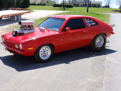

"Why yes, I do have a 1,500 HP engine in my Ford Pinto".

AMISH, I'll bet you big money you don't have the original door handles inside the Pinto!!!
I drove them when they were new and have a lot of memories about them!!

1500 HP???
Might want to have your dyno calibrated.
Looks like fun though.
