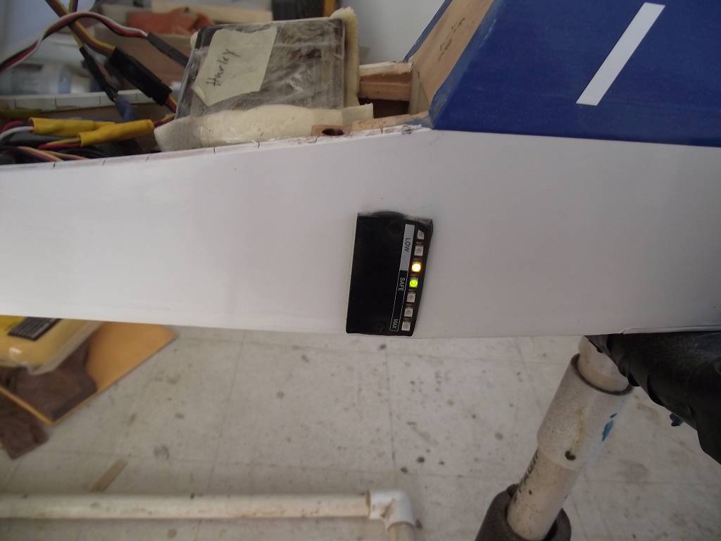

Today i connect a multi-meter to the battery,and then monitor the volt meter reading when i execrise sticks ,You know what?the volt reading never go below 4.8V even RED LED might blinks,Now I am wondering if the voly-spy is too senstive?
My Feedback: (-1)
What the photos show is my plane with a 4.8 pack using 5 servos in a snap roll, throttle is closed but I guess that still counts as 6 servos, three of them are digital Hitec and three of them are analog JR. When I release the snap roll switch the VW lights drop to the bottom LED showing a full charge. I did a stupid and mounted it aft and under the wing so I tend to forget to look at it before every flight. My bad!! These are fun to take apart and put the LEDs behind the instruments in scale planes. I once did it in a nice Hell Cat scale plane. If you have a real cockpit and canopy it's a good place to mount them so you can see it. This is an old Hots fun fly plane with no real cockpit.
Yes, the VW is quite sensitive, almost as good as an ocilloscope. That is why it is such a valuable trouble shooting tool, it gives you an indication of a problem that a voltmeter or loaded voltmeter will never show. You can get a momentary drop in voltage at the receiver bus that will never show up on a voltmeter, whether loaded or not, that can cause a brown out on a 2.4GHz system. Another great thing about the VW is that it is always connected making it so easy to check at the end of each flight before turning off your receiver to make sure the battery voltage is sufficient for one more flight or more. I see to many people that never take the time to check with a loaded VM before each flight due to the trouble of getting it connected and reading it. Nothing more useless than a meter that is never used.
