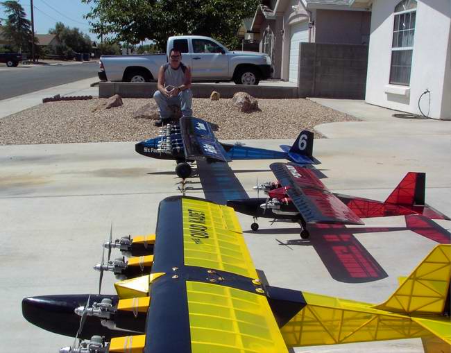

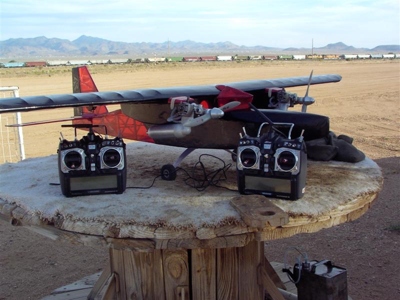

Willo jets question is about glow engines and Willo jets that is my preferred way to power all my multi's as you will get the satisfaction with the right preparation and mentoring of actually learning to maintain maintain flight on one engine in all situations without crashing and that knowledge and practice never happens with electric multi's in most cases.
Yes Skeeter out thrust is indeed a usefull tool that I use on most all my multis. What it will buy you is time to make the critical decision as to which engine is out and make the appropriate response. That response is rudder into the good engine and maintain that rudder. Most everyone will respond with aileron which will only make things worse. Out thrust will only minimise the dysmetry of thrust with an engine out it will not eliminate it entirely.
The pictures show the airplane I use for short tanking to introduce new multi pilots to the proper responses that must be learned if the airplane is to survive a long life. The engines are fully adjustable for out thrust from zero to 10 degrees and I use this to taylor the airplane to the individual student.
Willo jets I just completed and tested a Mosquito with a pair of OS .55AX's and am also working on what I beleve to be a CMP B-25 arf and purchased OS .65AX's for that. I think my current fleet of multi's around 10 now and includes twins, triples, a pair of quads and a Six Pack.
John
