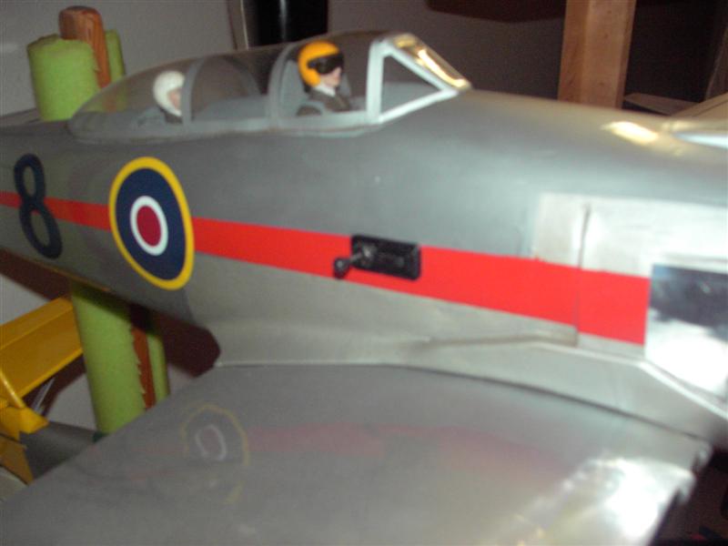

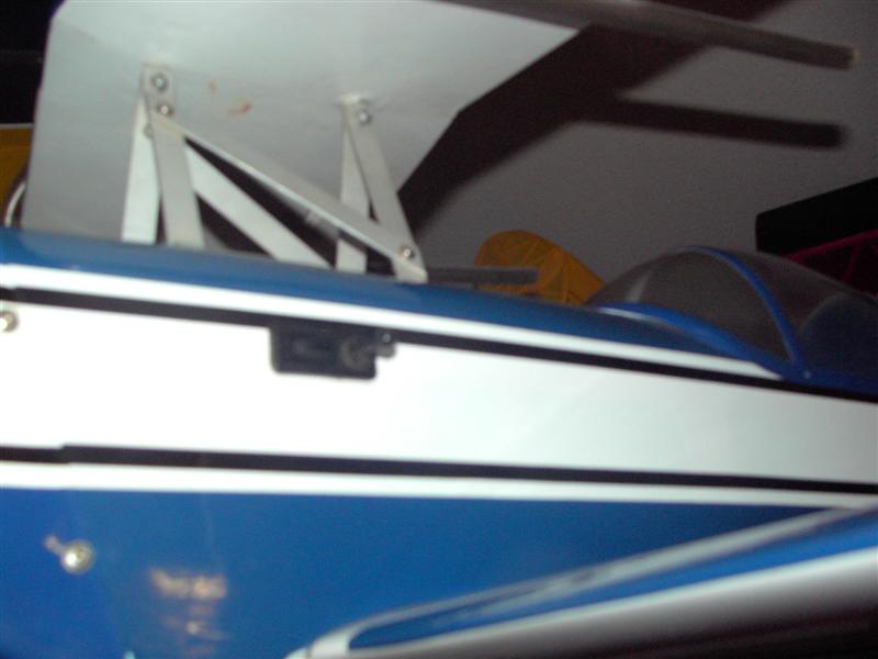

Yup that is what I am talking about and make sure you get this one: the combined switch mount and charging jack
http://www3.towerhobbies.com/cgi-bin...?&I=LXD665&P=7
John
I use them on just about everything with some minor exceptions for racing airplanes where the drag is an additional concern.
