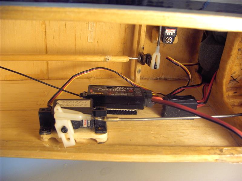

I removed the tubing all together and it works better. I realized that the battery and reciever are lose and will flop around. Any best practices or should I just find a way to tape them down so they don't move and hit the servos.

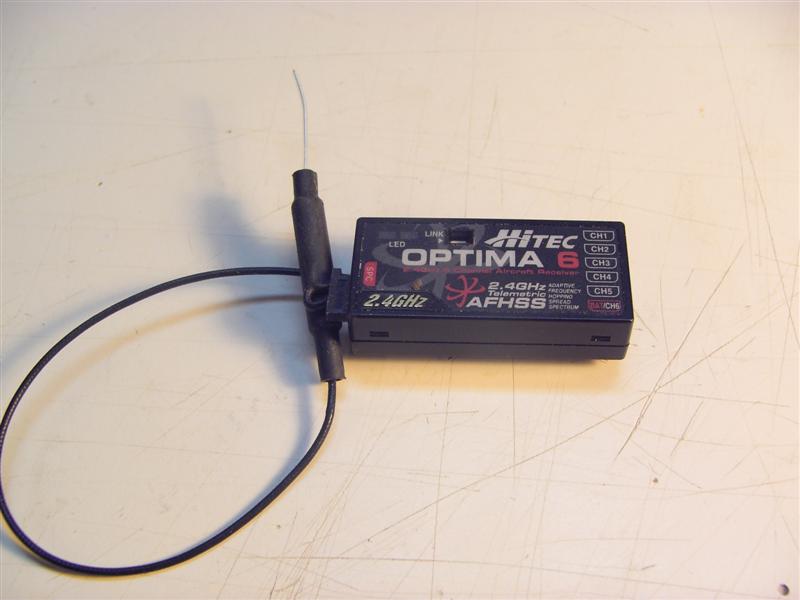

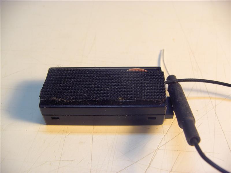

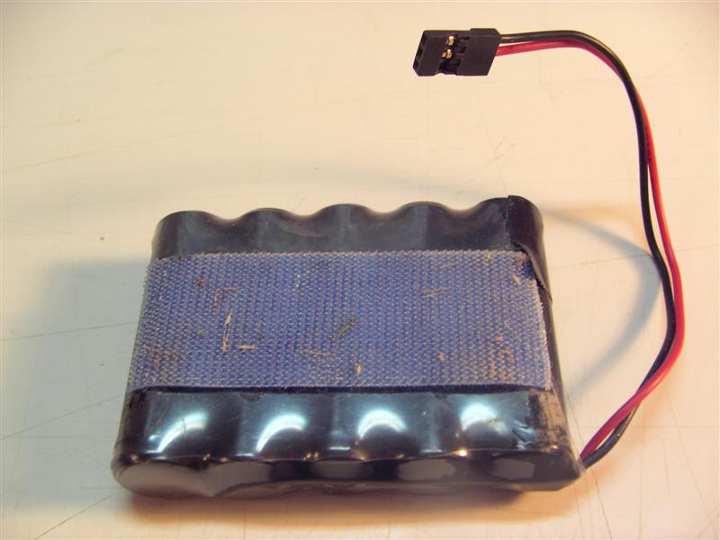

Excellent lgmac. I what I do with all my receivers these days is to purchase some Velcro. I buy it in industrial strength bulk but any kind of velcro will work. Cut a strip of the Hooks that will cover most of the back side of the Rx on this strip carefully spead a thin layer of medium Ca. next cut a strip of the Loops that will at least be the size of the rx or even bigger which gives some room to position the Rx later. This strip you carefully sprad a thin layer of medium Ca also and thin place this in the airplane where you want the RX.
The velcro will provide all the vibration isolation needed in addition this method will provide for cooling of the rx. Formally standard advice said to wrap the rx in foam and tuck it in somewhere. With the new 2.4 systems heat seems to be more of a problem and many manufacturer are recommeding to avoid the wrapping we used to do and acted as insulation.
For batterys I do exactly the same and all my batterys have the Hooks portion of Velcro and the airplanes all have the Loops glued inside.

I'll add that your battery should have a strap around it too to physically secure it to the fuselage. Some of the harder maneuvers we do can produce 10 G's, so your 6 ounce battery will pull on the velcro with 60 ounces of force. Velcro to keep it from sliding and a strap to keep it on the velcro results in a battery that will never move until you want it to.

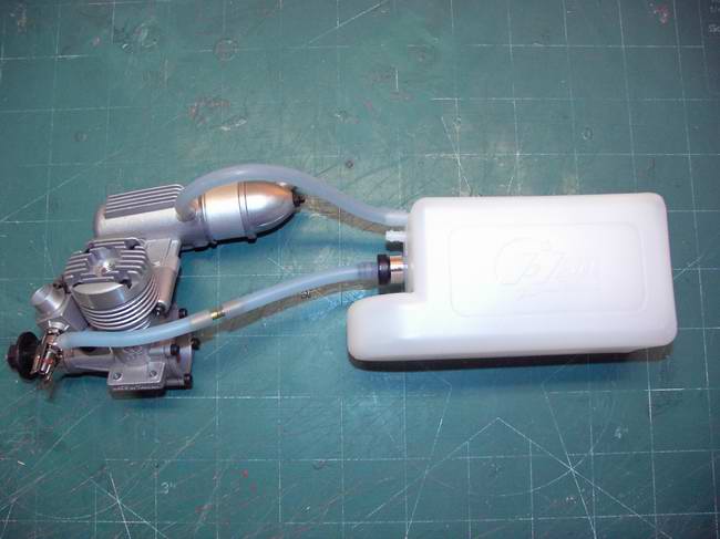

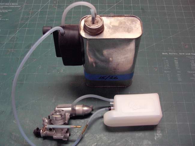

LG yes the orientation of the fuel tank makes a difference. When the airplane is sitting upright on its wheels that tank vent tube that tilts up to the topside of the tank need to be up top. Now that vent tube is the one is the one that connects to the fuel line that you route to the nipple on the muffler.
The pipe that has that floppy tube inside with a weight on it is the one that you connect with fuel line directly to the either the remote needle valve inlet or with a front needle directly to the carburator inlet nipple.
If there is a third pipe through the fuel tank stopper then this one gets a short piece of line and is where you pump fuel into to fill the tank You know when the tank if full by pulling the fuel line off the muffler and it will come out here when its full as you pump. After filling this third line is plugged with a screw or if you like there are designed for the job plugs also.
If there is no third pipe or hole going into the tank then great do not punch it out. Instead us my preferred method and only to lines, The line from the vent to the muffler and the line from the pickup or clunk directly to the carb or remote needle. The third line is not needed or desirable (my opinion).
With a two line system you pull the line at the carb or needle valve and fill from there untill it comes out the line at the muffler. If the carb or needle valve is in an akward place to remove and reinstall the line you simply cut the clunk/carb line in the opern and install a half inch piece of brass or aluminum fuel tube and fill from here. It is the most reliable plumbing senarios as well as the simplicity for fueling.
I will post a picture of the little short piece of tube in a moment.
