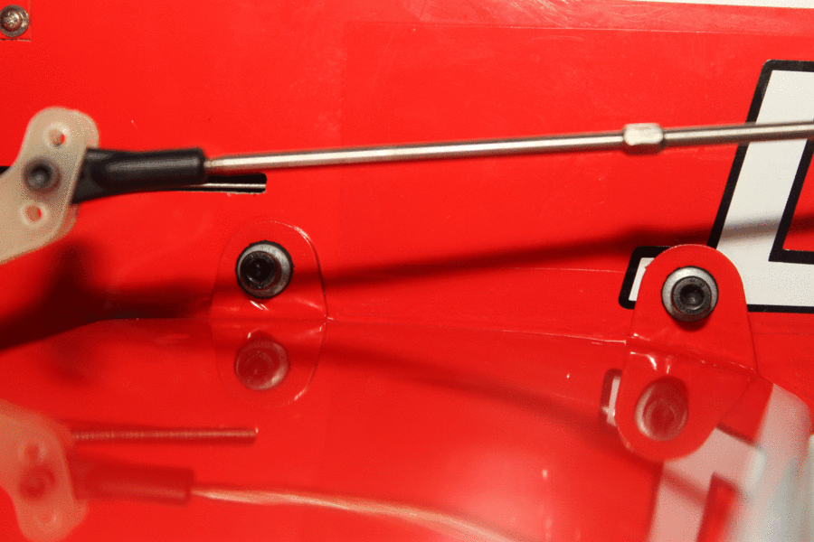

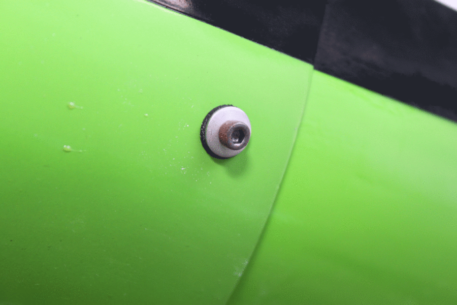

Here's something else you can do if you're not happy with that solution.
Take the yellow inner portion of a nyrod pushrod.
Drill out the hole so the nyrod fits snugly inside. Scuff the nyrod and expoxy it into the screw hole.
Install the cowl with self tappping screws and (here's the secret for getting screws to stay put on gassers) use rubber bonded or sealing washers on the screws. RTL Fasteners sells the bonded washers in various sizes.

Been there done that, sealing washers do the same thing with less work..... I'm lazy

Best way to secure a cowl is to bolt it to the firewall trough the front opening using sheet metal screws! No using bolts trough the sides!
