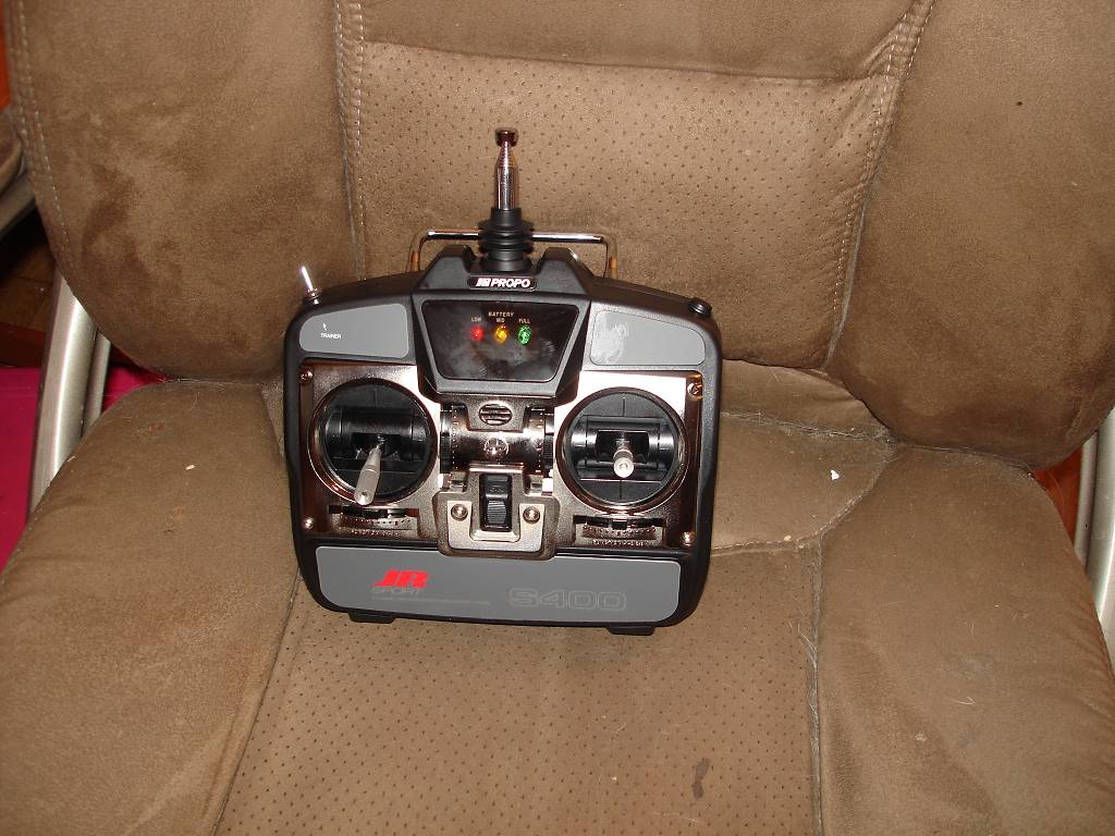

Old 02-04-2013 | 03:53 PM
goirish's Avatar
Joined: Dec 2005
Posts: 5,130
From: Litchfield, MI
Default RE: buddy boxing a dx7
Here is a picture of the tx.
Old 02-04-2013 | 04:16 PM
Joined: Apr 2006
Posts: 2,275
From: Warialda NSW, AUSTRALIA
ORIGINAL: goirish
G'day Mate,
See manual attached, over here it's called a Quattro, looks the same as yours, 4 channel & it is FM PPM.
Be aware, FM PPM is the base system, as they got more advanced they had the option of PCM.
So when it comes to JR, usually, if it's FM, it will be PPM, with the option, if available, of PCM.
Cheers

I realize its late on this one but just wanted to reinforce what Alan has already posted. The JR two conductor buddy system did require at least a charged battery in both unit units. I have in the past used a 662 and buddied with a 400 or quantro. Their system was nothing like Futabas and most of the others.
John

I don't do much training anymore, however when I did I had Airtronics, Futaba, JR, and Hitec. Still do.
As stated above, JR needs some current outside the Master Transmitter. Now make it easy on yourself. Those small squarish ( 9 Volt small alkaline batts with the snap on tops work as well as one needs.) They are inexpensive and will supply plenty current for the JR buddy box to work.
Radio Shack has snap-on tops available at just a small price. Solder an old JR or such connection to that batt. snap on top. You can figure out how to do that.
They last a long time for keeping the slave Transmitter energized. BTDT!
