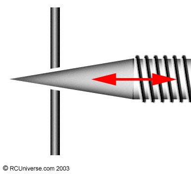

3. How does the needle valve work?

3 A Needle valve is just that... A needle that goes into a hole to adjust the fuel flow (See Pic)

The needle valve works by having a tapered needle that fits in a small hole. As you screw in the needle, the hole gets closed, reducing the flow of fuel in to the carb.
