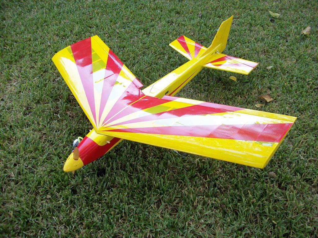

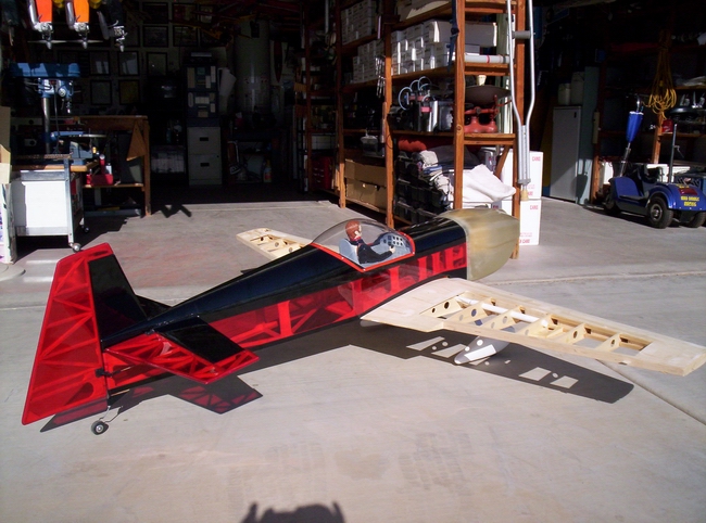

Here is some transparent red Monokote. Looks beautifull when the sunlight passes thru it. I can say i've ever seen one covered in clear Monokote, but that would definately be different!....Gene

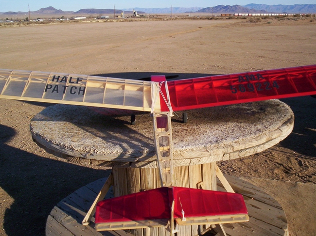

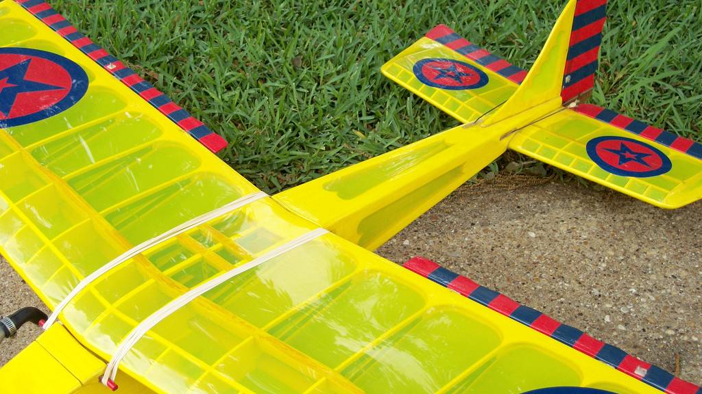

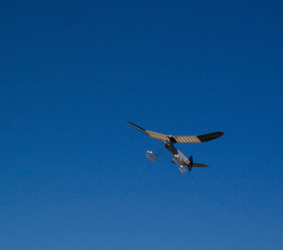

I love the transparents and to this day the vast majority of my ships have used many variations of the color transparents. The Monocoat clear is wonderful also for side windows and thats what I use on most of my stuff.
As far as clears go I only have two with about fifty/fifty clear. The oldest is my Kerswap and has been flying on wheels or pop bottles for about fifteen years now and is not hanger a queen, powered originally by an OS .20 and currently by an MVVS 1.5 diesel. The other airplane is an old PTE modified a bit and its about 13 years old, powered originally by an old car can motor and a six cell 1700 nicd pack but currently with a small outrunner with a 11.1volt Lipo.
John
Oh ya forgot my Airco Aero Nine built it about ten years ago or thereabouts and it a replica of my first successful RC ship back about 59' It has an all clear wing.

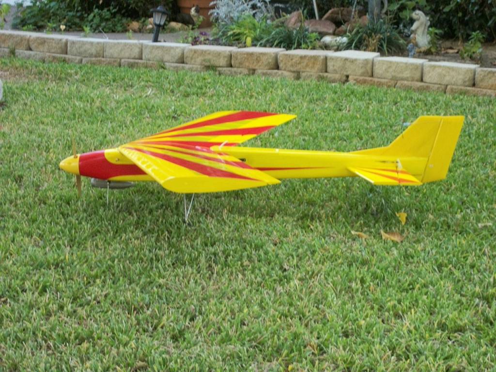

Here are some of mine with transparent yellow......
Frank

Hey Frank, what is that plane in your first pic with the swept wings? I like those stick looking things with the wing swept. Eureka has a Hooker short kit for $100.00 that looks really interesting.
Max

For lack of a better name, it's a sweeper 60. My design. Weights almost 5 lbs and powered by a O.S. Max .61 SF. It's as fast as it looks.
Frank

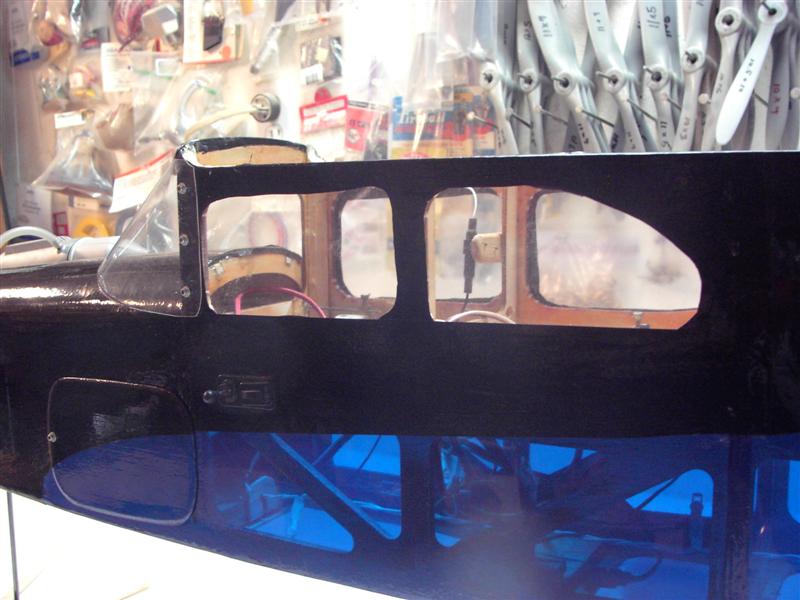

Here are the simple side windows of clear Monocoat, They look great and generally far better that resesed plastics or glued on sheet plastic.
The trick is to cover the areas where the window bays are with clear monocoat then use an opaque layer of monocoat over this with previously cut out window frames with a blade before the opaque monocoat is appliedl. The cutouts are best done with the monocoat backing removed and on a pane of glass with a nunber eleven blade.
John

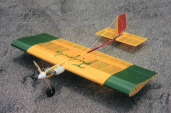

Here is two of my planes covered with transparent monocoat. A Tadpole and the Lite Bipe. Both built from plans.

John, im rebuilding a Kadet Sr & i'll try the clear mono over the side windows on it. Good tip!....Gene

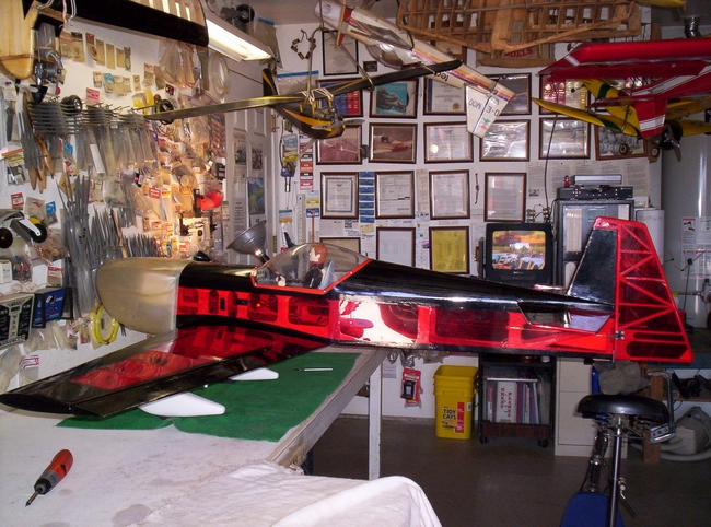

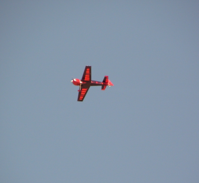

Hi Mike (evans2u) good to hear from you and hope you get back to flying soon. Here are a couple of pictures of mikes Black Widow I finished up a couple of years ago. Black with clear red monocoat.
