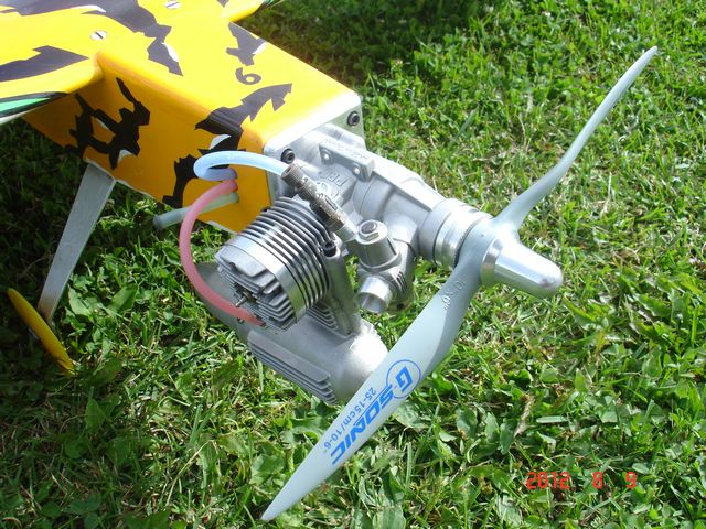

i use a drill jig and drill mine with a drill bit, holes seem to be straight and round, the prop bolts on the crank just fine

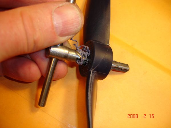

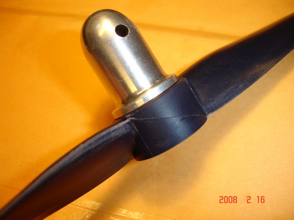

Default RE: Prop Mounting
Hi!
Go with a tapered reamer! And sand the trailing edge slightly with fine sand paper (500-1200).
