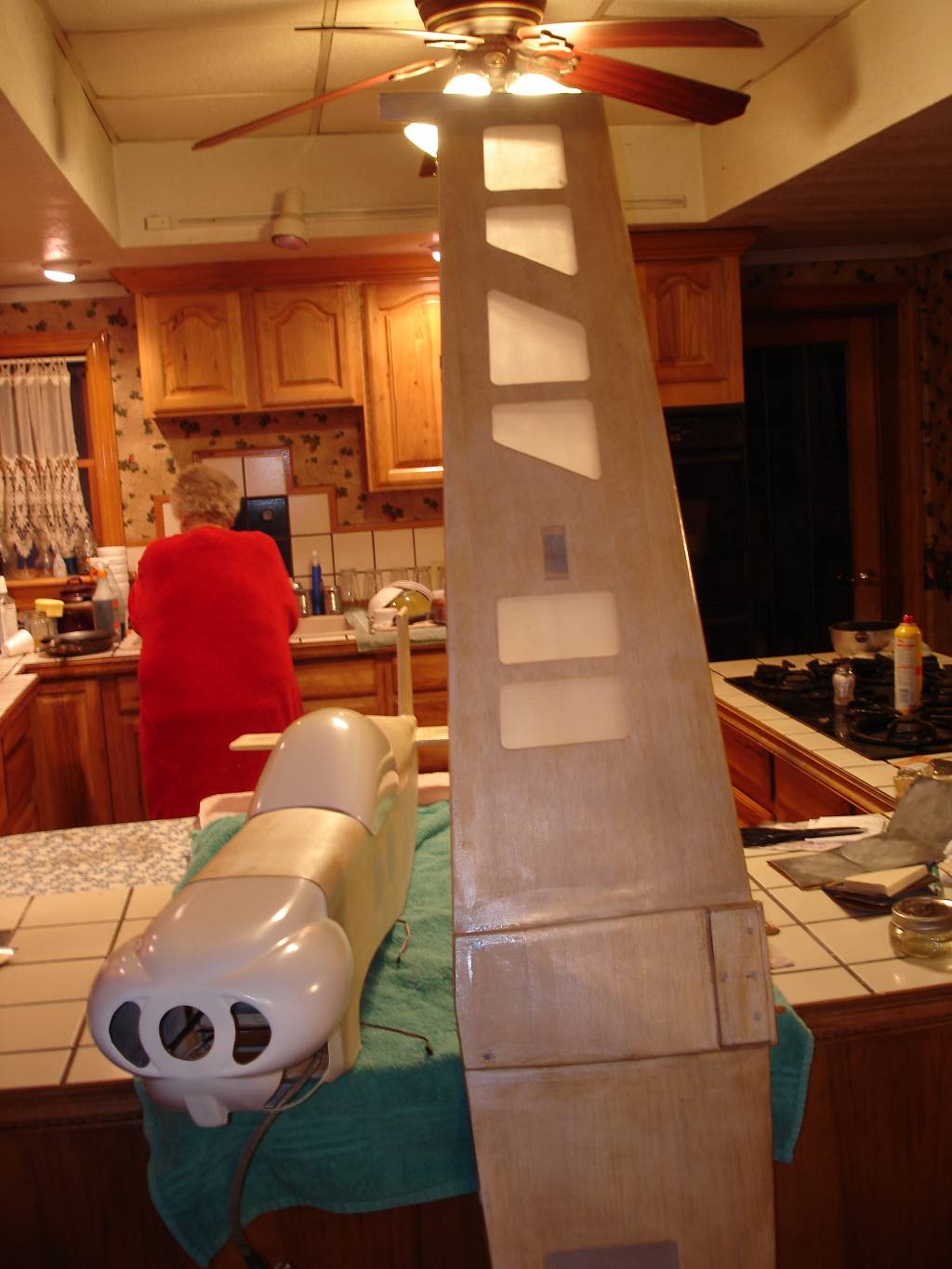

OK Chopper Man
Here is a picture.

ORIGINAL: goirish
OK Chopper Man
Here is a picture.
I don' see no stinkin' pick - chure!
HAY THAR! I tried it a second time and behold thar be a pick-yure.
Lookin' gooood!

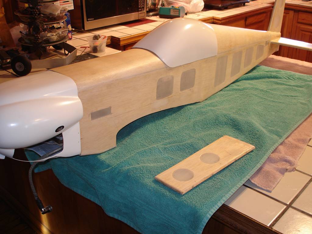

Here is a picture of the wing. I used Randolph nitrate and butyrate. I only have the nitrate on in these prictures. It will be powered by a DLE-55

Klass Kote over butyrate and silk works just about as good as K & B. Silk was applied with nitrate with a butyrate & talc filler.
John

Thanks for the picture!! Looks good. You have to love it when we take over the kitchen with our planes.

I can't answer that question because I have not used Koverall. All I know is that the silk goes on great and easy around curves. I did put mine on wet, stretched it tight then nitrate the edges until the silk dried. I am just about ready to spray the paint on mine.

It can be just as lite, just depends on how much paint you put on, especially the primer. One of the great things about silk is, it is super strong and will last just about forever if done properly. You just can't beat a good silk and dope finish for looks. It can also really look bad if done wrong, and that includes MonoKote. Iwould much rather have a good silk job then plastic any day.
That is one great looking covering job. If your finish looks anywhere near as good as this, you will have a fantastic looking plane.
