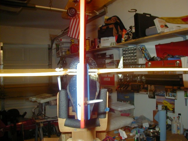

I'm currently building a H9 AT-6. Last night I installed both elevator halves which are connect by a joiner wire rod enabling them to move together up and down. Well, I failed to make sure they were properly aligned and allowed the 30 minute epoxy to cure with the elevator halves uneven. What can I do to remedy this bonehead mistake? Am I toast? Send help!!
thanks in advance.

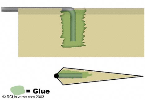

Here's a good fix, but it will require some minor surgery.
Flip the elevators upside down and cut open the bottom side (The bottom won't show as much) of the low elevator (in this case, the left one. Also note that now that it is upside down, it will be the RAISED elevator). Just hack away until you can free the rod.
Now lay both halves flat (the rod will be pointing slightly up), and add some 30 min epoxy into the opening. Let the epoxy thicken a bit, then fill the cut-out some more, and cap it with a piece of balsa the same size as your cut-out.
Once it hardens, sand the balsa cap smooth, and re-cover.
Note: The way to prevent this in the future, is to drill the holes slightly oversize, then add some epoxy to the holes before inserting the torque rods, then lay them FLAT. This will put an epoxy "Sleeve" around the wire and compensate for any misalignment.

Minn, thanks a million for your illustration, nicely done. Thing is H9 designed the AT-6 where I had to thread the wire joiner through the end of the fuselage preventing me from laying the elevator halves flat on my bench. This whole bonehead fiasco could have been prevented if I would have only taken more time to do it right and taped the halves to the horizontal stab. I also epoxied the wire to the LE of the elevator. I'll have to cut that part out as well. Nevertheless, I did learn my lesson.
Thanks again.
please check back tonight, I'll post a pic of a different angle showing how the wire joiner is threaded through. I'm at work now.

Minn, thus far it's working out nice. Here's a pic. Thansk again.
