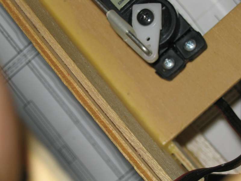

The problem is that when the servo moves all the way to the extremes, the plastic part is hits the servo arm. And to think that I was a E.E. major. LOL. Let me see if I can post the pic.

Here is a pic with the servo at its extreme.

Lot's of good suggestions above.
Do you NEED that much servo arm travel? Cut down the travel (EPA, ATV) so you don't have the binding, and maybe move the clevis on the opposite end to a hole closer to the control surface if you need to. Or a longer servo arm plus less travel.
Do a "Z" bend instead of the "L".
Turn the rod around so the "L" is at the horn (but more of a pain to adjust at the servo).

I most probably will not need that much travel. I just thought that normally, you would put the servo to its extremes to test if there is any binding. Well, thanks guys.
