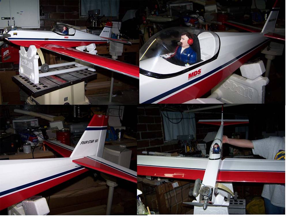

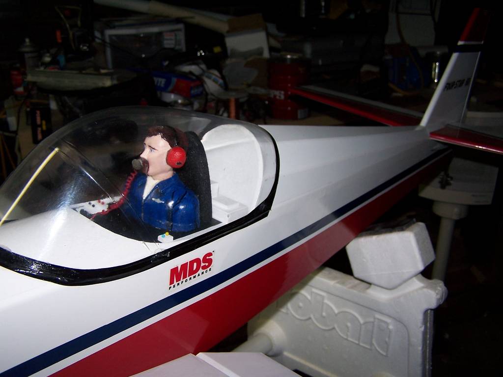

I have all the planes you are talking about. I have the Four Star in 40, 60 and 120 sizes and I have two Astro Hogs, one "normal" one built from a Sig kit and another which is 80% the size of the Sig original.
All fly well though my favourite would have to be the Four Star 60 as it is just that bit bigger than the 40 and I find it easier to fly.
The Astrohog is more complicated to build and has a higher wing loading due to its relatively complex structure. Remember, it was designed back when RC was in its infancy and the average plane had a life expectancy of ten flights. (I know that the Sig kit is not the same as the original 1957 Hog and that the Sig version has been simplified but it is still a tough little bird and so a little on the heavier side).
My favourite 60 started with a Saito 72 in it and it flew well with this engine but I later put a Saito 100 in it and it flies better with the larger engine.
The 120 is particularly nice to fly (mine is an ARF though I have built the kit for a friend) but it is quite large and as a result, it does not get that many outings. If you have a large vehicle you will love it.
You might also like to consider Bruce Tharp's Venture 60. Bruce designed the Four Stars when he worked for Sig. He is on his own these days and his Venture 60 is a Four Star with its problems fixed. One glaring fault of the Four Stars is the position of the undercarriage. It is forward of the ideal spot and as a result, the Four Star must be slowed down until it goes nose high or it will bounce back into the air. It just loves to fly.
Hope this helps a bit and does not add too much confusion.
Mike in Oz
PS, that is my Four Star 60 on the left when it had the Saito 72 in it.

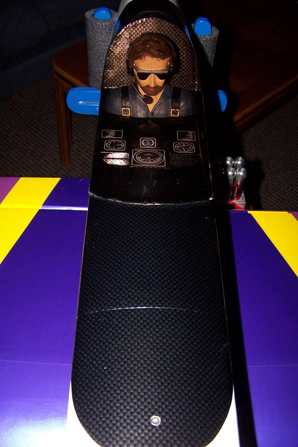

Always loved the 4* I built the 60 first then moved up to the 120 size for a gas engine both flew wonderful. That carbon fiber Ultracoat sure made the cockpit look neat on my 120.
