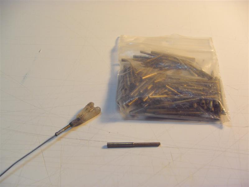

+1 on the cable push rod......Gene
I use the flexable cable inside a plastic sleeve with screw-loc pushrod connectors at each end. VERY easy to adjust your throttle & servo this way. Tower hobbies sells them & they are sold by Great Planes. I use the brass ones and buy them in bulk for less tha $10 a dozen......Gene

Here is a relitively simple, inexpensive solution that provides very free and easy throttle movement. Just forget that provided position that virtually all arfs provide and mount the servo in the forward compartment all the way on the right side simply done by just mounting a couple of sticks to your servo and cutting them off even then epoxy them to the sides while still mounted on the servo.
Now the second part of the solution is to forget the stiff and large rods that are typically provided and use music wire of a much smaller diameter. Normally at the LHS and around 30 to 40 thousanths. Use solder on thread ends and then a plastic clevis or ball cup. At the servo use an EZ Just with the set screw. this wire is quite flexible and works even better than the stranded flex wire for any kind of reasonable bend. The beauty is you seldom even need to use an outer housing which frequently causes all the bindings with bends.
This is a system I use on just about everything and it offer the smoothest and likely the most friction free operation of all.
