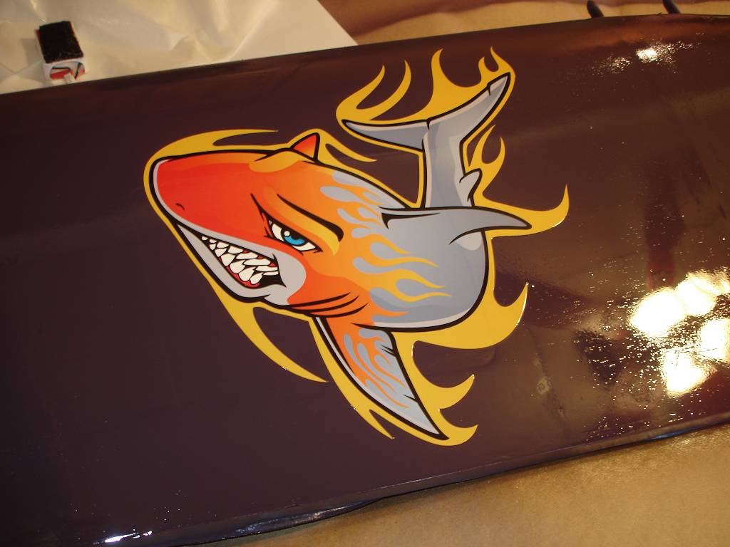

You may be right Bozarth . I think I will use that as the point like you and jetmech05 said. BTW- here is the graphics that I put on the wing. It is a G-Shark plane so I had to put a shark on it.
