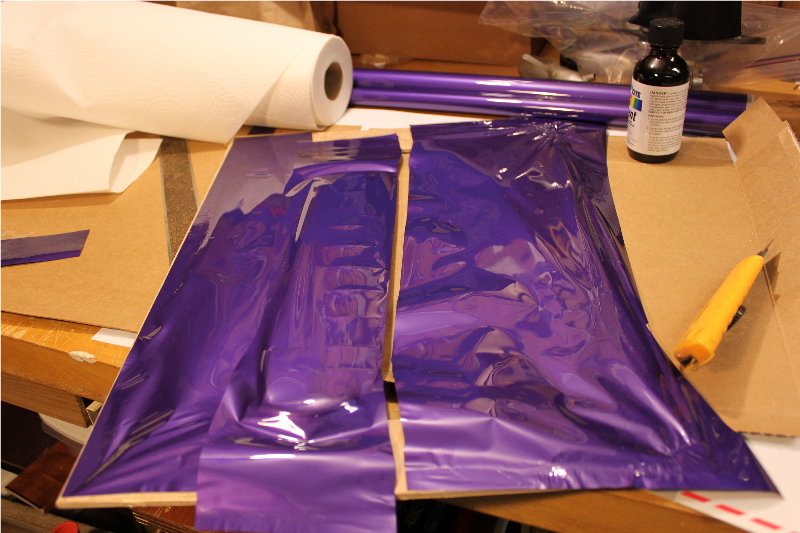

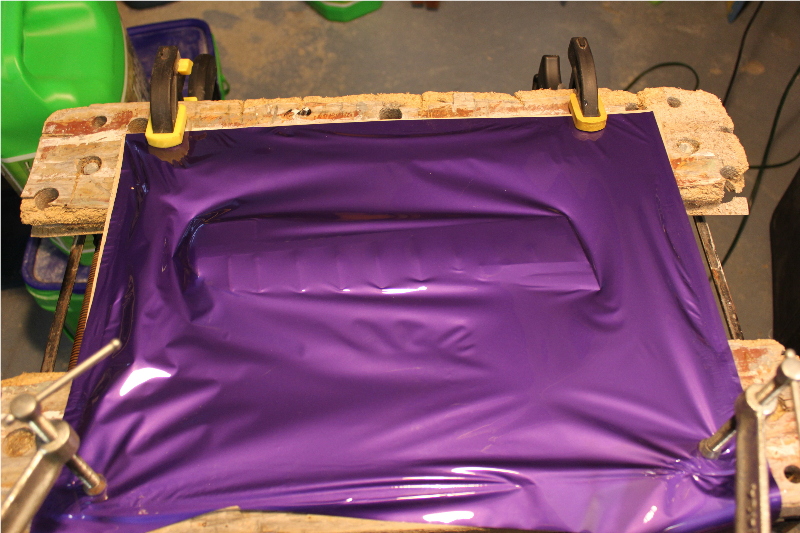

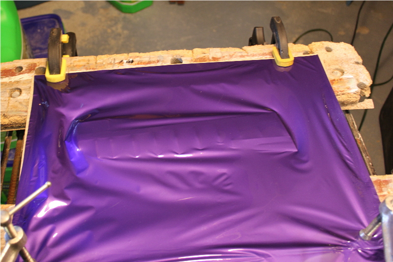

Hello,
I was trying to cover some elevaltor half's for a Top Flight Corsair and was horrified with the results of my first try. I Made a frame out of 1/4 sub floor sheeting left over form my field box build ($10 per half sheet at Home Despot) the frame's inside is a couple of inches bigger than the elevator half on one direction and a couple of inches bigger than the rudder in the other direction.
I now cut a piece of covering the same size as my frame, iron it onto the frame and clamp the frame to my workmate with the jaws open with the covering glue side down. Now I can push the part to be covered up from underneath while heating the covering with my heat gun. The results were good, next time I will iron on a 1/8" striparound the elevator tip wich is a compound curve.
I will post pics when the site seems to be able to show them, I am going to redo the first elevator covering job that I did without the jig.

Yes I understand, but with the shape of the elevator with the corners, ribs, and compund curvesetc this "jig" I made just made it that much easyer, it is good for those small odd shaped parts, almost like vacu-forming the covering to the part, but you push from underneath instead of sucking the covering onto the part. I could just about get the covering all the way around the tip of the elevator with nary a wrinkle, from there I justpullit free of the jig and either pull the covering around the rest of the tip, or just cut it as far around the tip as Icould get it wrinkle free, and use a 1/8 inch stripon thetip,not one wrinkle. I will post some pics.
Calvi

Ok, I am going to try to instst one to start this is the elevator after it has been pushed up from under while heating the covering with heat gun.

Interesting. How much ( if any ) of the excess material is salvagable?

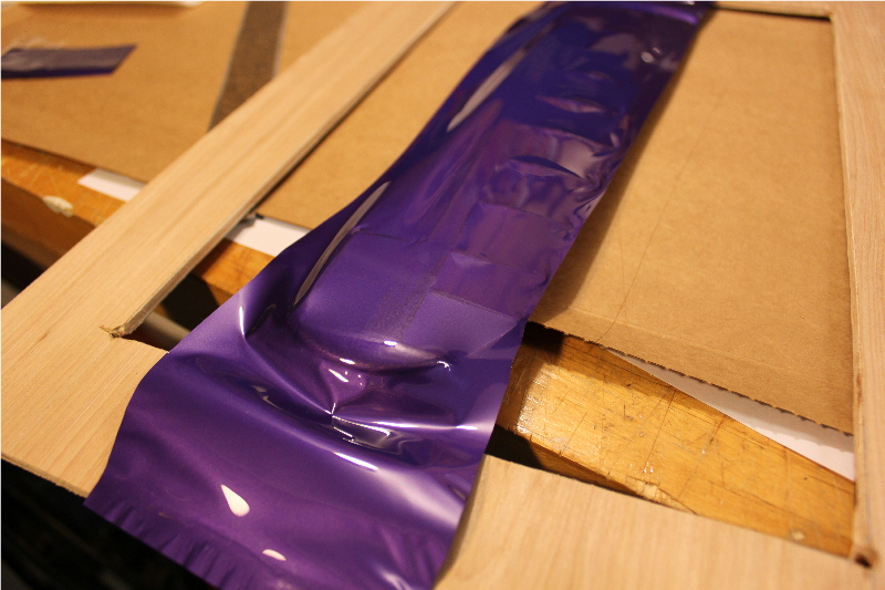

Ok so far so good, herer are a few more,
ID:	1871970   Click image for larger version
ID:	1871971   Click image for larger version
ID:	1871972   Click image for larger version
ID:	1871973   Click image for larger version

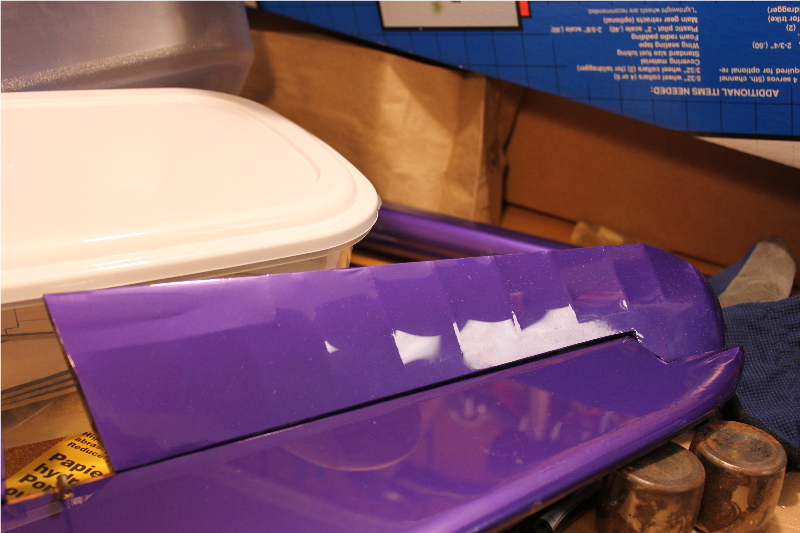

You can see that I did a decent job without having to bore my wife or kids to tears helping me by holding and stretching for me, note also the elevator I did without the jig, strange that my rinkles apeared in the corners and the tip.
ID:	1871977   Click image for larger version
ID:	1871978   Click image for larger version
ID:	1871979   Click image for larger version

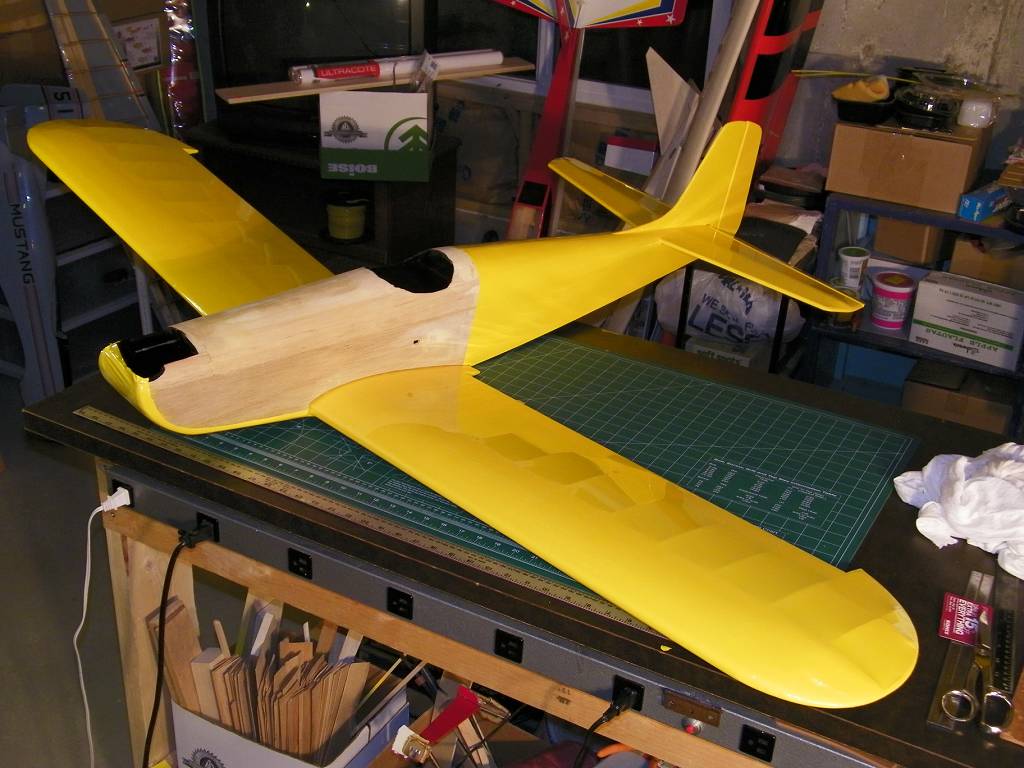

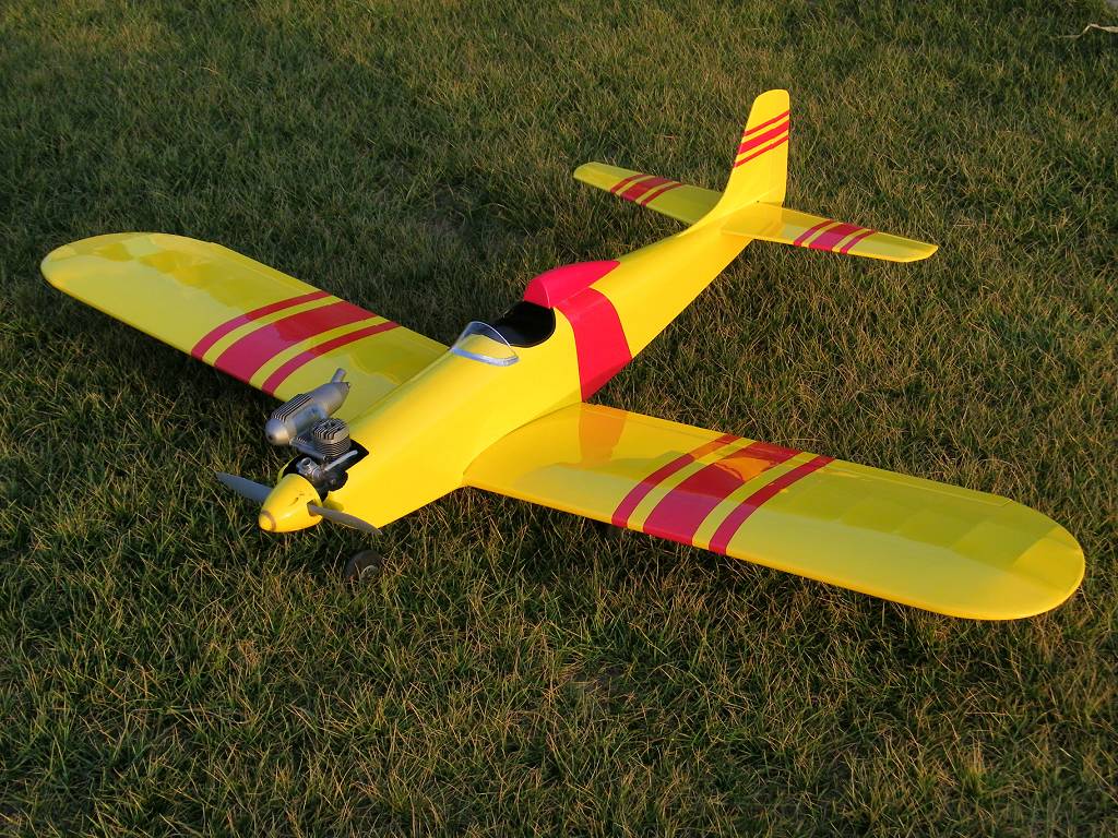

That's an interesting way of applying covering, but is the material really getting stretched as tight as it should be before being shrunk? I guess the first trip into the sun will let you know for sure.
Here's my Sig Astro Hog. I covered the wing using one full roll of Monokote, and barely had enough. There is only one seam at the center after I cut the roll into 4 pcs, so each wing panel is one piece center section to tip. I also did the stab one piece center to tip, upper and lower. Those rounded tapered tips took a long time with a lot of pulling - close to 2 hours for each upper half, and each lower half. The real key to applying the iron-on plastic covering is to take your time pulling the wrinkles out. You'll have to unstick it as you go several times to pull more wrinkles out, so don't do more than enough of a tack until you have the wrinkles pulled out, the use higher heat to seal the periphery. And don't be scared to pull it hard. You'll be surprised how strong a balsa structure is, and how touch the material is too.
Hogflyer

Good point kwblake, I will just hang onto the "leftovers" and hope they will come in handy somewhere else. Nice covering job Hogflyer, I only used this technique on the elevators and rudder for the Corsair as they are small,finnicky complex things and I was not happywith my first try as you can see in one of my photo's,and usually do just as you described while covering.

The result sure looks good, but for me, I like to pull it tight on all sides by hand first before using a heat gun for the final shrink and gloved matt down.

It's a new idea but I think I'll keep doing it the old way and not waste so much covering, it to expensive now .

I think I'll buy some stock in TopFlite. You're using way too much covering in your method. As previously mentioned, all you have to do is tack the corners and ends, seal all the way around and then shrink. I almost never use a heat gun. I use an iron. If you get it too hot you'll melt through it or apply too much heat that when it sags later on you won't be able to re-shrink it.
One thing you have to remember is that although it is not visible, there is a grain in Monokote and it runs the length of the roll. You want this grain to run spanwise on your wing and tail surfaces otherwise as you shrink the covering it will not bridge the ribs and will cause a droop between them.
