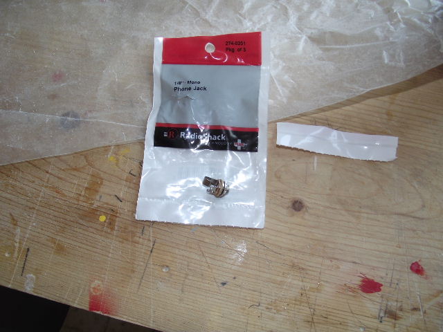

Old 05-17-2013 | 04:56 AM
Posts: 737
From: Billingsley, AL
Default RE: Onboard glow, dummy needs help again
I did have problems with the store bought system. The spring in the jack is cheap and will lose contact. Radio Shack might have a better quality jack.
