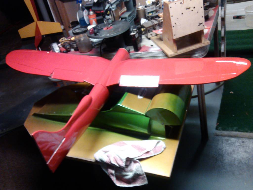

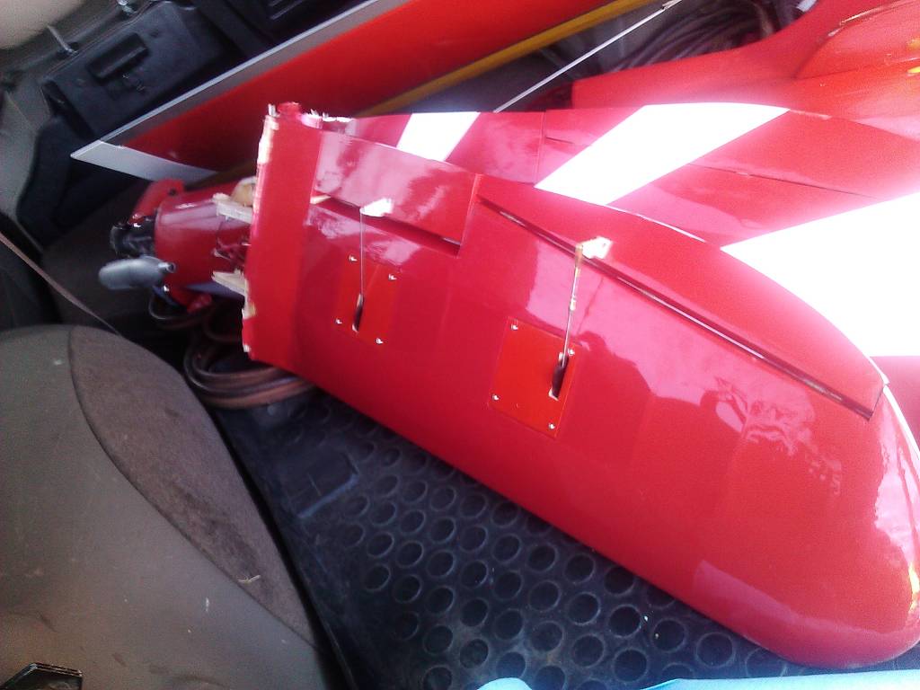

Yesterday I totaled my 60 powered plane. I never used flaps before and approached for a landing at about 1/4 throttle, I deployed the flaps and plane seemed intantly nosed up and stall, I hit the throttle and tried to abort but she just kinda fell straight out of the sky I had no control it just quit flying and rocked back and forth a couple times before it planted nose first.
I need a quite a bit more flying experience before ever trying that again, not sure i want to rebuid this one or any other plane with flaps!

Don't get discouraged. It takes practice to fly with flaps and the first part is getting the plane set-up properly. After you rebuild this one and take it up again, go up 2 or 3 mistakes high ,slow down to about 1/3 throttle ,deploy the flaps and see what happens. Typically the nose of the plane will balloon up a bit or it will balloon a lot ,or sometimes it stays straight and level, Depends on the plane.
If it balloons up you have twp choices, either fly it with forced down elevator or preferably program in a flap-elevator mix where you can adjust the amount of down elevator applied automatically when you deploy the flaps. You take it back up in the air and lower the flaps again and test it. If it still balloons up then add some more down elevator. What you want to achieve is to lower the flaps ,keep the plane level and it will start to slow down.
Once you have the mix dialed-in then go up again 2-3 mistakes high and see how the plane stalls with flaps down. Slow the plane down with flaps deployed and see how it reacts. Keep lowering the throttle until the plane stalls then increase the throttle and regain control. Hopefully the plane just slows down and begins to loose altitude. Some planes will slow almost to a crawl with wings level while others will drop a wing and start to spin. You need to find out how your plane will react and how much throttle it needs to keep flying.
Landing with flaps takes practice. I'm still learning about them too ! You can't slow down too much or you risk a stall or you land too short on the runway. If its windy you usually don't come in with flaps. Rebuild it and try again !

Another question is: How much were the flaps extended? Too much would be like throwing out an anchor. Instant stall.

Also helpful is to work your way up to full flap deflection incrementally. You didn't say what plane this was, but let's say for example we're talking about a Super Cub. The scale SC had a max flap of 40 degrees, which is a lot. So if I were setting up a Super Cub's flaps, I'd start with 10 degrees and see how that worked. Chances are the plane will balloon a little but I shouldn't lose it. So then I'll program some elevator mix to compensate for the ballooning, starting with maybe 3% and adjusting from there. Next I go to 20 degrees with the understanding that I'll get more elevator compensation because the mix is based on a percentage. I'll adjust the elevator comp if I need to, then move to 30 and then the max of 40 degrees. It's really helpful to have a two position flap switch so you can test two different settings at the same time.

The advice given so far is spot on. Practice up high including stalls so you'll know how the plane will react.
Plus I don't recommend waiting until final to put flaps down. Deploy flaps on the down wind leg.

Thanks for all the advise I see now all wrong thigs I did, I have the tendancys to learn the hard way but it's how I learn best, here's apic of what they look like.

As much as I hate doing repairs that is a very cool plane and I would take the time and fix it. It looks a lot like my Swoose. Flaps are fun but on most planes not needed. Like everyone else I always take the plane way high and do my testing just to see how the plane reacts to different things. First time I deployed flaps on one of my planes it almost did a loop but I had time to turn them off and land then remove some of the throw. Kept doing that until the plane reacted the way I wanted. They are fun to play with but during set up can cause a lot of trouble until you have them set correctly. I didn't notice if your wing is a flat bottom or not but the wing on my Swoose is and doesn't require them for a slow landing. It lands like a trainer and slows down very well.
