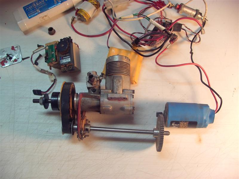

Just for giggles Engine OS Max .46F (not FX just F) onboard electric starter and generator its a home brew of someones as I pulled it from a 95 inch Telly. Total weight with the engine is 3.02 Pounds. Hmm A Telly's about the only thing that might fly with it on a cool day
I beleve it was Sullivan that has had a similar system for at least thirty years and I think it just dropped off the radar at Towers. Can't imagine why
John

These are two interesting Half A's and less. The one on the left is a K&B Stallion .049 with an enclosed flat spring recoil starter and the one on the right is the little .010 with the Famous Cox recoil spring and the one in front is the I believe is the most mass produced engine ever and I cannot recall the numbers but is the leader by far - the little Baby Bee .049 with the simplest mass produced recoil starter ever and they worked great, also preventing the engines from starting backwards which the reed valve Cox were famous for.
Sorry I don,t have any of the Wen Macs with their recoil spring starter.
John
