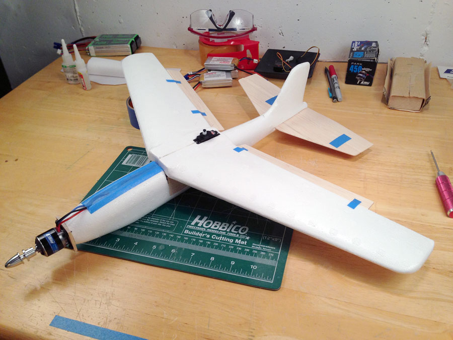

<span style="font-size: larger;">@teknicali</span><div></div><div>I'm not sure if you are still monitoring this forum/post but…</div><div></div><div>It's interesting that you should mention you are looking for a tutorial on how to create foamy fliers because that's exactly what I'm doing. I've done a few builds over the years using the foam gliders you find at an AC Moore or Michaels hobby store. I find it really enjoyable and think it's a great way to "get your learn on" so to speak.A focus of the tutorial is highlighting cost effective methods to build (using common materials like a hot glue gun and packing tape) in ways that don't require a huge amount of prior building experience. Plus, I'm using low cost reusable components you could put into another model in the future.</div><div></div><div>All that said, there's no guarantee that my method is the right method and this is just one persons approach. But that's the fun of building, right!? I'm also trying to make the tutorial generic enough that you could use it for most any foam glider build (small or large size).</div><div></div><div>I'll post a link to the build once it's mid-way…</div><div></div><div>Cheers!</div><div>_andrew</div>
"Converting one of those foam toy gliders to RC is a novelty project that one does for the fun of doing it, not for the end result of getting a good flying airplane." - jester_s1
@Jester

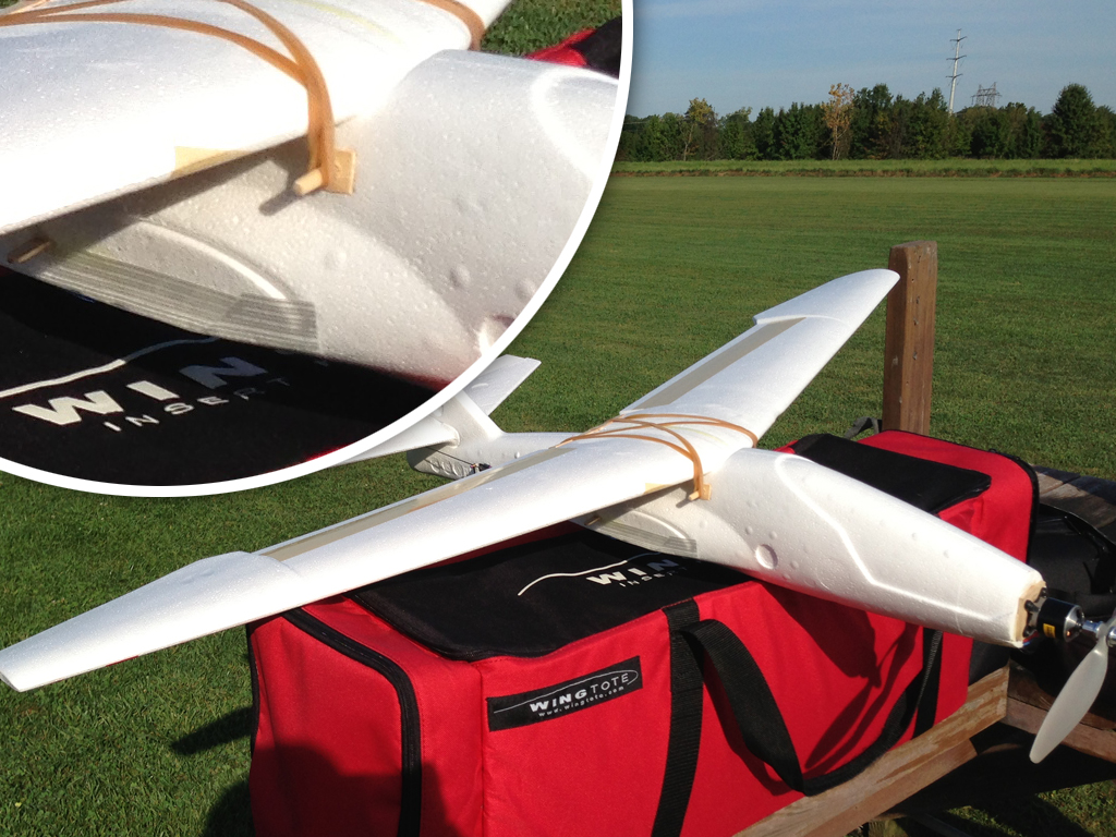

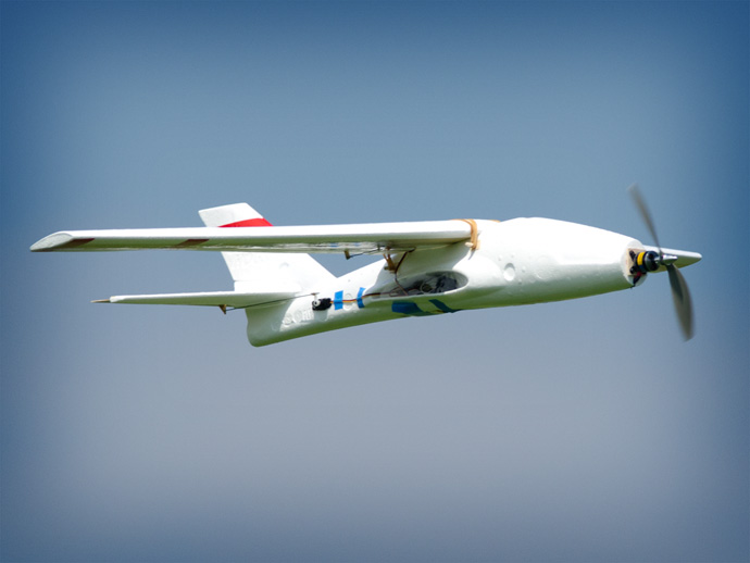

I'll refute that comment in good faith having just completed a very successful Air Hogs maiden this weekend. If done correctly, they are very stable and excellent flying machines. "Aerodynamics are aerodynamics", so my wife says (the pilot) and so long as you don't mess with what works, doing a foam build can be enjoyable and be a great learning experience. All that said, I do agree with you that one needs to be a proficient pilot in order to make one of these foam glider conversions a success. You can have the best plane but if you can't fly, well, .... you get my point.
I'm in the works to get an article published in the next few weeks which will document, in detail, the build and the process. The best part? All electronics aside (e.g., radio, battery, etc.) the parts for the build were approximately $20.
Please Note: The conversion I spoke to previously in this thread was a wonderful failure (above). I learned a lot, to say the least. The conversion/maiden I'm speaking to in this specific post (see attached image) was a success.
@Jester
