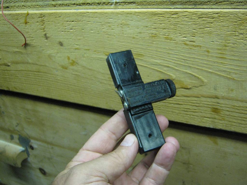

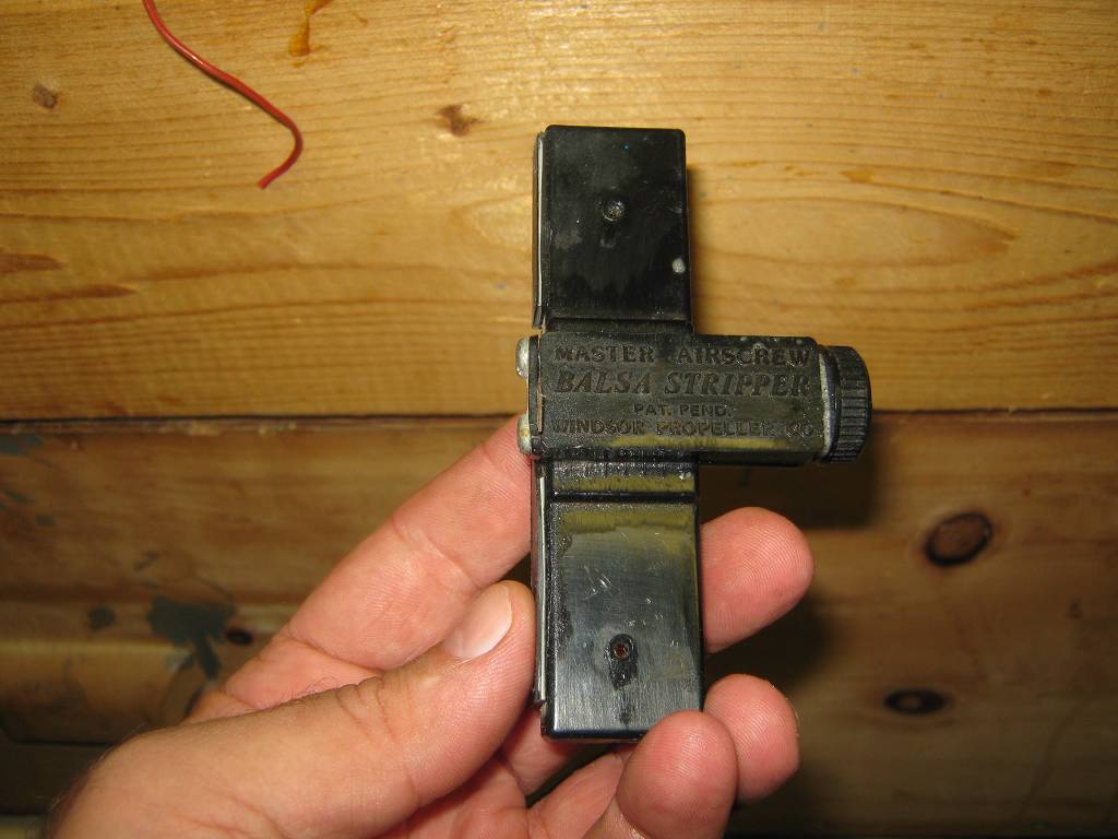

I wanted to share some pics of a tool I modified for cutting flat foamies. Its a Master Airscrew Balsa Stripper. What I did is adjust the blade so that it just barely goes past the depth of the foam, this way the blade doesn't get abused. Also the blade holder on the tool is perfectly square to the base. So, all of your edges you cut with this tool will be 90 degree angles without even trying ! this makes for VERY easy gluing joints when you start gluing the parts together.
If you look at the side face of the cutter (where the blade is) I have glued on two thin shims. One is in front of the blade, the other is behind the blade. This allows me to lay a ruler on the foam and cut perfectly straight lines without the blade hitting and flexing against the ruler. This thing has made cutting my own kits so much more efficient. I hope it helps you guys.
I think I will post this under its own heading as well so maybe others will see it.....

Your blade is not supposto stick down past the bottom of the stripper .. the Idea is to cut strips between the side where you have glued the strips and the knife ..The tip of the knife should be flush with the bottom of the stripper...

You are misunderstanding the tool I think ? You trace out your foam plane on your foam with a marker, then you trace/cut that line with this tool , it cuts squares edges just to the depth of your foam thickness, that way it doesn't dig deep in your cutting surface beneath.
it will really make cutting out foamies slick. Especially the straight edges since you can use a ruler with it.

No I am not misunderstanding the tool just misunderstanding how you are using it... I see what you are doing with it now...Not a bad Idea...I use my stripper to make strips like cap strips all the time so I am quite familiar with how it works...It is a great little tool .. There are many tools that are almost useless but I find the stripper very handy...I have had mine for close to 30 yrs...

Yes I have one for cutting balsa strips as well, I just re-engineered this one for making nice 90 degree cuts, It works great.
