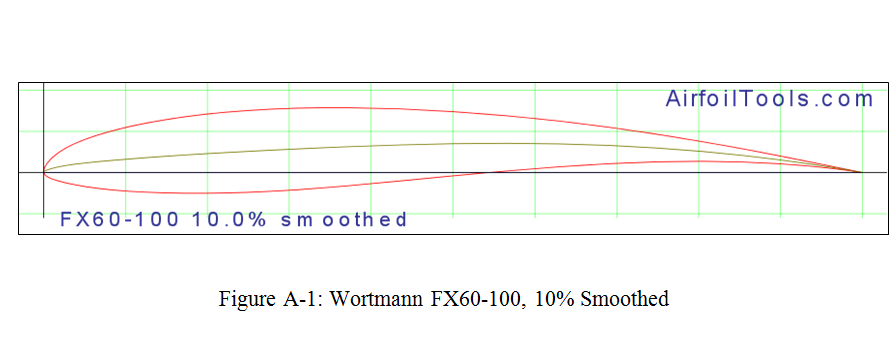

Are you limited on wing span? Why such a small wing? Without doing any calculations I would increase span by at least 50% and cord by about 25% just as a rough target. Not enough wing area.
I would also modify the tail so that you return about 50% of the elevator back to the fixed h-stab. Too much elevator surface. It is not that you can't have all that elevator but you don't need it. You can have a full flying stab if you like.

Your issue isn't lateral stability. Your issue is tip stalling the wings in a turn. The plane will probably fly ok in a straight line, but as soon as you pull on the elevator to make a turn it's going to sideslip or tip stall (actually quite similar things) and go into a spin. It was hard to see what kind of airfoil you used, but if it's fairly thin and sharp up front that's going to aggravate the issue. Sharp leading edges stall suddenly with little chance of recovery, while blunt LE's ease into a stall more slowly giving the pilot time to react. This could be good experience for you though, since this flight shows you how a heavily loaded plane flies. You'll probably be up around 35 ounces/sq ft in the competition, so learning not to do those hard bank and yank turns will be vital to having successful flights. You need big smooth turns when you're loaded heavily to keep the wing flying.

Jester, I would like to learn more about tip stalling. If you know of any articles, can you point me in the right direction?
As for the airfoil, it wasn't very sharp in the front but it was a high lift (wortmann FX60-100).

+1 you could very likely double the size of the wing, and 1/2 inch of dihedral wouldn't hurt either.
http://www.homebuiltairplanes.com/fo...cs-causes.html
a very small amount of washout would likely help lessen the tip stalling issues too.

Unable to access video of your first flight, but the wing in your last one (in addition to being small) looks very flat. Your stability might be improved with a little more dihedral in your new wing.

That airfoil is fairly sharp up front. Have a look at the clark Y airfoil to get an idea of what a gentle stalling wing looks like. I'm not much of an aerodynamics guy, but from practical experience that airfoil looks like it needs to go pretty fast to be efficient. You might consider switching to something that performs well at slower speeds given the parameters of your design.
All a tip stall is is when the tip of the wing stalls but the root does not. Some planforms are more prone to it than others, but all wings can do it. A tip stall results in the quick dropping of one wingtip (like in your video) and no response from the ailerons. Your pilot kept trying to correct the weird roll he was seeing but the plane either didn't respond at all or actually got worse, right? That's normal behavior for a tip stall.
Your tip stalls are happening because of a combination of conditions. First, you have too much wing loading to begin with, making the wing fly at a high angle of attack. So the wing is already close to its stall angle just in straight flight. Second, your pilot is doing those bank and yank turns which increases the wing loading even more and then encourages the wing to sideslip, which makes the inboard wing tip stall. The result is the beginning of a spin, which your pilot apparently doesn't know how to recover from.
For future use, the right way to recover from any stall is to point the nose toward the ground and gun the throttle. This is counter-intuitive since the plane is losing altitude, but it has to be done if there is to be any chance of saving the plane. Overpowered planes can just throttle out of a stall, but you don't have an overpowered plane. Tip stalls require a second bit of maneuvering and that is to rudder the plane in the opposite direction of the unwanted roll. DO NOT TRY TO ROLL OUT OF A TIP STALL OR A SPIN WITH THE AILERONS! It will just make the stall stronger and take away any chance of recovery as happened in the death spiral I saw at the end of your video.
