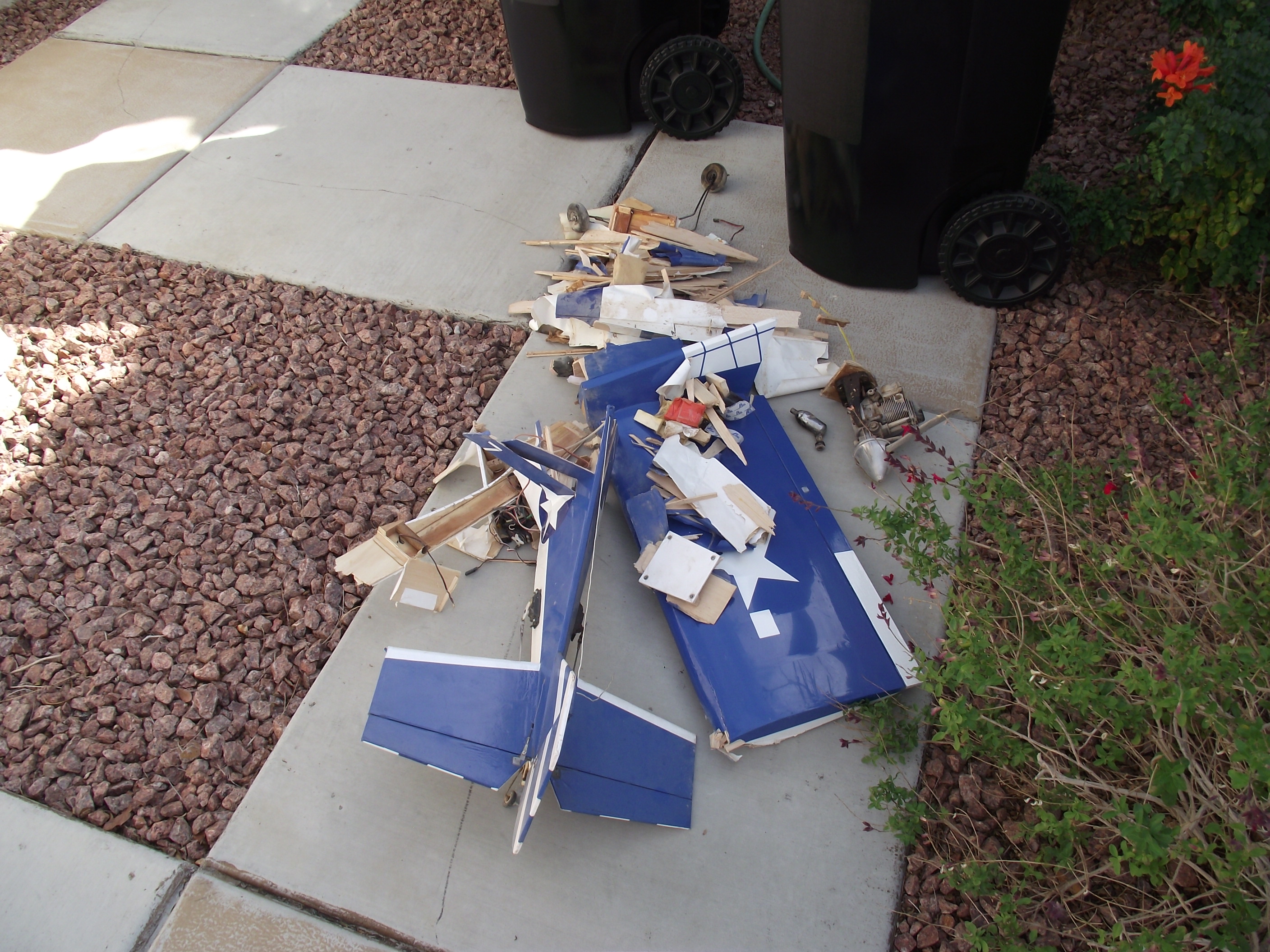

Tony, notice the stabs are all still there. I see Zor talking about building for a crash and I always question that. When I dump one there is no glue ever made that is of any help at all. I fly with both 2.4 and 72. This is my Hots with a YS 110. That dumb ass married to my wife forgot to pull out the antenna!!! The plane was built with both CA and epoxy. I don't care how heavy or light you build them, nothing will help in a crash.
