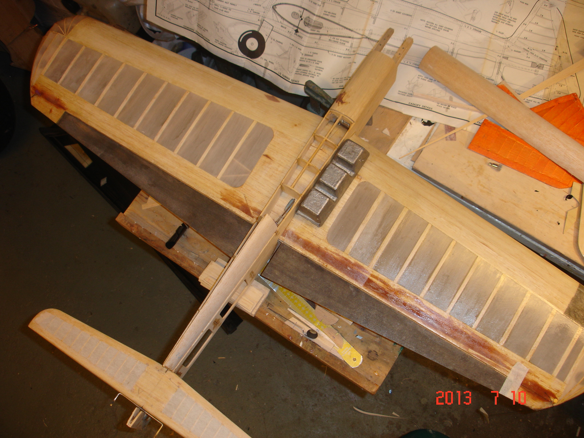

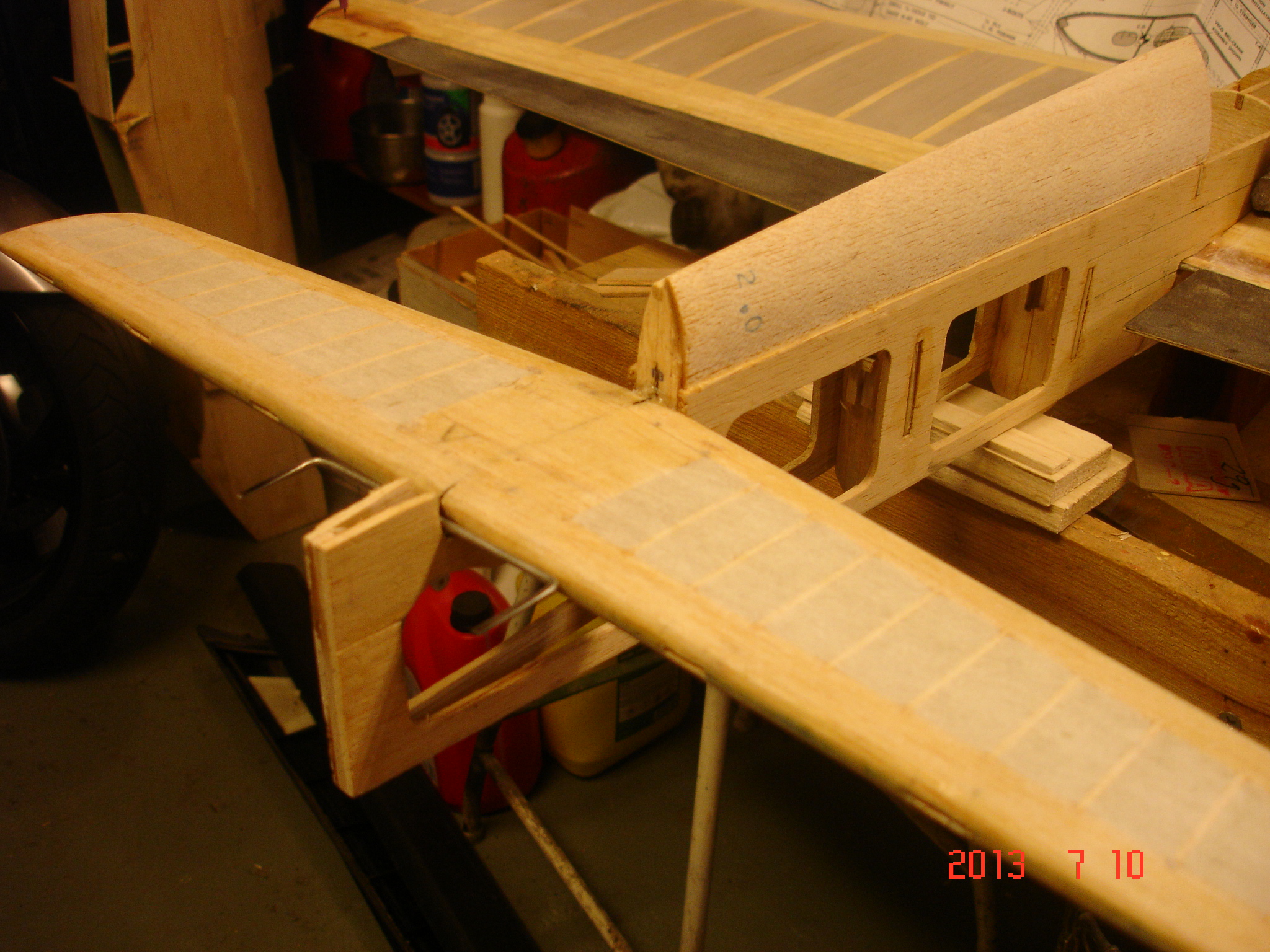

Hi!
I use Ca and kicker on all my planes, pylonracers as well as sport and scale.

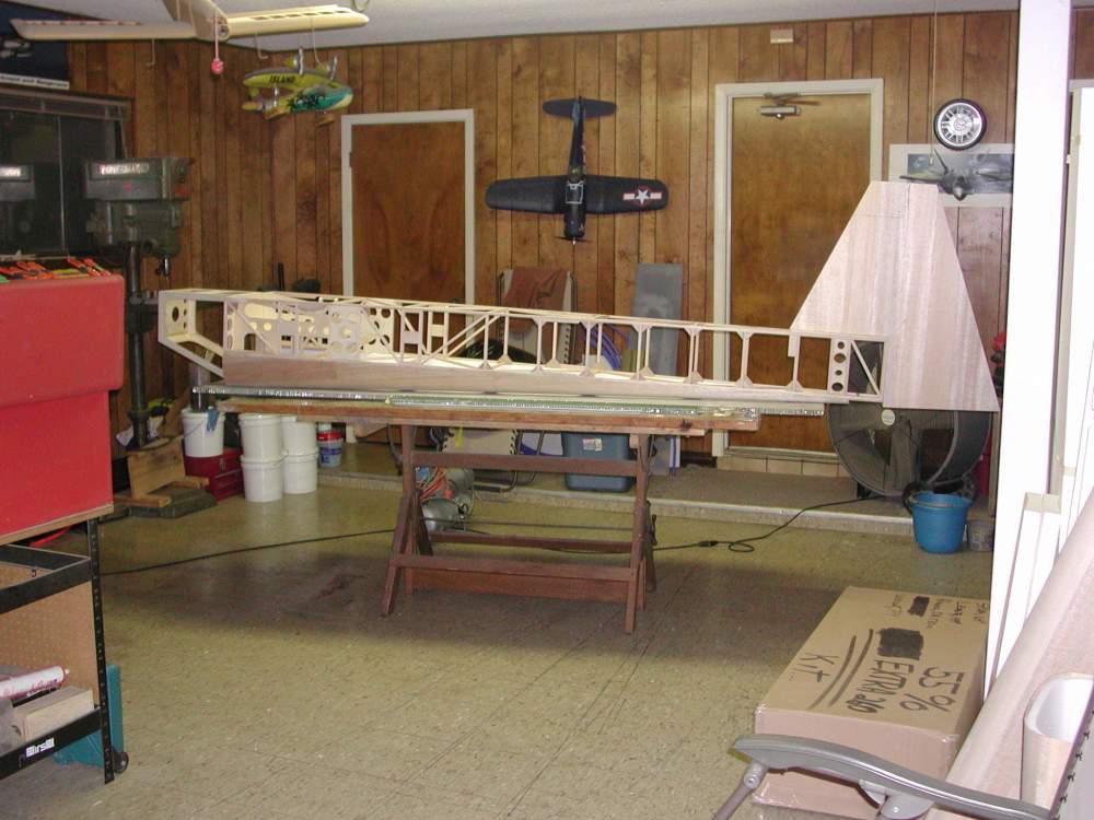

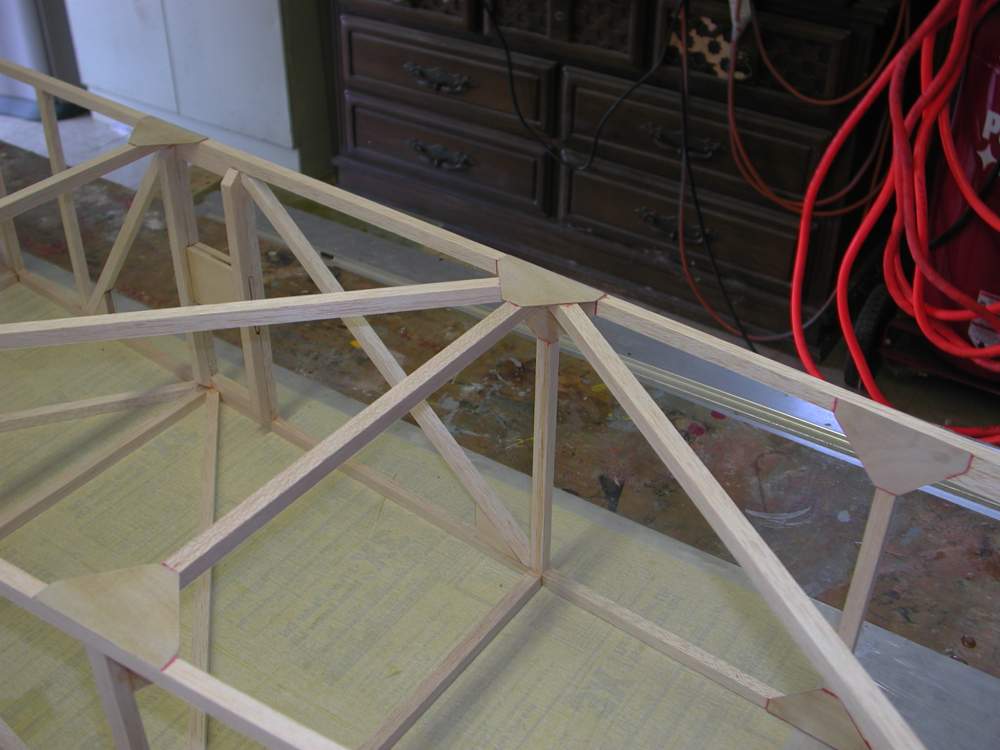

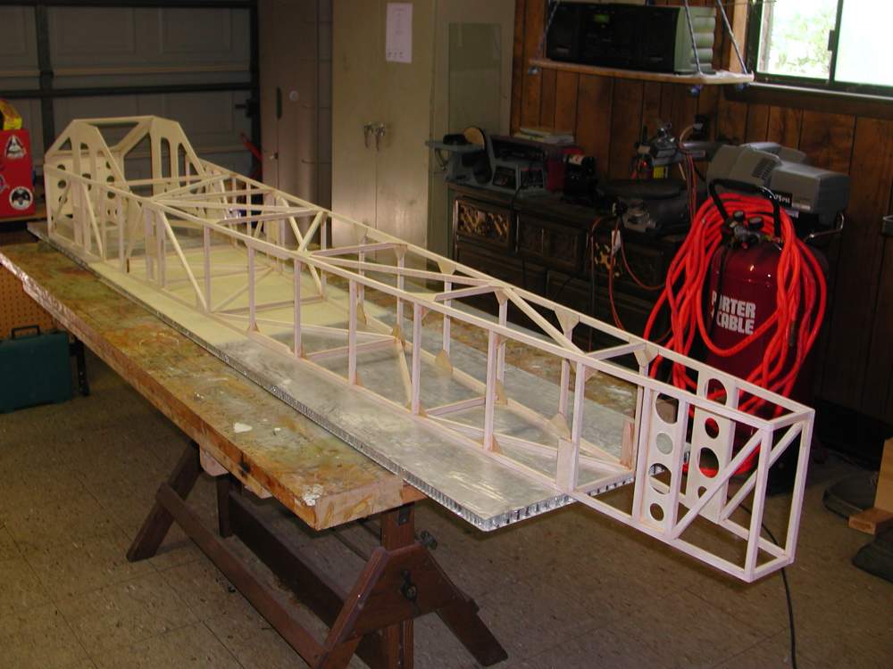

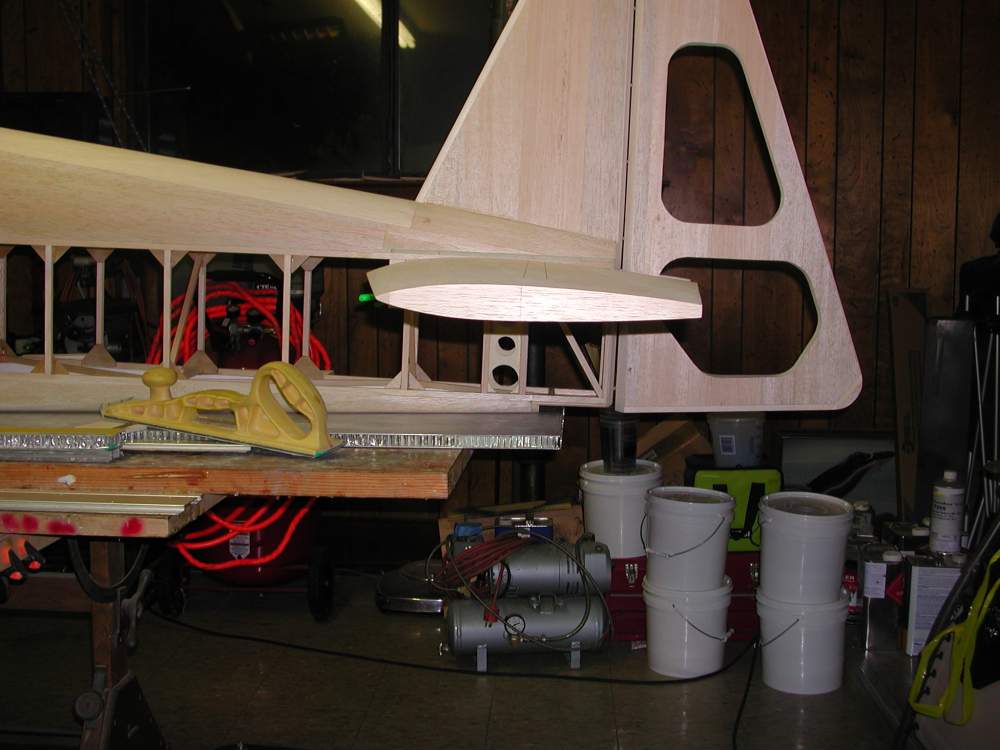

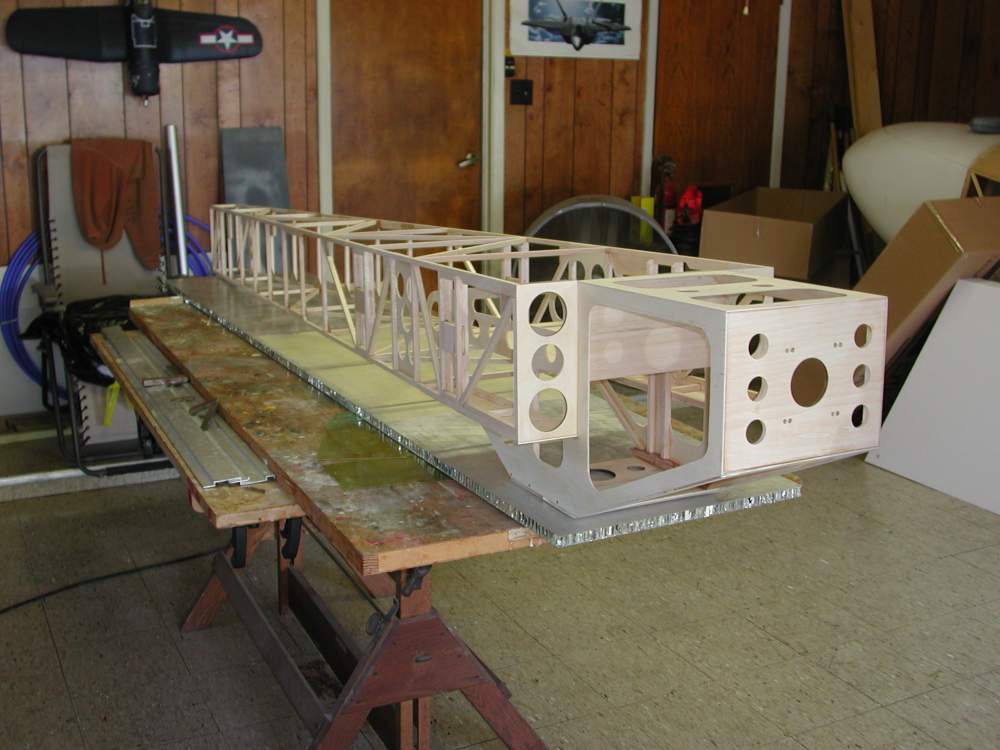

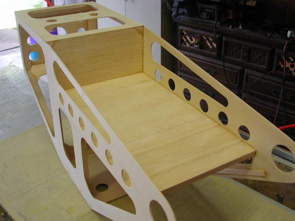

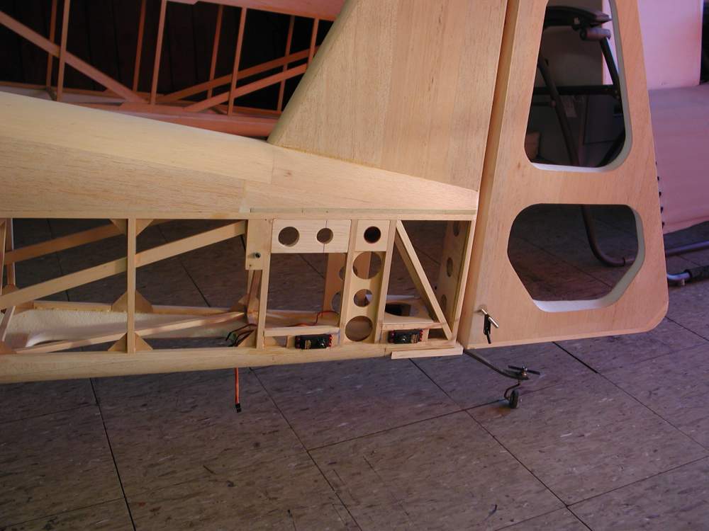

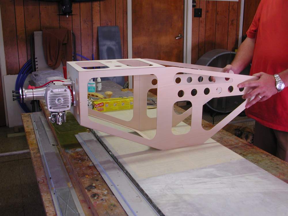

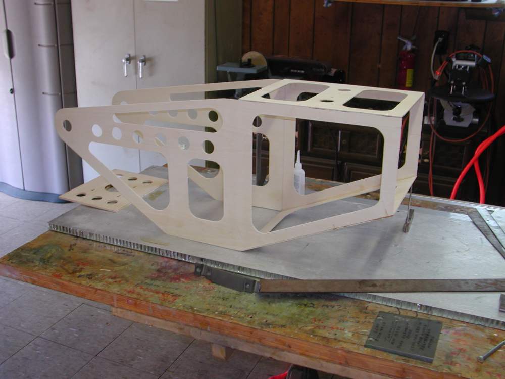

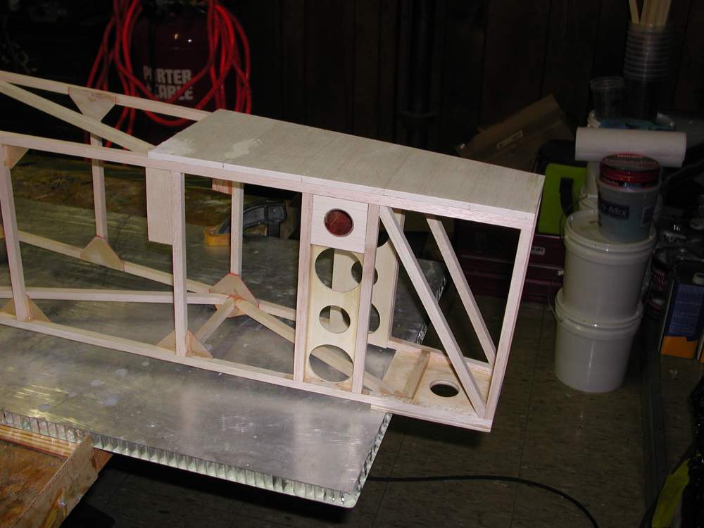

I guess I am one of the lucky ones that has good luck with CA as my assembly glue of choice on fuselages, engine boxes, and landing gear assemblies, Been doing it this way over 20 years now and never had a glue joint itself fail yet. I have had structural wood failures at times, especially during testing but proper CA bond lines have never given up the ship. Just one guys experience...
Bob

I'm with you sensei for the most part. I do, however, always use epoxy on the firewall joints since glow fuel attacks CA. Otherwise, it's mostly CA and I have never had a problem with it on hardwoods, neither plywood nor basswood spars. However, as I said before I will use epoxy on tail surfaces where shear stress is an issue.
