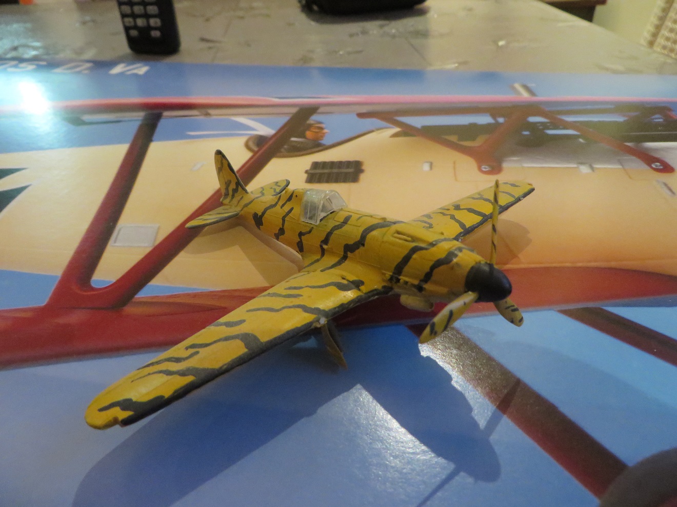

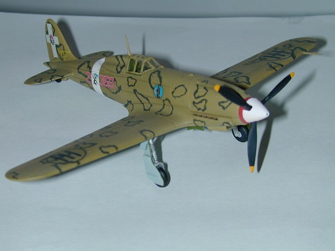

Default My 1/72 Italian models; maybe Folgore 202
I think these are Folgore 202. The one on the left is my son's he built he when he was 8. The one on the right I built.
I should have recognized that plane I think!!!
