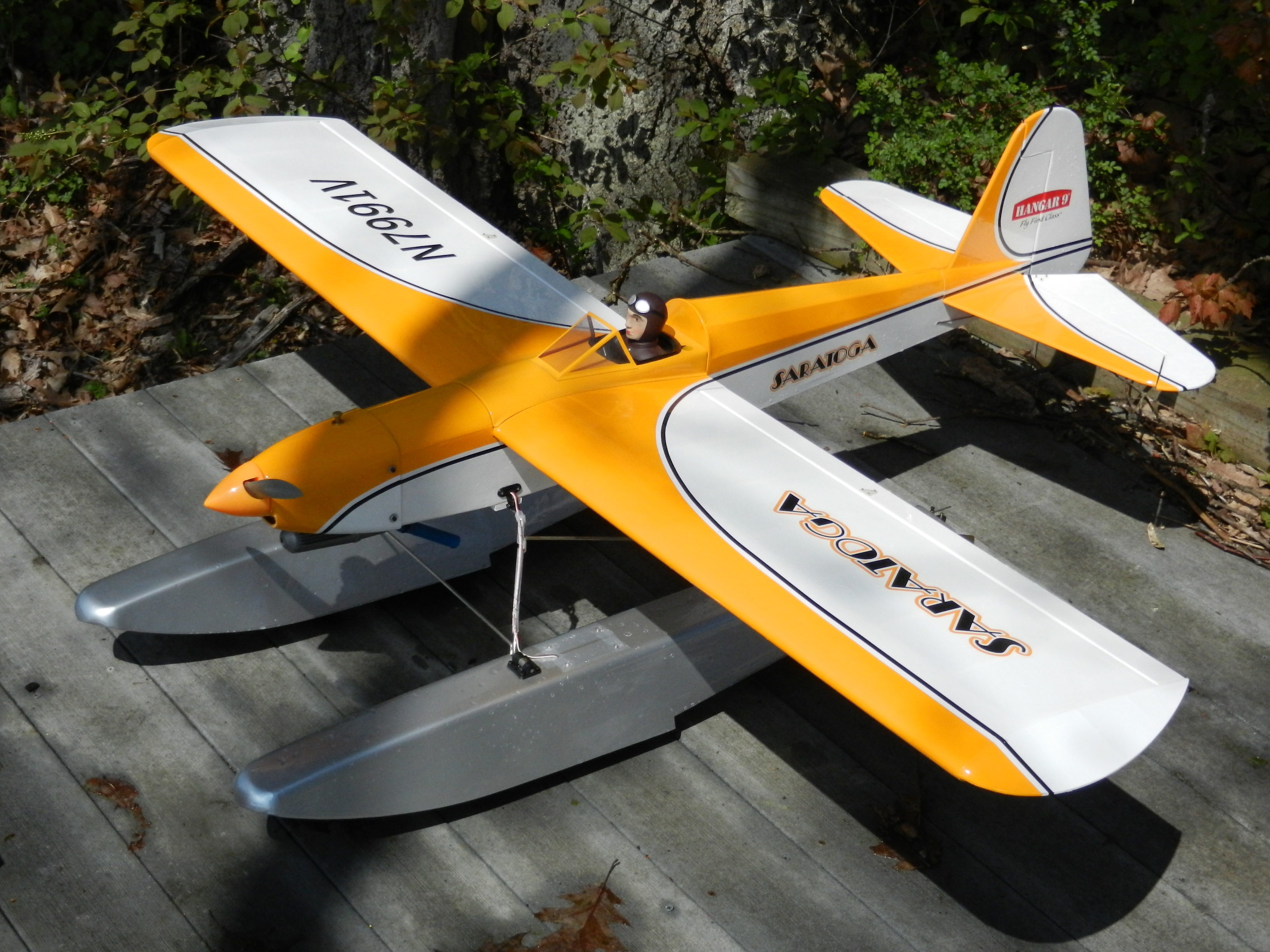

Like a Maxford Mentor-G with 4-1/2" balloon tires. I upgraded to carbon fiber struts with the Big Wheel tires and it is far and away my favorite "bush" plane. The wing is about 14" off the ground.
Tail draggers do better in grass (IMHO) and you HAVE to have free-spinning wheels without spats. A few degrees toe-in better still.

The Pulse is a great flier. I have a similar Saratoga 40 (now discontinued) and a friend has a Pulse. Both make outstanding float planes (with the Hanger 9 Cub floats)
