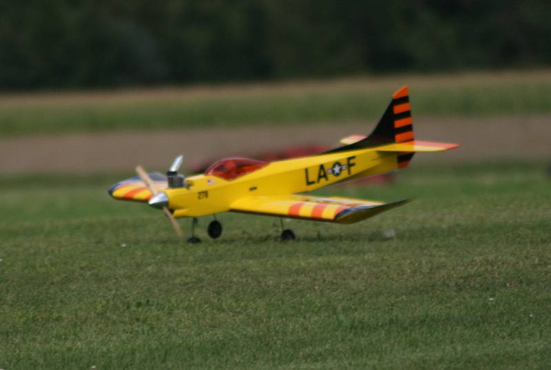

By the way - I don't think it's possible to tip stall an Avistar. It's a flat bottomed constant chord wing with wash-out built in. It will always root stall before a tip stall. Stall - yes. But never a tip stall.
I would agree. I only said tip stall as the LH wing dipped hard right at take off so that's what it looked like but having never experienced one I really wasn't sure. But I guess on a constant cord wing a tip stall isn't really possible. I'm leaning towards the root cause of the accident was from multiple reasons that compounded to cause the stall. First was the fact the grass on the runway was probably a bit too long for the little 40 sized Avistar. Another would be the prop size, and age of the prop. It had some pretty heavy build up of grass on it that could easily make it less efficient. Lastly, as I was removing the wire landing gear to convert to a tail dragger I noticed the LH wheel was extremely hard to roll. It wasn't completely locked up but pretty dang close. I never really noticed it but lesson learned to check main wheels before I take it down the runway. That had to have added to the take off roll as well.
That said the Avistar is a semi-sym wing is it not?

Yes, it's a semi symmetrical wing. Constant chord wings can tip stall though. The airfoil design is a factor, as is the wing loading. I tip stalled my Cub a few months ago on a bad takeoff. It's constant chord too, but was loaded a bit heavy with scale detailing.

Full scale Cubs have washout but this gets neglected in a lot of Cub models.
How can the LH wing dip hard RIGHT? I assume you meant left. In the original post you mentioned possibly catching some grass with the LG or wing tip. Sounds like it's hard to know what actually happened, except that you need better acceleration on your take-off run, which would suggest a lower pitch prop.

I had a bit of bad grammar when I wrote this thread. The LH wing dipped hard, right after takeoff I was a bit too far to the left side of the runway and as soon as the craft broke ground it immediately dipped left and didn't take long to get into the weeds. It looked like the wing and landing gear hit the weeds pretty much simultaneously. After that point there was no saving it and the cartwheel ensued.

When taking off with minimal airspeed and full power you will need right rudder to avoid the left wing drop. Call it torque, P-factor, or tip stall, the results and the remedy are the same. Rudder to correct the wing drop will be most effective and least likely to make it worse. Taking off at very low speed with full power with that plane is very doable if you use that rudder to keep it straight, and let it gain speed before exiting ground effect.

Regardless of airfoil, any airplane can be "tip-stalled" if conditions and situations set up, said conditions - situations which are mostly set up by the pilot. If you have a chance go to an airport and especially so take a look at air-transport airplanes from a good distance behind the machine. You will see that the wing next to the fuselage has a strong setting almost like a Clark-Y. The trailing edge can be noted that it becomes very close, if not actually, a symmetrical airfoil out by the tips. Therein you see the washout that real airplanes live by.
A flat bottom wing is a sucker for tip stall when the pilot moves the ailerons. That aileron going down is a sure bet if the speed is still slow and the angle of attack is high (taking off, landing and slow, etc.) A few months ago I was helping a modeler. He had flown some years ago. We were working with an Avistar Elite. He kept having problems with turns, especially to the left. I asked him if I could make some adjustment. I rolled up the ailerons by about 4 degrees. No more problems. Smooth turns, landings were straight approaches and take-offs straight. In-flight maneuvers were smooth. The old times came right back. Was it the adjustments? I have saved a number of Big Scale Pilots with that simple little thing, washout of the ailerons. Strip ailerons, then cut the tips off a few inches and GLUE them back slightly up. Be sure to slip another hinge (any type) into the end of the working aileron. Good luck. I am not an aeronautical engineer. My son is. OTOH some 41 years, military and airline with 20,000+/- hours, I did learn a few things. The fun of checking man-carrying machines gave one a good chance to learn more for modeling.
