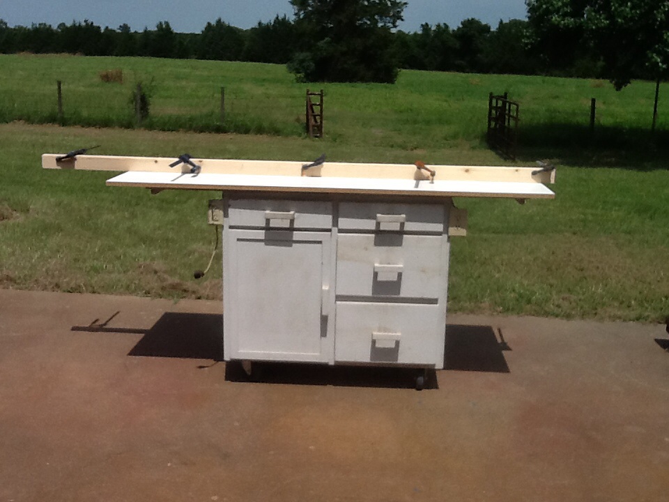

Ok I am going to see if I can post a picture. I got my old cabinet from the airport and brought it home. This was to be kitchen cabinet but it came out 1/8" out of square so I built another. I kept this one for my hangar. I checked the top and it was almost one string width too high in the center of the long span. The cross span was flat. I shimmed the right side and added three screws to the center. It is now as flat as I can get it. I checked it with a 5' scale, 1"square aluminum tube and finally a 1.75" square steel tube. You cannot slide a sheet of paper under any of these instruments.
So I cut my sheet of melamine 30x77". This sheet weighed a ton, I struggled to get it ready for cutting. I, then, placed the cut sheet on the cabinet top and remeasured. Again, flat as a pancake. My question is can I get away with leaving it as is, just tied down on the perimeter? I had intended to use the 1x lumber to build a frame for the melamine and have it adjustable for flat as jester mentioned. I could build this plane and do the frame later. Or is it best to do it now?
The drawers have come in handy as I am starting to gather building tools. The shelves behind the door will hold some balsa stock. I may cut some foam to protect some from the heat. I have a good supply of old lawn mower blades 1/4" thick. I am cutting them and use them as weights. Should prove to be good. Right now I am using pieces of railroad track that I have.
BTW, somewhere in the back pasture will be a test pilot grass runway. There I will crash uh uh I mean fly my plane.

I feel for ya brother. I dropped a sheet of that on my foot a couple months ago at Home Depot and thought I was going to pass out. Luckily, it just landed on my toes, not up on the bones of my foot or I know it would have smashed my foot to smithereens.
Bench looks good. Only thing *I* would do different is go with a metal electrical box screwed into the bench. Those plastic ones have too much flex for me when I plug stuff in and out. Nice bench though!
Well gang, I got up this morning thinking about that board and decided to just go ahead and frame it. The frame is screwed in place and it would be simple to make any future adjustments. Final height is 40" but I can reposition the wheels and lower it 3 inches if needed. It is flat as flat can be. Now I can move on to building. Probably more questions to follow later.
Thanks to all for the tips and suggestions.
