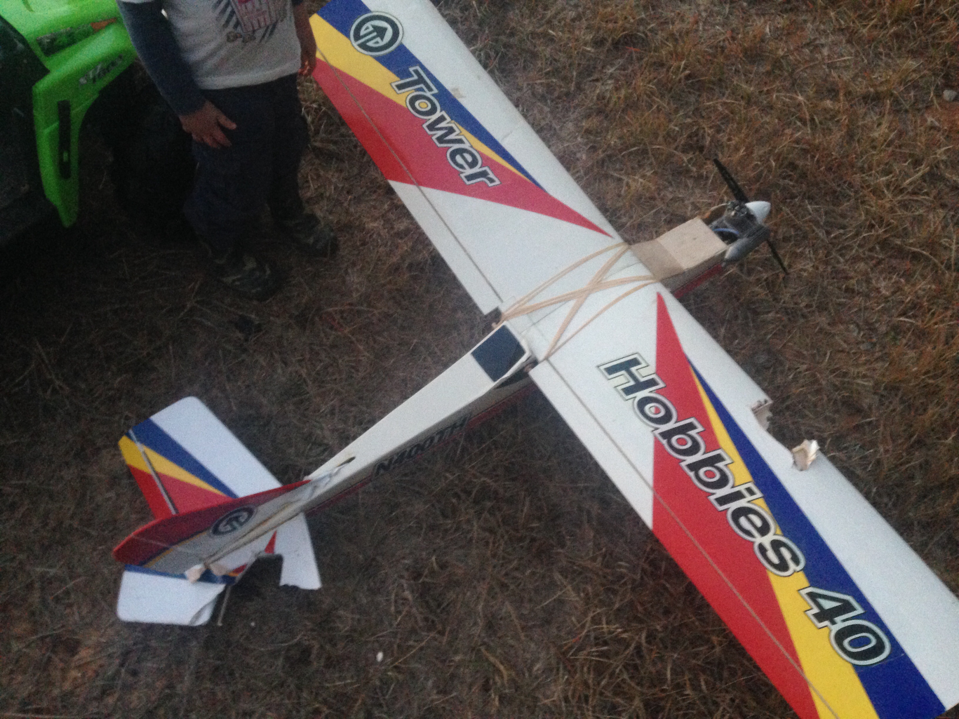

So I've been having some issues getting my tower hobbies .40 engine tuned properly...seems like it will be too rich one day and too lean the next....so I'm working with it today and finally feel like I'm making progress. I take my trainer up for some quick flights to put the engine through it's paces. All I'm doing is touch and goes at my house. About ten acres clear cut with a pond. Totally safe. About my 10-15 minutes into the flight the engine dies. Nothing I'm not used to as this seems to happen all the time. At the time the engine died I had a fair amount of altitude...couple hundred feet. So I'm sorta spiraling down trying to bleed off that energy when WHAM!!! Hit a tree on the wood line. I thought The plane was much closer to me than it actually was. Lesson??? Fly at an AMA sanctioned airfield, avoid trees at all cost. This was my second run in with a tree. The tail section was intact in the tree...only minor wing damage. But when the plane came crashing down out of the tree it landed tail first and crushed the horizontal and vertical stabs. :-(
I haven't looked at it carefully but I think it's salvageable. What do y'all think? I'm actually kinda excited about repairing it. Is that bad???

By all means, go ahead and repair it ! Repairs like this are all a part of the learning process. From what I can see I might buy a replacement horz. stab, and do a leading edge repair on the right wing. If you did rebuild the right half of the horz. stab on the plane you should install a tail wire kit on it for strength. Better to cut the horz. stab out and scratch build a complete new one, or just buy a replacement from Tower. Have fun
Old 01-18-2015 | 04:18 AM
skylark-flier's Avatar
Posts: 2,226
Received 15 Likes on 13 Posts
From: VA, Luray

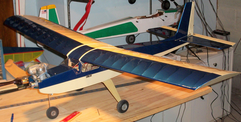

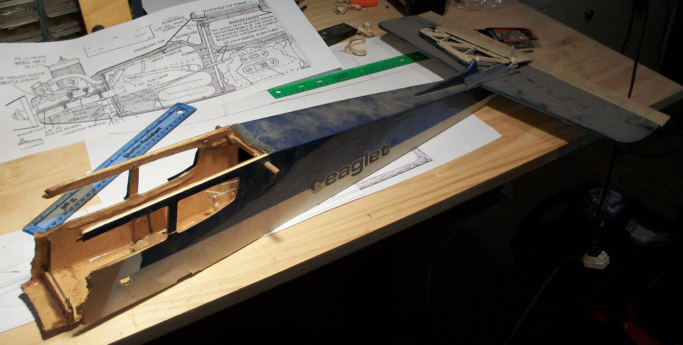

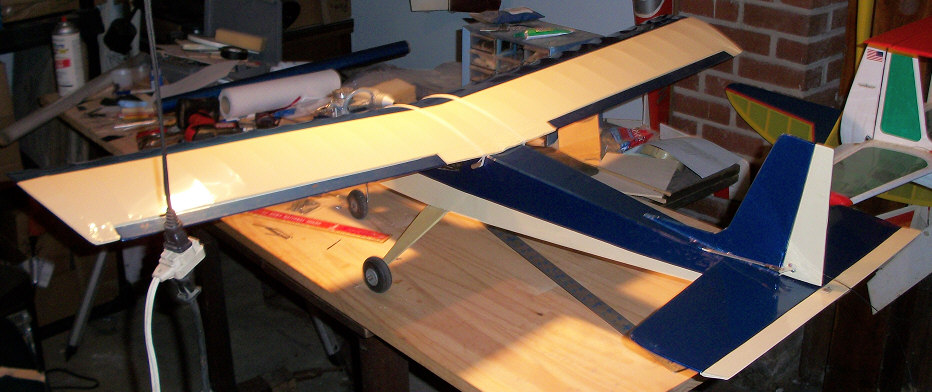

Absolutely, it's repairable!!!! If I (an old man with 6 thumbs) can start with this and get to this inside a month, ANYONE can.
This, BTW, is an old CG Eaglet that did a figure-9 onto an asphalt highway a long time ago. IF I ever find a single part for the old ST .29 engine, it'll go back on it but for now she'll fly with a OS .20

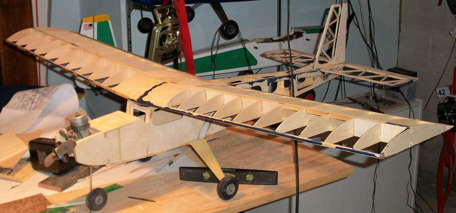

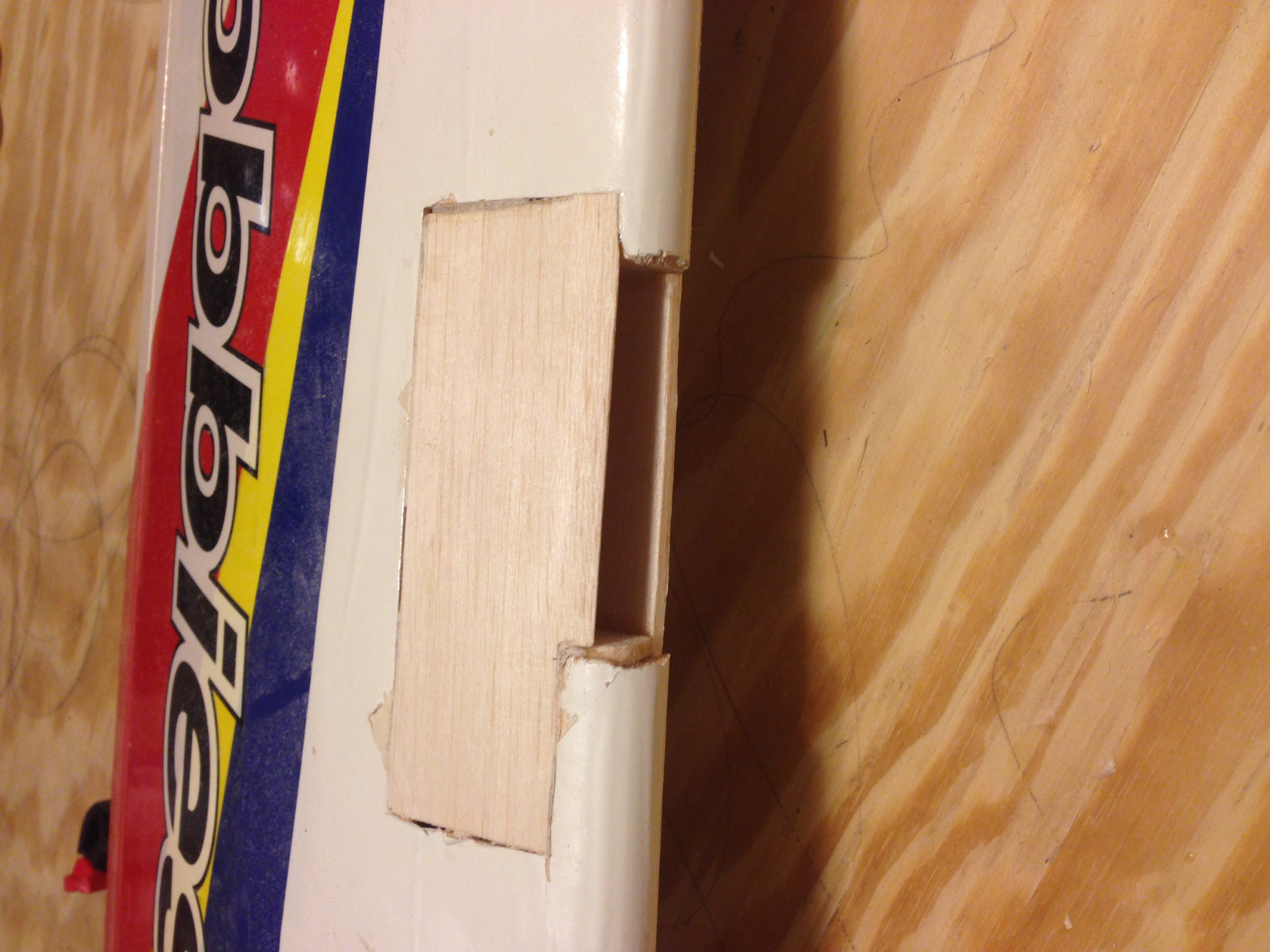

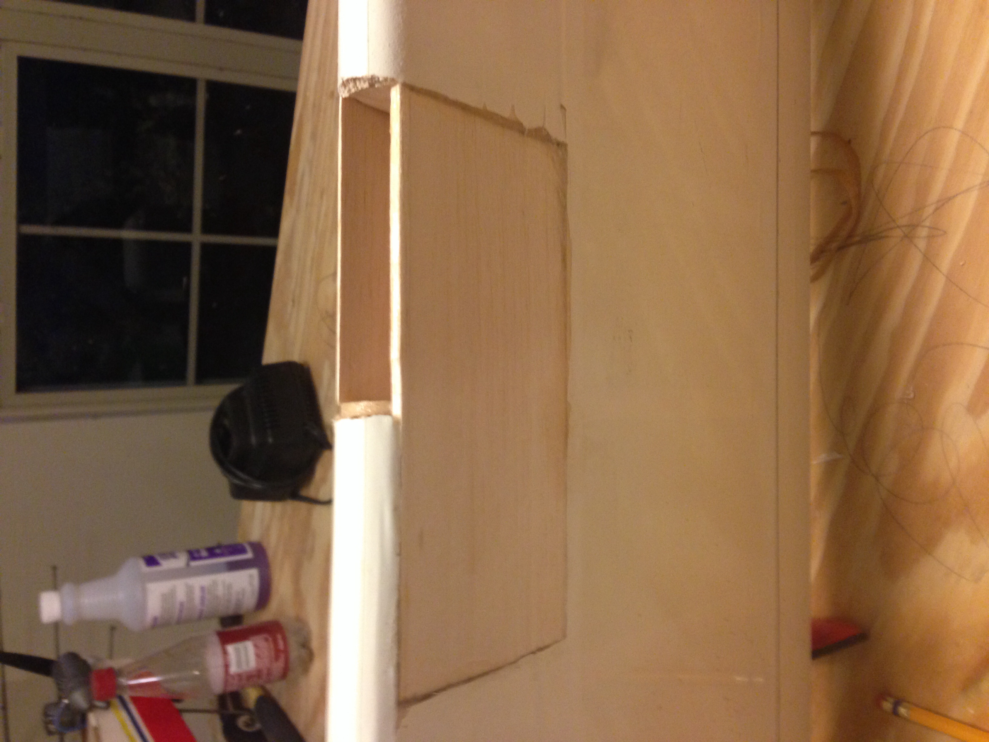

So not to make this a repair thread.....but here is the progress so far. I just put my Billy Joel on and tinker away. I don't know why but it's the most relaxing thing I can think of to do. It's like everything else going on in this world melts away and it's just me the airplane. It's really one of the most enjoyable things about this hobby for me.
I was was wondering how you guys recommend repairing the LE? I was thinking spray foam and tape unless I can find actual LE shaped sticks.

Just scarf cut the LE, {a sideways cut} and scarf cut a new piece of balsa and glue in the new piece of wood. I would have glued in a half rib behind the repair but the sheeting will hold it. Sand to shape and recover the repair. Trainers are made to have patch work.

Mlw316, looks like you have a good repair started there. On the wing LE, do as Gray Beard says and fabricate a new balsa leading edge piece and splice it in. Scrap the foam and tape idea ! I would put an overlapping splint backup piece of balsa behind the LE at the outermost joint and maybe a small triangular gusset where it is spliced at the rib. Gray Beard's suggestion of a half rib at the outer splice area is good. All that will make that area of the wing plenty strong (but not strong enough to crash into trees again). Cutting out the old tail feathers is the right way to go. Are you going with replacement ARF parts from Tower? With new replacement tail feathers and a little neatly done white covering on the wing LE it will be hard to tell it was ever damaged. Be sure to get the horz. stab glued in parallel to the wing and the vert. stab at 90 degrees from the horz. stab. Get this right and it will not only look like new but it will fly like new too. Take your time and enjoy.

Yup, 100% with Larry and Gray Beard. Press on, you're doing OK.

Funny that you should say that - I just now finished (for all practical purposes) rebuilding that old CG Eaglet (post #3). Still have the side markings to recreate (I handcut it out of monokote) and I need a spinner eventually, but the plane is ready for the maiden. That'll happen as soon as this little snow storm goes away and it warms up a bit again.
I agree with you on that stab - wouldn't take more than a few hours to have it (or a new one) ready to go.
