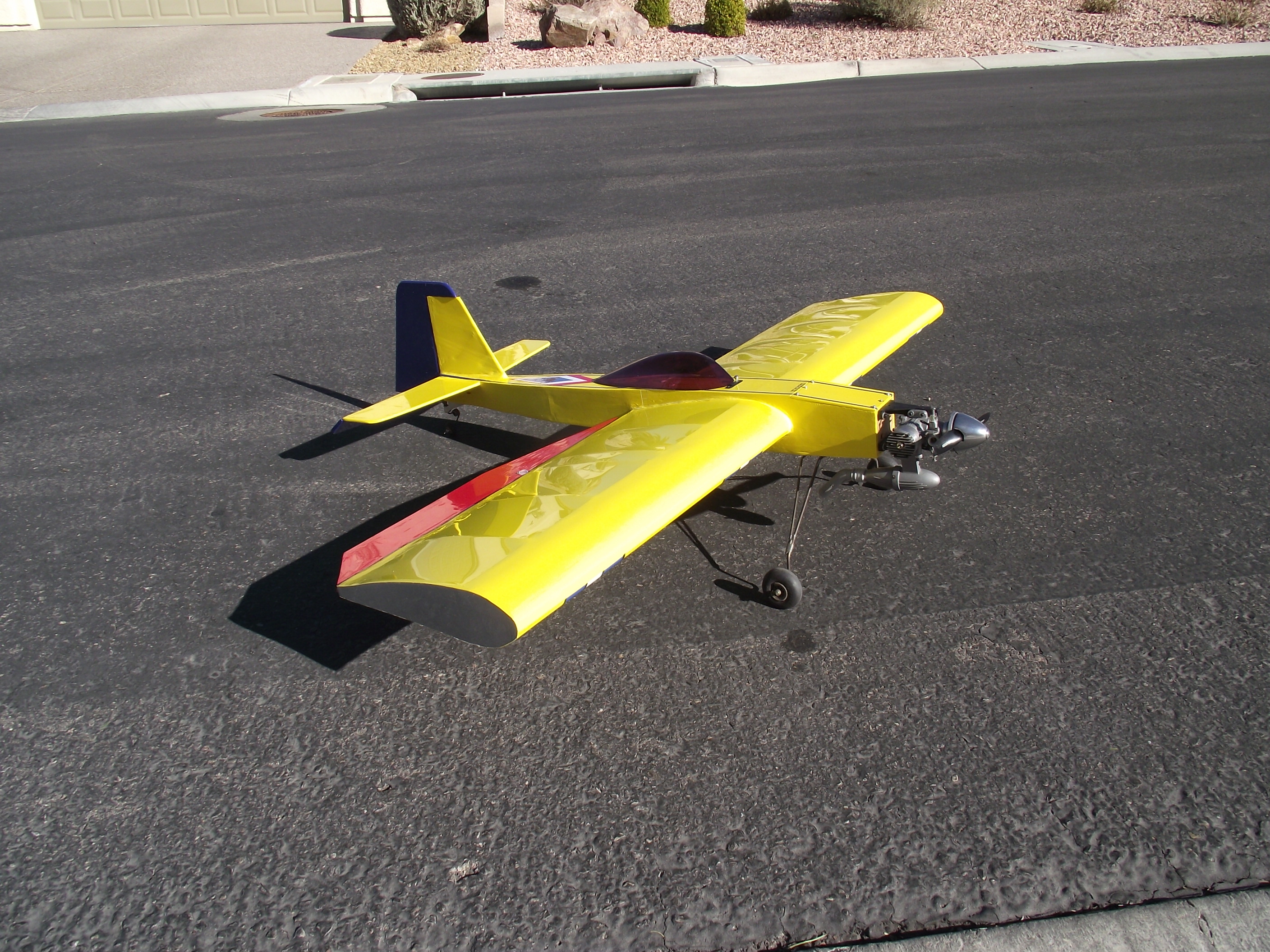

I just completed the Krafty 60 I have had stored in the attic. Its unflown so far. I put an OS SF46 I got off ebay NIB on it. I gassed it up. Put in a squirt of prime and flipped the prop. It started on the first flip. You gotta love OS engines. Here are some bad pics of the plane. Its dark and rainy here so I took them in the garage. If the sun ever comes out will get better photos.

I would think you would be busy still, a few weeks ago Rick sent us photos of the hail that hit his area. They were the size of a hard ball!! I thought I saw big hail in Missouri but I have never seen it that big!!! Heard of it and seen it on the news but never seen it myself. Hail that big would kill someone if it hit them in the head!! Scary!!!
I like the red and white, classy looking with the old school design.

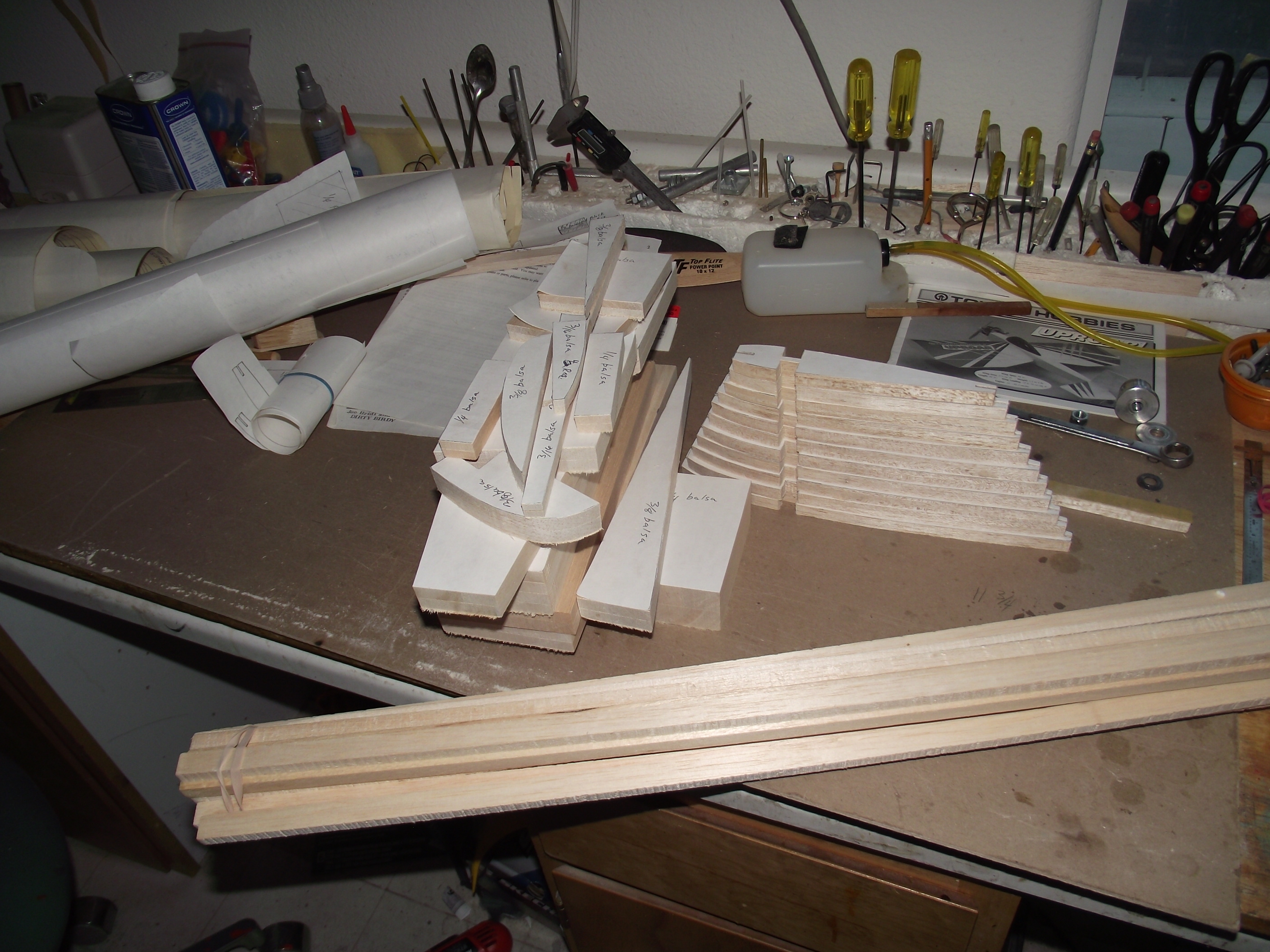

Where are you getting blocks of balsa wood? And how are you cutting it to keep it precise on the thickness? Do you position your would so you can get A,B and C cuts from the wood?

Because I'm a plans builder I order my wood in bulk for wood suppliers like National Balsa. To get the blocks I need I have often had to buy from other places but I like National. The blocks come in different sizes but I like them in 4X4X36 inch. I have posted photos several times of our wood working club but I either use a big recut saw, ZONA I think or I use the band saw with a fine tooth blade. The trick is to make sure the blade, fence and table are all squared. For something like 1/16 sheeting I cut it over size then run it through the over head micro sander to get all the sheets evenly sanded to 1/16.
Sticks are easy, if I want 3/8X 1/4 I can rip a sheet to either size then set the saw to the next size and rip it into the stick size.
All my kit parts are gang cut. This Birdi has a tapered wing so it needs two wing ribs each of different sizes, because I'm cutting two kits I need 4 of each. I use a spray mount glue and just glue 4 sheets of wood together then glue the templates on top then cut the ribs out proud then sand to final size. I use a heat gun to warm them up and loosen the glue so I can separate the ribs.
A buddy gave me a big box of balsa blocks that were 2x8X18 that were used as packaging for a tool sent to his wood working club and I have used that in my last two builds. Before that I had several of the store bought long blocks but I ran out of that.
The Bridi Dirty Birdi will be my summer build. I do most my building when it's hot. The Vegas area heats up by about 10 or 11am so it's either hanging around the pool or being in my shop building. Sometimes I get back from the pool and just head right into the shop. Our flying starts at sunrise and we are packed up and gone about 10 or 11. Often we go to a nice casino and as a group have brunch. During the week all the casinos have those cheap meal specials. We fly all year round, only the wind grounds us. And we aren't talking the little weenie winds like most places. It can start out calm as can be in the morning and like magic come up, right after I take off and go from 30mph to 60mph in the blink of an eye. The last three weeks the wind has been up, not a steady high wind but about 30mph then gusts will come up that move my BBQ and patio furniture around so I haven't been flying.
The friend I'm cutting the other kit for is a couple hours away in Calif. and couldn't change the oil in his truck yesterday because the wind is so strong the oil coming out of the pan gets blown across his driveway. That's being grounded by the wind.
You can look in my gallery at a few of the planes I have built, this little Up-Roar is either in a build thread or Ricks Up-Roar thread? I don't recall if I did it as a thread or in his? The other photo is the kits I'm still cutting but that is two kits being done with the parts and templates still glued on.The Roar kit is still cut and sold through Tower but mine came in under 3.5 pounds fully loaded just by wood selection. It will float around but really gets with the program when I want it to.

I remembered you had mentioned the saw before but couldn't remember what it was called. I don't scratch build enough anymore to merit cutting my own wood. I asked about the cuts in your wood because a model airplane book I have talks about different ways to cut a balsa log and each cut has an effect about the strength and flexabily of the wood sheet and where it should be used. I was very disappointed with the last box of wood I ordered from Lone Star Balsa. It was heavy and cut so that the sheets were brittle and would not wrap around the leading edge of a wing.
I cut my ribs about like what you describe. Except I glue the pattern to one rib blank with contact cement and stack up to about 9 blanks under it and use T pins to hold them together.
