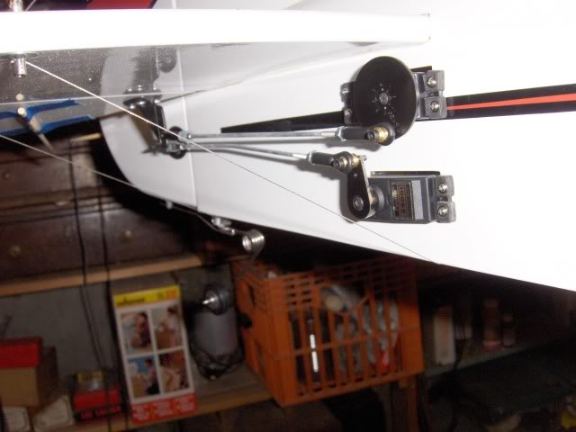

I don't see where World Models specifies a torque value for the required servos. In a model that size I'd definitely like a Heavy Duty servo on the rudder (because of the added strain from ground handling the tail wheel) . The 645MGs are great for that application and are my go-to servo for gas models.
The photo is an 80" Giant Super Sportster - similar in weight to your Spit - with dual S9001 elevator servos on a 6v system with short, heavy, zero-slop ball link rods.. So I am "lifting" 144 oz-in to your 44 oz-in on a single servo elevator. It's a little bit of overkill - but gives crisper and faster response to control movements.
You might notice the "weakness" when you're pushing a lot of air over the control surfaces at high speed. What a servo feels at 40 mph is less than half of what it feels at 60 mph. There is actually a formula that will tell you the size servo you need.
The length and width is of each control surface - if multiple surfaces are on one servo remember to double the result.
torque req't (oz.in.)= (length)(square of width)(square of speed)(deflection angle)/430,000
