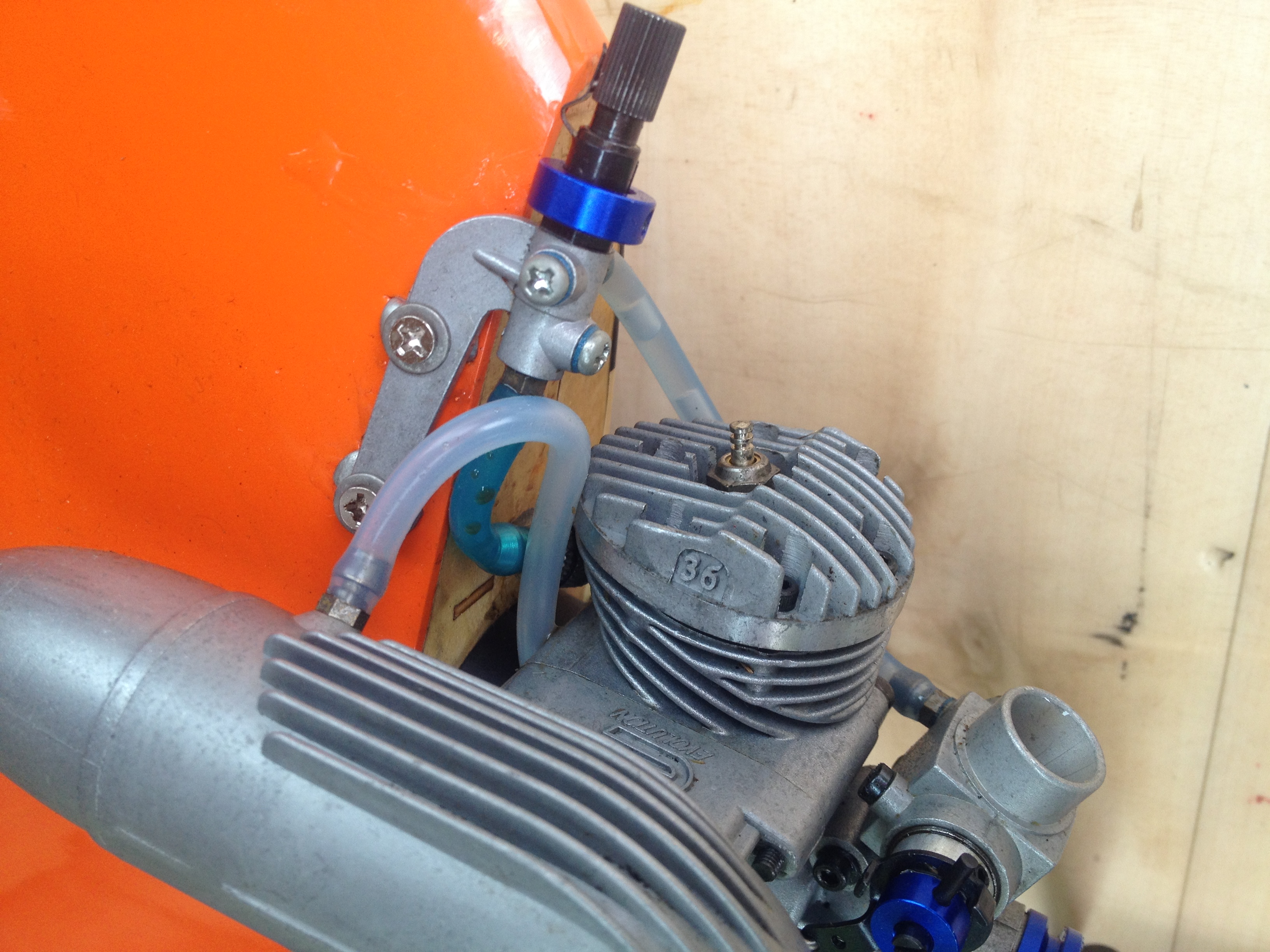

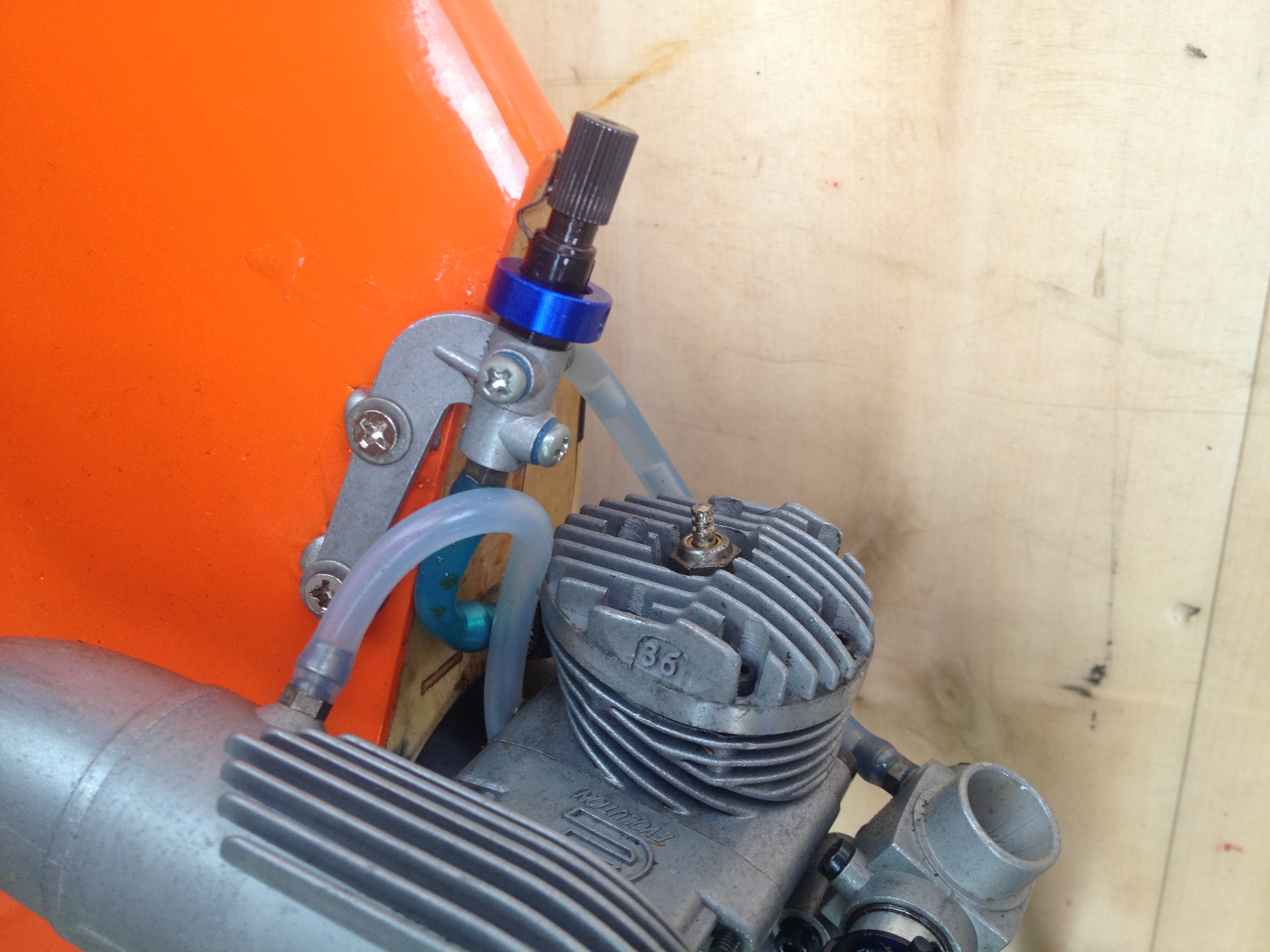

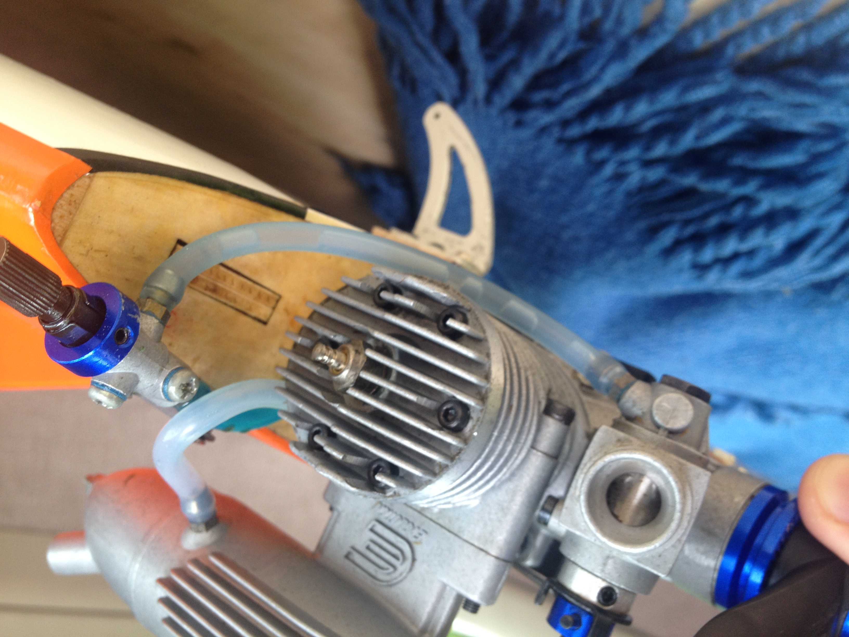

Hi.
I have a Evolution .36 mounted to an Extreme Flight Outlaw.
I've always had trouble getting it started and keeping it running more than a few seconds. Yesterday I fired it up, and got it running for a couple of seconds.
I noticed some air bubbles right after the HS needle in the fuel line when it was running. I also saw some air bubbles before the HS needle after it had stopped. Where could the air leak be?
Tank? Fuel filter? HS needle? Carburetor?
I'm also running it on a O.S #8. I've heard Evo-engines can be picky on plugs. Any suggestions on a better one for this engine?
Thank you so much. Here is some photos of the fuel lines right after it stopped.

Air bubbles before the needle valve is a tank or fuel lines problem. Replumb the tank and be gentle when you reinstall the tank. Also replace the fuel line between the needle valve and the carb. Bubbles after the needle valve indicate bad o rings in the needle valve usually. As you've seen, no amount of tuning will make an engine reliable when it doesn't have a reliable fuel supply.

I enlarged the photos and couldn't see any bubbles in the tank line at all but wanted to see what happened when you removed all that hardware John pointed out. That is one funky remote housing too. I'm not familiar enough with the Evo engines but I would be doing a reverse pressure test on that housing to see exactly where it's leaking.
I use one of those squeeze bulbs used for ear cleaning for pressure testing. I put a piece of brass line in the bulb then attach some fuel line to it, put some fuel in the bulb, attach it to the nipple on the remote and give it a squeeze. Wherever fuel or bubbles flow out is where the leak is. Could be the O-ring on the needle valve or those two screws in the housing look suspect to me too??
