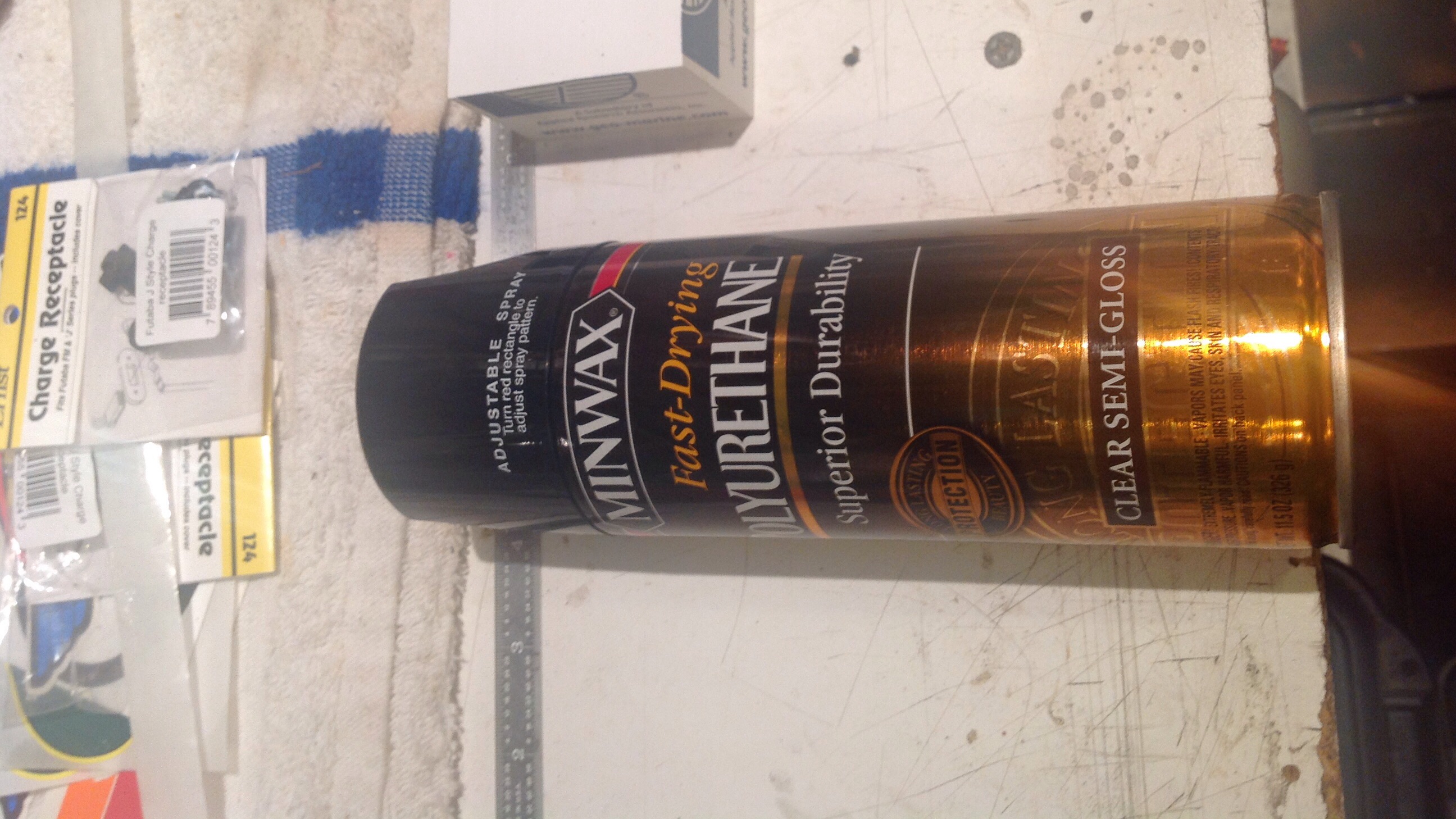

Thinned epoxy and dope work but I have found that this works just as well and is much easier to apply to firewalls and fuel tank areas. Get it at your local box store. Turn can upside down to clear nozzle and it will last for many years.

I like that. Think I'll try it just to test it. Big box stores sell that? Where to buy spray Minwax Polyurethane?

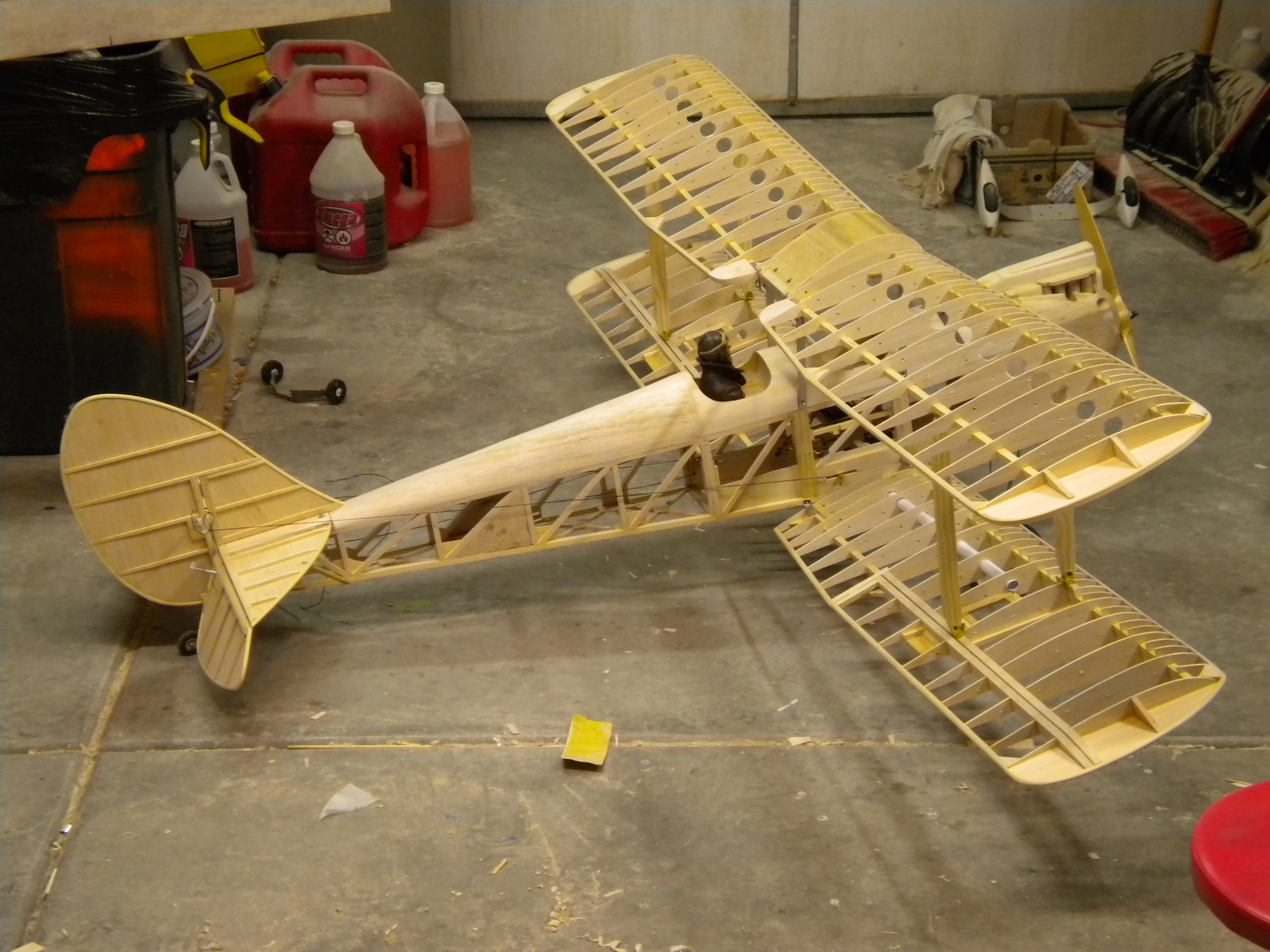

I have an Aerodrome dh 60 moth that I finished building in 2012, another club member started it in 1992, great flying plane in all wind conditions, I have it overpowered with an os 55ax. I like it so much that 2 years ago I had the plans blown up to 1/4 scale, great flying plane also, powered with an os gt22, at 16 lbs it is not overpowered

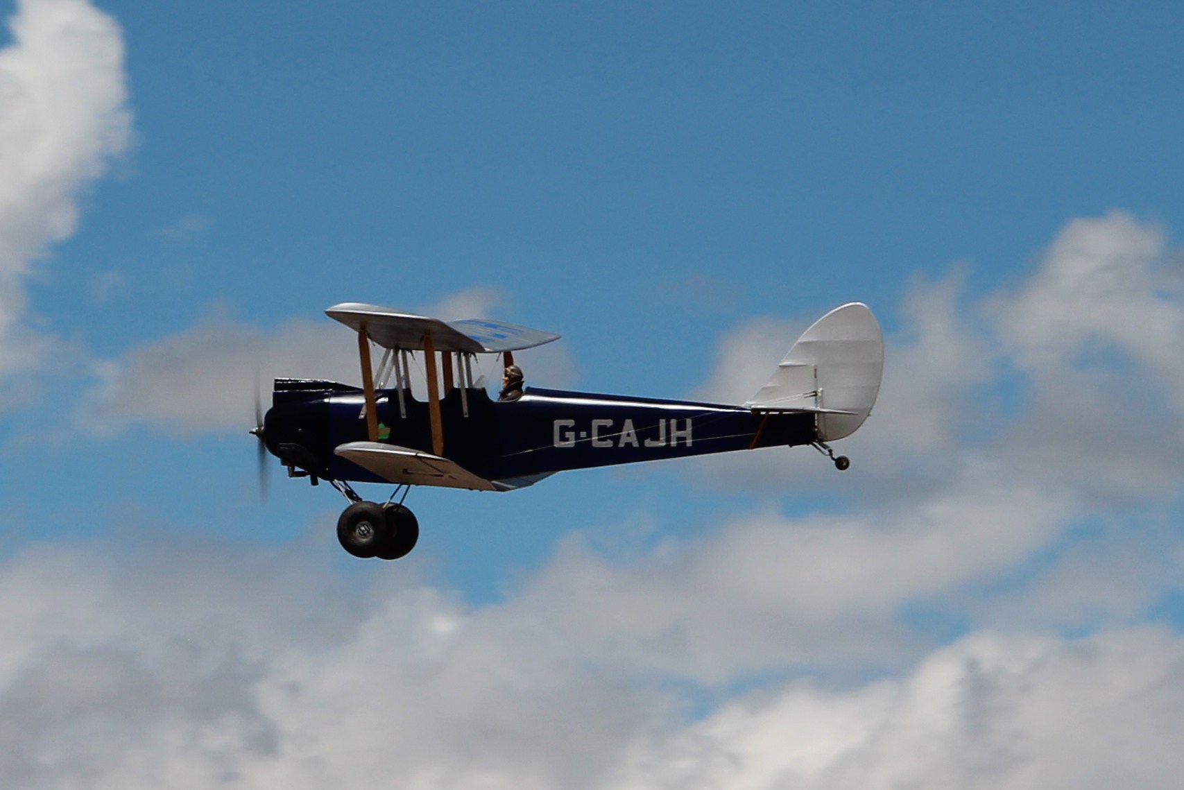

Thanks for posting the pic! I was wondering about what colors to cover it with. Your plane looks great! Is it Blue and Gray or is that White? Doc

the wings on the original were usually silver and the fuse could be just about anything, mine is dark blue and silver
