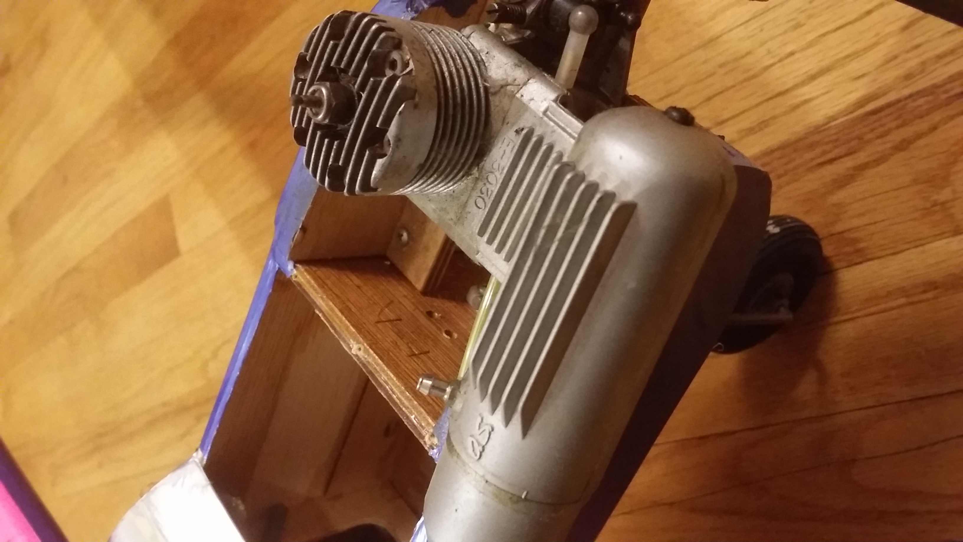

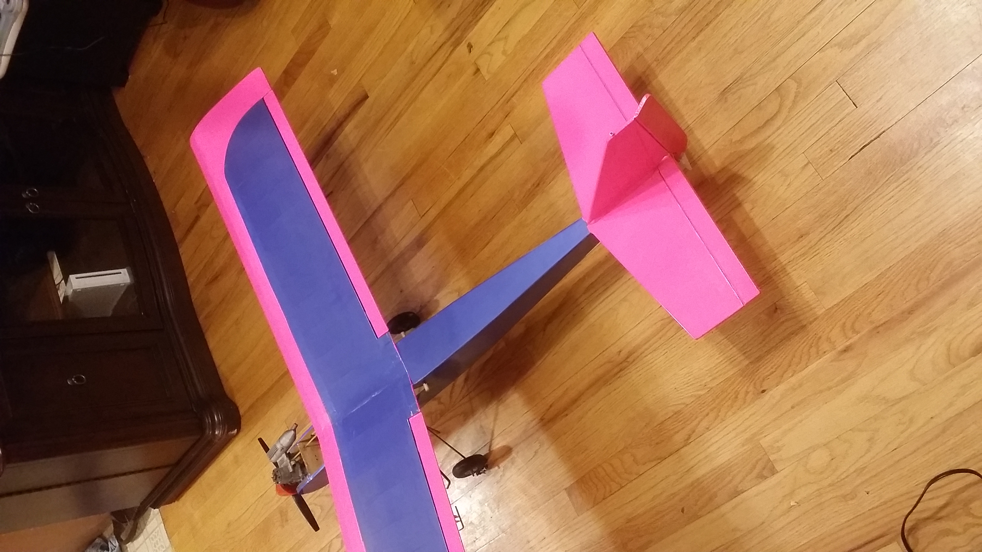

Hey everybody my names Matt and it's my first time getting into this hoby. Not much of a story to tell for me but when I was younger my dad had a couple of old rc planes that he flew and let me fly a couple of times but that was many years ago. So here's my situation. I was helping a friend go through her grandfather's house after he passed away and he had this I'm guessing old rc plane hanging in the garage. She said I could have it if I wanted it. So I brought it home and now I have no idea what to do from here. Here's what I know (sorry I'm not up to the lingo).
Engine:OS Max FP 40
Receiver:Futaba fp-r127df dual conversion FM 7 channel

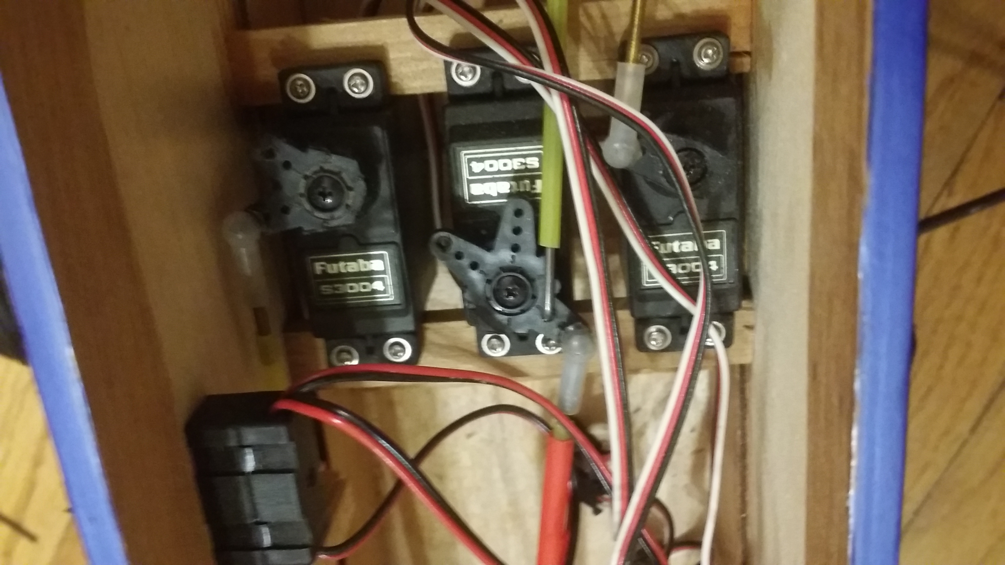

Servos:3x Futaba s3004 controlling(throttle,elevator and rudder)

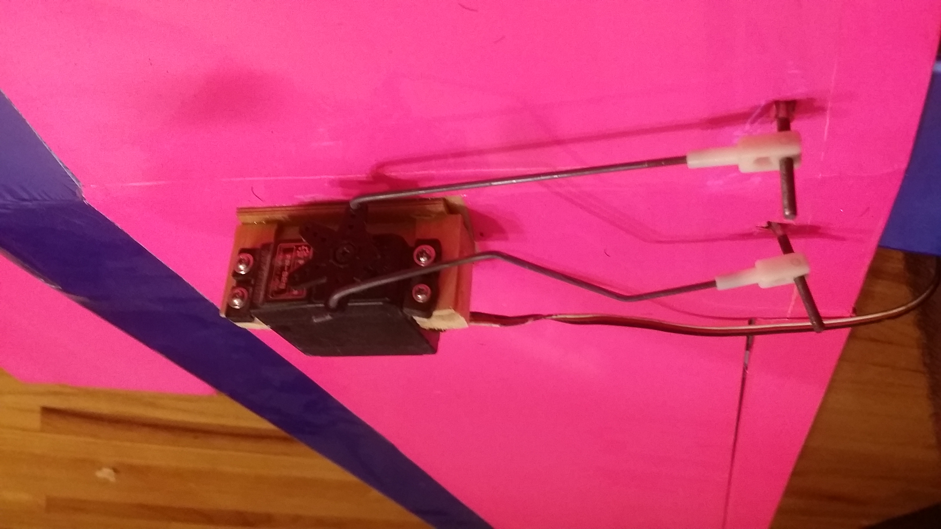

Servos:1x Futaba fp-928 controlling (ailerons)
Battery:Futaba nr-4qb
Sorry for the legnthy post just wanted to try and cover it all. I don't know if any of it still works. Probably going to play it safe and replace all. Can someone help this new guy out.
Engine:OS Max FP 40
There are several items of good news there. The plane is a trainer, so it's appropriate for a beginning pilot. The servos and engine aren't too terribly old, so they should be serviceable. So if you will get with an instructor who can trim the plane for you and show you how to fly it you should get a good start in the hobby. You'll probably need to pull the backplate, head, and carburetor off the engine and soak it all in fuel for a few days to loosen the congealed castor that's probably there. The engine should spin very freely, only getting tight as you come up against compression at the top of the piston stroke.
You will need to buy some things though. The receiver you have is 72mhz, which is not used much anymore. It still works as well as it ever did which is pretty well, but if the plane didn't come with a transmitter you'll need to get one. A new 2.4ghz radio set will cost between $150-$300 depending on how much future capability and quality you want to pay for. I know that's a lot, but it's the best single investment we make in this hobby. Choose the brand that your instructor has a buddy box for. Planes come and go, but the radio gear stays with you. You'll need a new receiver battery, and if you fly at a club field, you'll be required to join the club and join the AMA. You'll also need fuel and a fuel pump, an electric starter and battery for it, and a glow driver. It's a good idea to replumb the fuel tank as the silicone tubing is pretty fragile. Expect a $400 initial investment to get you started in the hobby. Then it will be up to you how much it will cost later on as you add planes to your collection. Starting with this plane, assuming it's in good shape, will save you about $300 off the typical cost of getting into RC flying, but it doesn't make it free. You could save a big chunk off of that initial cost by buying a used 72mhz radio that will work with your receiver, but you'll still need to work with an instructor with the costs associated with that. I wouldn't suggest trying to go it alone, as most attempts at that end pretty quickly with disappointment.
So all that's to say if this hobby genuinely interests you and you want to pursue it, you have a head start. But if the idea is to just get this plane in the air to see it fly a few times, you're probably better off starting with a foam park flyer that can take the inevitable bumps that an inexperienced pilot will give it.

There are a couple of ways to free the sticky throttle barrel. WD40 or a light penetrating oil would be first. Let it sit for about 30 mins and see if you can work it loose. Alcohol works better, but I would take the carb off first. You don't want to get alcohol inside the engine for very long as it can rust within hours. If those fail, pull the carb and put it into the oven at the lowest setting, and check every 5 mins. The heat will loosen the dried varnish.

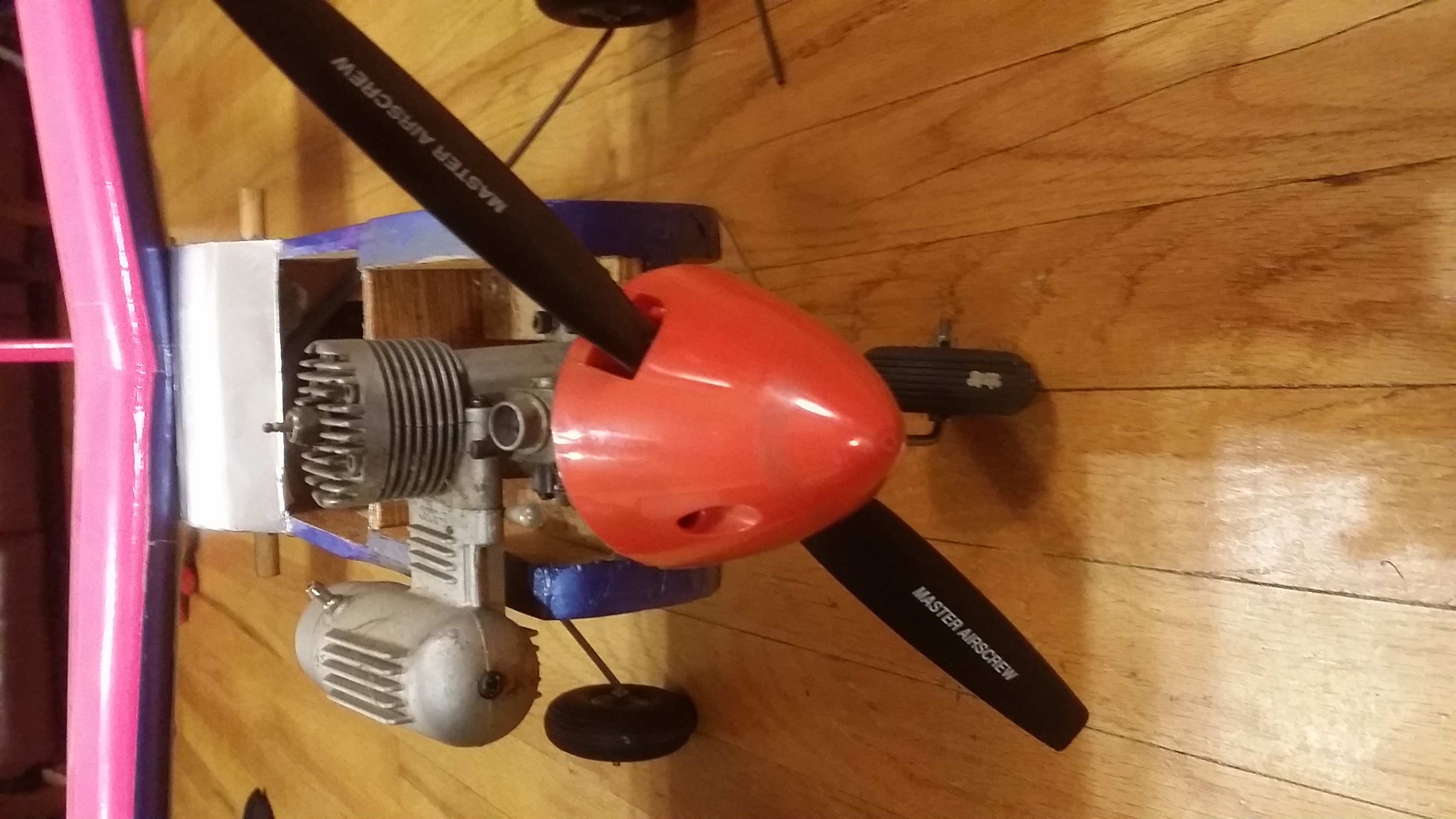

If you have a hobby shop nearby, I would pick up some spare propellers. For the OS 40FP on a trainer, see if they have some 11-4 props. I bet it has a 10-6 on it. An 11-4 (11" by 4" pitch) or an 11-5 will keep the speed down for landing and maximize the thrust of the rather anemic 40FP. These are about $5 ea.

Did you get a glow-plug igniter? You can get a glow plug igniter at your local hobby store or online. I like the ones that take a dry cell battery. Speaking of glow plug, yes, they are black inside. The coil inside the glow plug will glow with the application of 1.2 to 1.5 volts

Re the props yes the 11x 4 is the way to go. Grey Graupner props are the most resistant to damage but Masters are almost as good. Avoid APC props as they are brittle.

It is a nice looking plane and should fly well. Tell us how you get along.

Servos are servos. Most any brand will work with most any receiver. (Forgetting modern, super high tech, high voltage servos)

The prop size is printed on the outside face behind the prop nut and washer. It might look like 10-06 in fine print. Nothing wrong with a 10-6 on a 40FP. It is a middle-range speed prop. But like myself and others have suggested, an 11-4 will keep the speed down, good for a new pilot. Getting working radio gear and a local instructor are higher priority.
