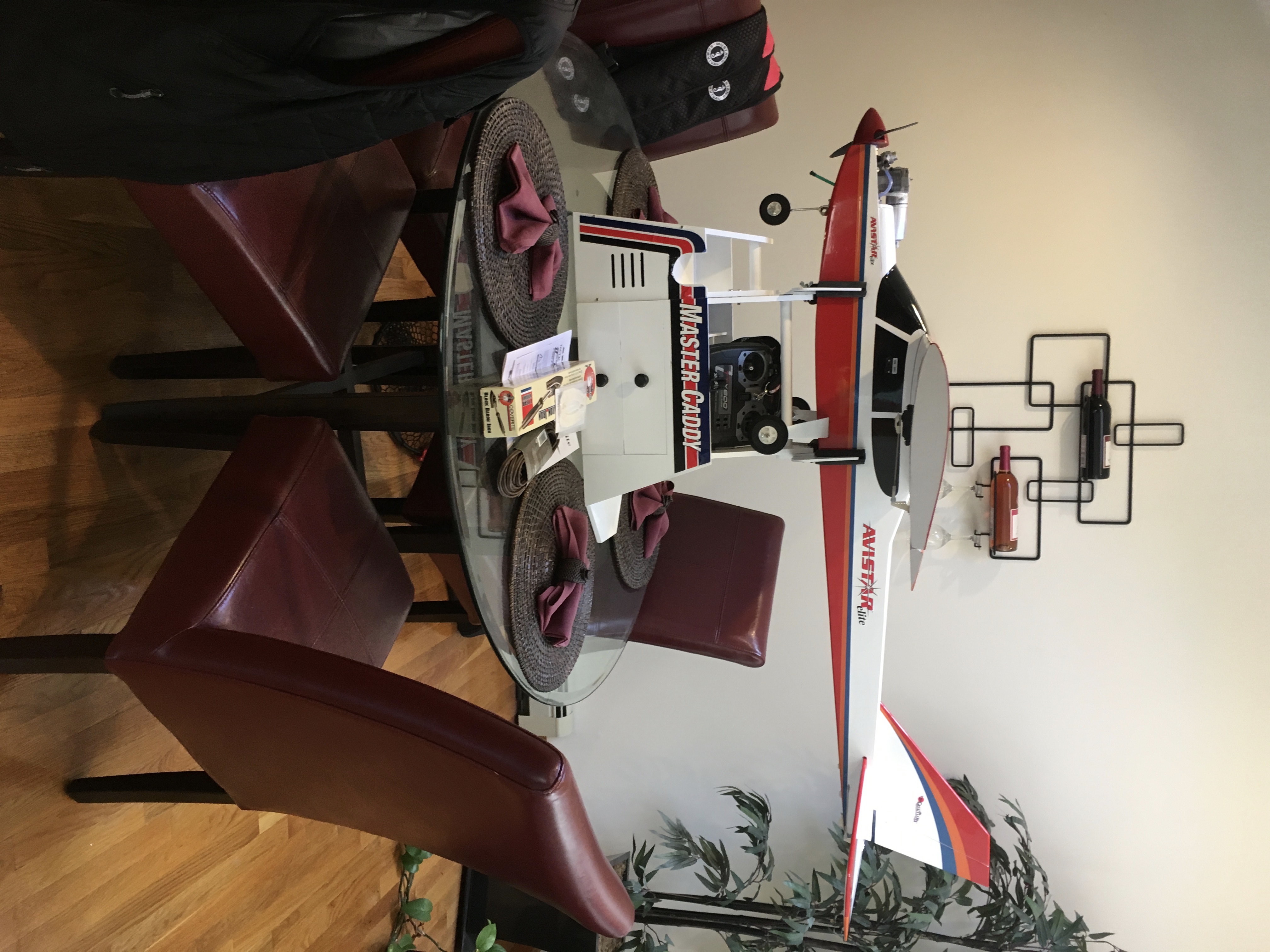

Heres the new plane

It flies sideways?

Yes right into the ground If you click on it ,it will open up correctly .................

Nope. Just gets bigger.

No, open the pic and then click on it again to enlarge it. The pc will correct the image and straighten it out.
He must have posted it with a mobile device. This site has an issue with pics posted that way and that is the result ...inverted or sideways postings.

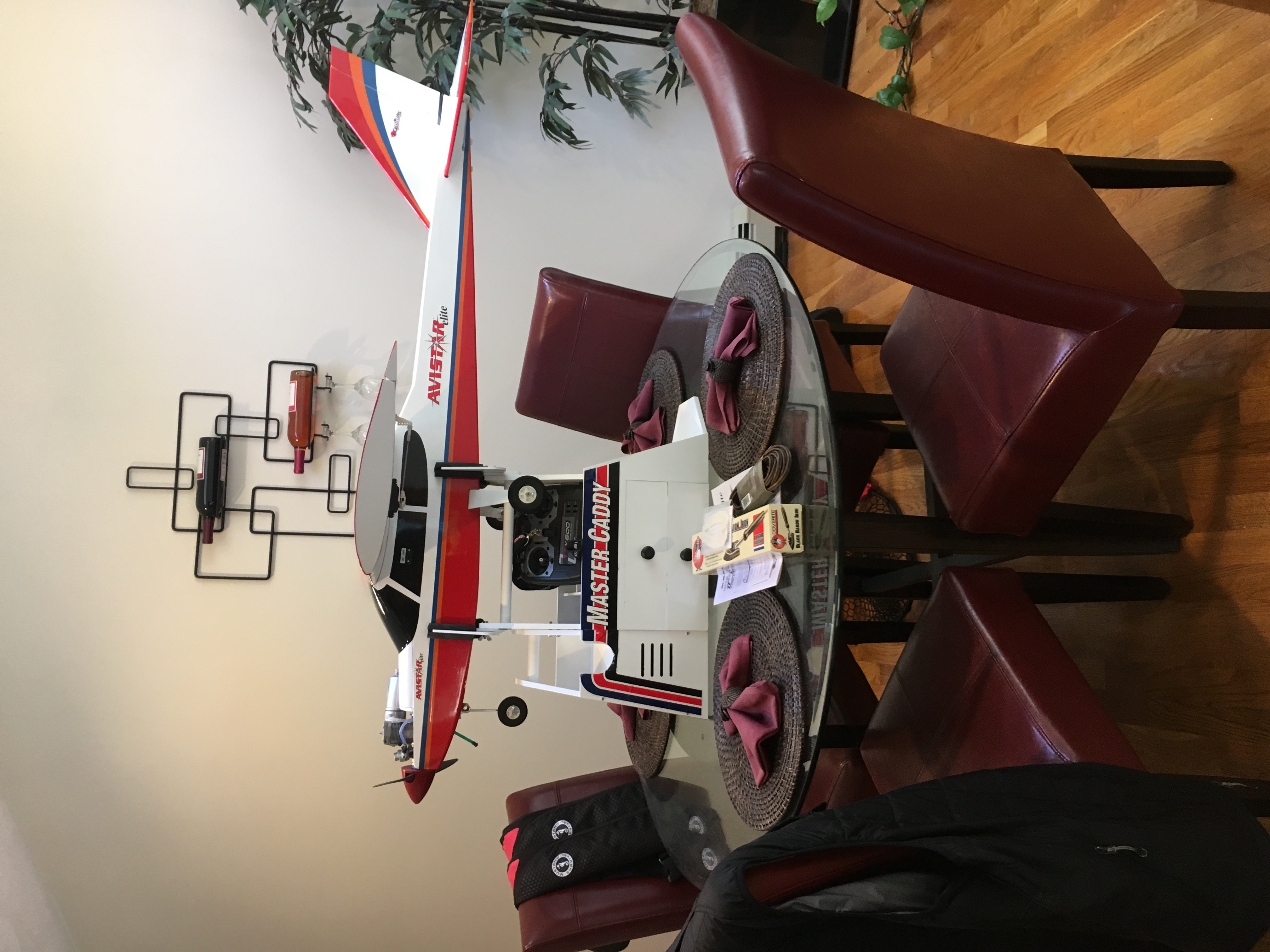

Cool. A self correcting picture of a self correcting plane. I have a Tower Trainer not that I need one but just because I like to cruise around the sky and not have to constantly correct a models flight path. It will fly from as far away as I can see it to as far away as I dare and unless it is gusty I almost never have to touch the controls.

Carl! I am sure you will like it. Have you found an Instructor or a Club? If so, did you get to fly it? Hope so with good results! IF you haven't flown it make sure you correctly break in the engine. I know there are people that say the engines don't need it. But, if you take the time to do it, it might save your plane from an unwanted dead stick. Go to your field and look directions, and imagine that you have a dead stick 50 feet in the air. The plane won't make it back to the runway, so, where are you landing? That will make you break in the engine on the ground. May save the plane and a pair of underwear......lol. Fly with what you break in the engine. I used to like Cool Power or Wild Cat, but not sure if they are around now. 15% is good enough, and never go backwards or lower in Nitro %. You can go up, but not down. Don't set too high of rates for the controls. Less is better, more is trouble. Same on the nose gear steering. For take off, you only need about 10 degrees left and right. But, may not be enough for turning on the runway. So, set it to a higher degree of 15-20 degrees left and right on the nose wheel and increase the rudder/nose wheel expo up to 50%. These may have to be tweaked to make your plane fly the best for you. And, if you don't like your instructor, change. It is not uncommon to do this, due to personalities, etc. And, hopefully, you won't get an Instructor on his last nerve of teaching with a product he despises.
