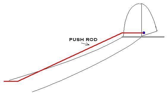

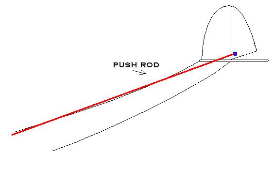

hi, i am worried about an aspect of a plane i am scratch building. for my rudder control, i have the push rod comming up at an angle to my rudder, here are 2 options i have thought of in controling my rudder. the first one here is where the push rod is bent so that the force on the control horn on the rudder is horozontal, and the 2nd picture here is where i have the rudder inclined at an angle so that the forse of te pushrod is not trying to push against the hinges that i will have holding my rudder on.
will either of these work, or would it work with the pushrod bring straight as in picture 2 and have the rudder as in picture1.

How big is this plane? I think either will work for a 40 to 1.20 sized plane...
The key to having a straight pushrod will be mouting the control horn with a twist so that the pushrod does not bind.
If you decide to bend the push rod so the control horn is square to the rudder then make sure the bend does note prevent full control throw. If the bend is too close to the fuselage it may the pushrod exit...

The way it's shown it picture 1 will NOT work. The bending moment on that rod will prevent the rudder from moving much, and I'd guess that the force of air movement would push it back. Picure 2 might work okay.
If you don't use pull/pull, get a flexible rod in a tube set up, like one of the Sullivan Gold n' Rods, or what ever they're called.

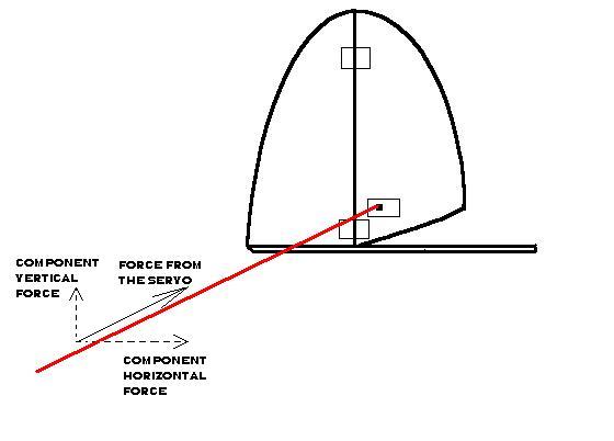

Stick Jammer would this configuration work? my thought is that seeing sa the rod is pushing at an angle it will be putting too much strain on the hinges that will be holding onto my rudder, because when you push at an angle there are 2 forces at work, a vertical one and a horizontal one, and i dont want a vertical force as i am concerned that the hinges will give way whilst flying and i will be screwed.

this gives you an isea of what i am saying... the component horizontal force is what i want, but having the component vertical force will ut a turning moments onto my hniges which will be adding a lot of strain, if the hinges still hod i believe there will be a resistance to turning due to the increased friction in the hinges, if any of you have encounted this problem and cna solve it for me it would be much appreciated...
Ok, let's get back to reality here. But first, as ridiculous as this design is, there is no reason why you couldn't angle the hinge line of your Rudder. You probably won't get a chance to use it anyway.

DBCherry would the vertical component force be neglegable? so pushing at an angle wouldnt put too much strain on the hinges?
Having seen the design, I would highly recommend using flexible pushrods though. Sullivan makes them, and you can also find braided cable types that run in plastic sleeves. These allow for long sweeping curves without any concern for binding.
