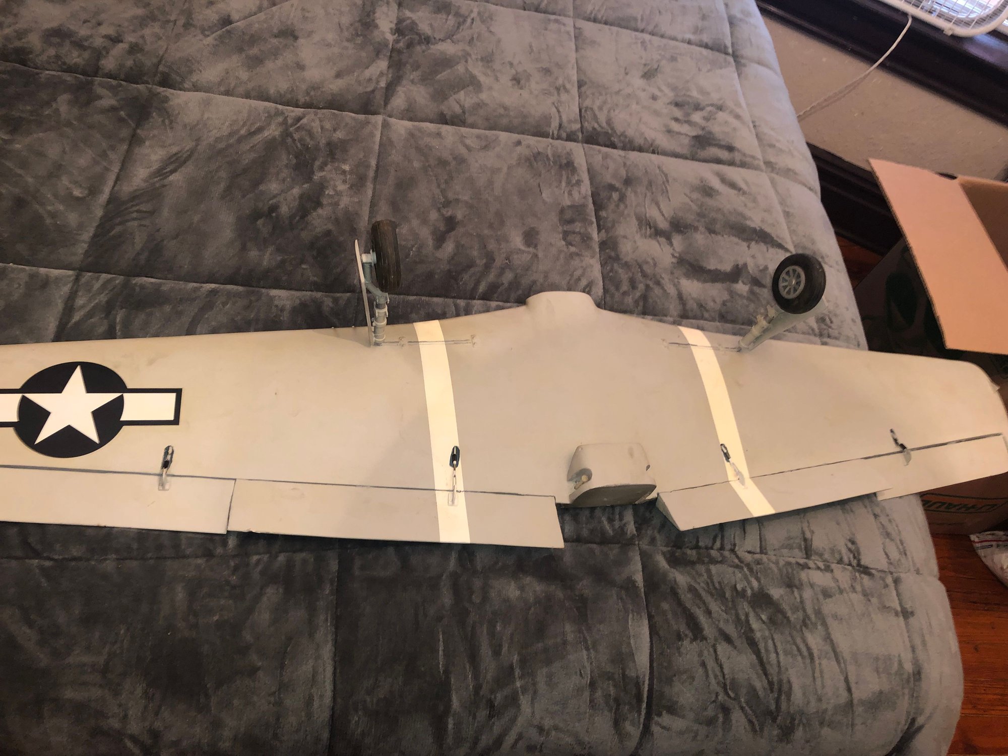

I got this plane from a buddy who found it in the trash. I’m new to nitro planes but I’m familiar with flying. I 3D print and build my own quad copters/drones. The plane looks fully intact aside from the rear rudder. There is no rod connecting to the rudder. How ever as photos there is a rod that connects down the majority of the plane but stops were the broken wood is(I assume this is where a rear wheel went?) technically there are two rods how ever one rod is connected to the rear horizontal wings for moving the plane up and down and they work fine. The rudder is simply not connected. I assume there was another rod that was supposed to be in there but no longer is. I think I’ll have to cut a hole in the side of the hall to get the rod in there and get it hooked up since there is no access to the spot. I’ve posted photos any and all help would be appreciated. If I can get this rudder hooked up I think this plane could fly again. It has a old ENYA 60 III 7033 motor on it. No electronics at this time.

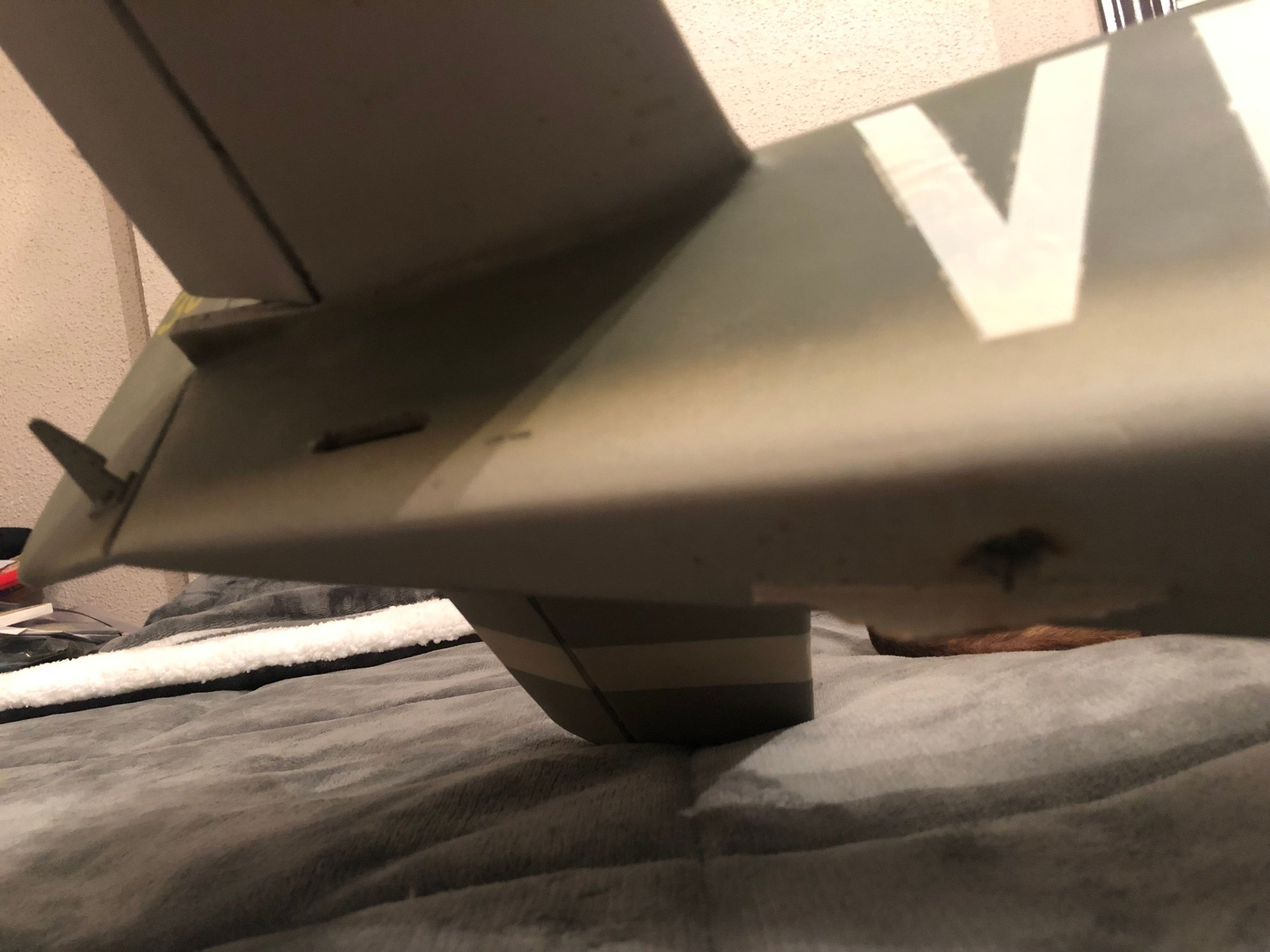

Couple more photos of my rudder issue, a diagram on how it originally connected would help me a lot to figuring out how to fix it or fix it in a alternative way.

It looks like just a standard wooden pushrod setup, similar to what is actuating the elevator. Make a new one from a piece of 3/8 dowel rod fixed on the ends like the one you have.
I think you'll find though that there will be more to getting this old bird flying again that just hooking the rudder back up. Plastic deteriorates, so you may need all new clevises. The covering may or may not be sound, and you certainly don't want it coming off in flight. The bellcranks for your ailerons (maybe flaps too?) are probably fine, but if they are loose you'll need to bypass them and create individual aileron servo mounts in the wing. And that's all assuming that the glue hasn't generally deteriorated and there isn't old crash damage that hasn't been properly fixed. I restored a couple of old planes like this early in my time in this hobby. It can be a labor of love, but it is never simple.
Also, if you have only flown drones, you don't have the piloting skills for a model warbird. You'll be familiar with working the sticks and flight in general which is good, but you don't yet know how to land, how to recognize a stall and what to do about it, or how to keep orientation of a drab colored object moving at 70 mph in the sky. I don't mean that to say you shouldn't take up traditional model flying, only that it would be wise to get with an instructor and learn some piloting skills while you are working on this plane.
Keep us posted on your progress. It's a guarantee that unforeseen issues will arise, but that's all part of the process. We'll be here to help you.

The plane is an old Top Flight kit originally designed by Dave Platt circa late 1960's and finished in the box top depiction. If it was built according to the plans, the ailerons (outer pair on the wing) and flaps (inner pair on the wing) are solid balsa wood blocks. Hence the feel and heft. BTW, the flaps move the same direction together and only go down. 50 degrees from level is the max deflection for the P-51 flaps. The ailerons move opposite each other. That is one goes up the other goes down. They cause the plane to bank or roll over to one side. The tail pieces are all sheet wood. Original plans had a fixed, i.e. did not turn, tail wheel. I'd be tempted to let the tail wheel free wheel instead, i.e. turns but no control to it. Then run a piece of the Sullivan Push Rod to the rudder from up front. You can get the original plans in a free download from Outerzone. P-51B plans
The plans show the construction and control details you're asking about. The entire thing should have been sheeted with balsa, covered with fiberglass and painted. But there's no accounting for what people did back then.
The plane flew well on a 60 sized engine of the day. So I wouldn't try to change to anything bigger. I had an OS 60 Gold Head and Rhom Air retracts in mine in 1974. I also converted mine to the 'D' model with a bubble canopy.
Ask yourself if you were learning to fly full size (butt strapped firmly in the seat), would you start with a P-51? A single seat high performance fighter? Models are not unlike the full size in that you need to start with a trainer. Typically a high wing with trike gear (nose wheel). Then you progress to low wing, tail draggers, aerobatic and so on. About 3 or more planes into it, you might be ready for a war bird. But don't hold your breath. I was probably approaching ten planes under my belt when I built the Mustang.
If it were me I'd repair any damage, clean the whole thing up and hang it in a place of honor somewhere in my house. While solidly built, you have no history of the model. You don't know what if any repairs have been carried out on it. You don't know what kind of glue was used and if it's still good. Or why the model was retired and tossed in the trash?
Get with a local club. There are several in your area. A trip to a dedicated RC hobby shop is a good way to locate all the clubs in the area. Someone may even recognize the plane and be able to tell you something about the builder, owner, etc.
