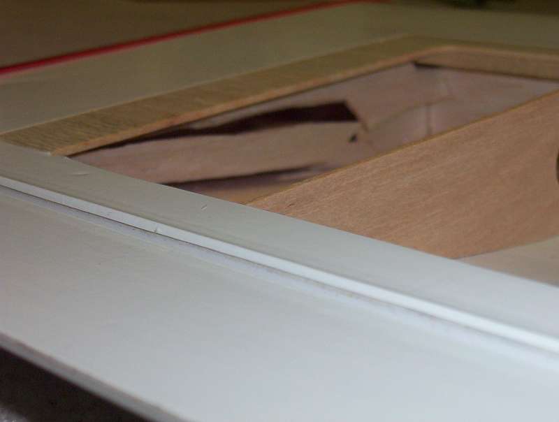

Hi,
I was flying today with an instructor when he told me that my plane was just blowing around and that control was really bad. It was a little bit windy but a kadet Lt-40 made it out just fine. I got home and i noticed that some of the spars were loose. I tore the covering back and all the spars on the right hand side were shot.
How would i go around fixing it. some are broken, some have gaps etc.
Any help is much appreciated

The broken pieces in the pictures are called wing ribs. The spars are the pieces that go into the grooves in the ribs from center to tip normally about 1/4" square at the thickest part of the wing top and bottom.
There are several ways to make the repairs. If all the pieces are there and can be aligned then thin CA will do the trick. You may need to add some wood and then reform the airfoil if the top curve is missing. The ribs seem to have a large portion removed probably to lighten the structure. Adding some small pieces vertically will help keep the airfoil shape and add a lot of strength.

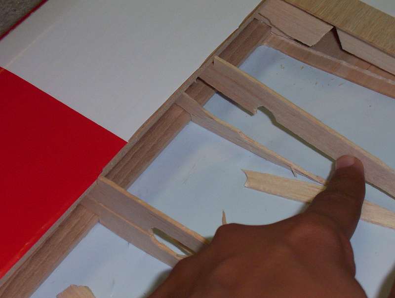

Thankx EXCAP232 for the quick reply.
For fixing the wing ribs do you mean this?. Black lines representing the new wood pieces to be added.
And are you saying that these ribs are supposed to be cracked and loose to begin with just to lighten it up a bit? Also can this be a reason for slugish aileron control?

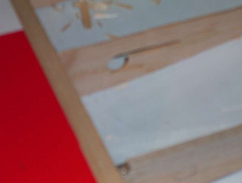

How many times have you flown the model? How many sudden arrivals has it had?
Those RIBS look like they have been subjected to some pretty hard treatment...
I have a suspicion that the wing has been fairly severely overloaded at some stage. This kind of rib crushing happens when the wing tries to bend, and the spars want to get all chummy and close together. You been doing aerobatics with it? Pulled out of a loop too quick or too hard? Landed on the roof instead of wheels?
If all the ribs are like that then that wing really needs a rebuild. You might be able to do it if you can extract enough of a rib to make an accurate template. Use that to carefully cut new ribs and slide them into place with a slow setting adhesive (no ca here!!). Have the wing well pinned down before you start, and mark (on the TE and back of the mainspars, where each rib fits. THEN ADD VERTICAL WEBS BETWEEN THE SPARS ON BOTH WINGS.
It is going to be a slow and pains-taking experience, but an interesting one and a good test of your building skill.

That's some impressive damage. I've never seen that kind of damage from flight loads alone, that kind of damage looks to me like the wing was crushed at some point, like somethign falling on it in transport or something.
Is the damage localized to the ribs you have shown in the picture, or does it extend farther out on the wing? If it does extend most of the wing, I'd really say it is crush or crash damage, since the flight loads at the tips are actually very light.
While you are in there repairing, you should consider adding some shear webs on the inner 1/3rd of the bays. A shear web is a bit of balsa sheet with the grain running vertically that is glued between or against the spars, along the spar (ie 90 degrees off from the ribs). It prevents the spars from flexing towards each other or shearing past each other side to side. I can't see what's going on in front of the spars, but you need to get a look in there as well, and you really should consider cutting away the sheeting in the wing center setion and checking in there. The flight loads on the center section are much higher than even 6" away from the fuse.

Wow, ok, you have shear webs already, though the wood grain is sideways and not vertical as it should be. Still, they should have prevented anything from happening in flight. It really looks to me like crush damage. I accidentally steped on my wing a bit ago (don't ask how I managed it), and the damage was simular to yours, but not as extensive (I felt my foot hitting somehting that shouldn't be there and caught myself). I really doubt you managed to do that kind of damage just by flying.
And you say there is nothing like this on the left wing? Or in the rest of that wing?
Anyway, since the ribs themselves don't actually have a lot of loading on them in flight individually, I'd just put them back together like a puzzle and hit wth thin CA. The results will be just as strong or stronger than it was before.
You could use thicker wood, but I don't think there is any need for it. 3/32 should be as thick as you need for a .40 size plane.

There is no damage on the other side of the wing. A lot of the ribs cant be put back like a puzzle because all the pieces arnt there. a lot of them have huge gaps in the middle where a piece would fit in. Am i better off to just fabricate new ribs as i will be flying with it next season and the seasons almost over here. until it gets really cold[X(]
