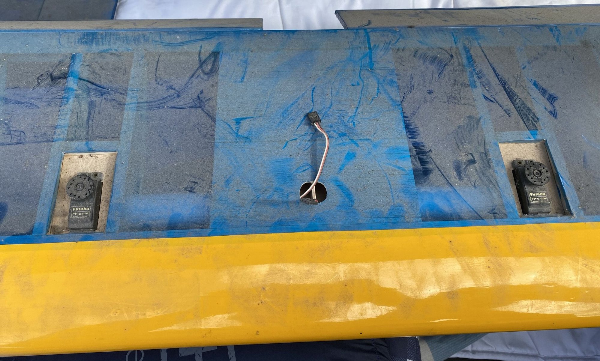

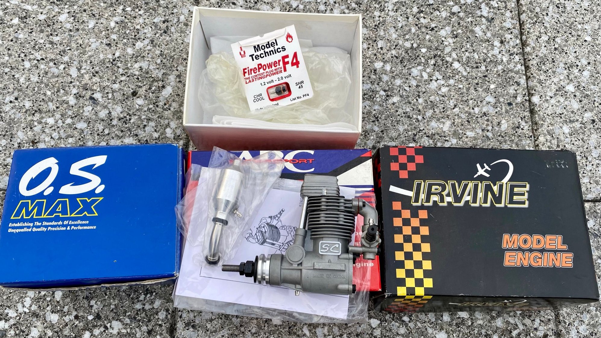

Some photos:

After looking around the online stores I see you can buy full RTF kits with transmitters for Ł71 - how is that even possible!

Yes, there are some toy grade stuff out there. I have zero experience with them. Since modern electronics are virtually built proof ( I’ve been flying the same two transmitters for 9 years ) I suggest going with the EX8. For the airplanes that you have, any of their full range 6 channel receivers will work just fine. Just beware, there are counterfeit Spektrum receivers out there so make sure you buy from a Horizon hobby authorized dealer. The really cool thing about Spektrum is that you can get their bind and fly airplanes. Some of those are pretty cool and the small UMX models come with stabilization. Looks like you have a nice collection to keep you busy.

I love it. S-148 servos in the wings for what I assume is the ailerons. Those are actually still available, if they will work with whatever brand of receiver you go with. I'm just wondering if they are still good after this long. I've got a servo that was never used that actually had the cord corrode so, if you still want to use them, you should test them on the ground somehow first. Maybe Speed knows if Futaba servos are compatible with Spectrum receivers, assuming you go that route.
tooth_dr (08-03-2021)
Hi HJ
I think the futaba servos are physically compatible with the spectrum receiver - you just need to trim off part of the plastic plug to get it to fit.
And yep the servos are for the ailerons. So even though it’s a four channel plane it’s going to use 5 channels? How do you tell the radio transmitter to coordinate this?
Can I ask what gyros are for? I see RTF planes with these installed. Are they just to make flying easier? Better to learn the ‘hard way’?

Hi HJ
It's not a physical compatibility I'm referring to, it's electrical. Some servos have to have the wire order in the plug changed to let it work with a specific brand of receiver. This is just like the various types of servos, the wiring at the plug can be just as different
With the DX6, you plug the left aileron into the aux 1 port, and the right aileron into the aileron port. Apparently it is programmed automatically by selecting dual aileron under the wing type when you're setting up the radio. I didn't find anything about it when going through the DX8 manual so I don't know
A gyro is used to stabilize an aircraft in flight. While the gyro is on, an internal wheel is spinning at high speed. Due to it's inertia, the wheel will do anything it can to not change the angle of its rotation so a sensor in the housing sends a signal to a servo connected to the servo that will tell the servo to react in a manner than will keep the gyro and it's housing in the same position it started in. There are specific applications these are used for and, more often than not, they are used in helicopters
