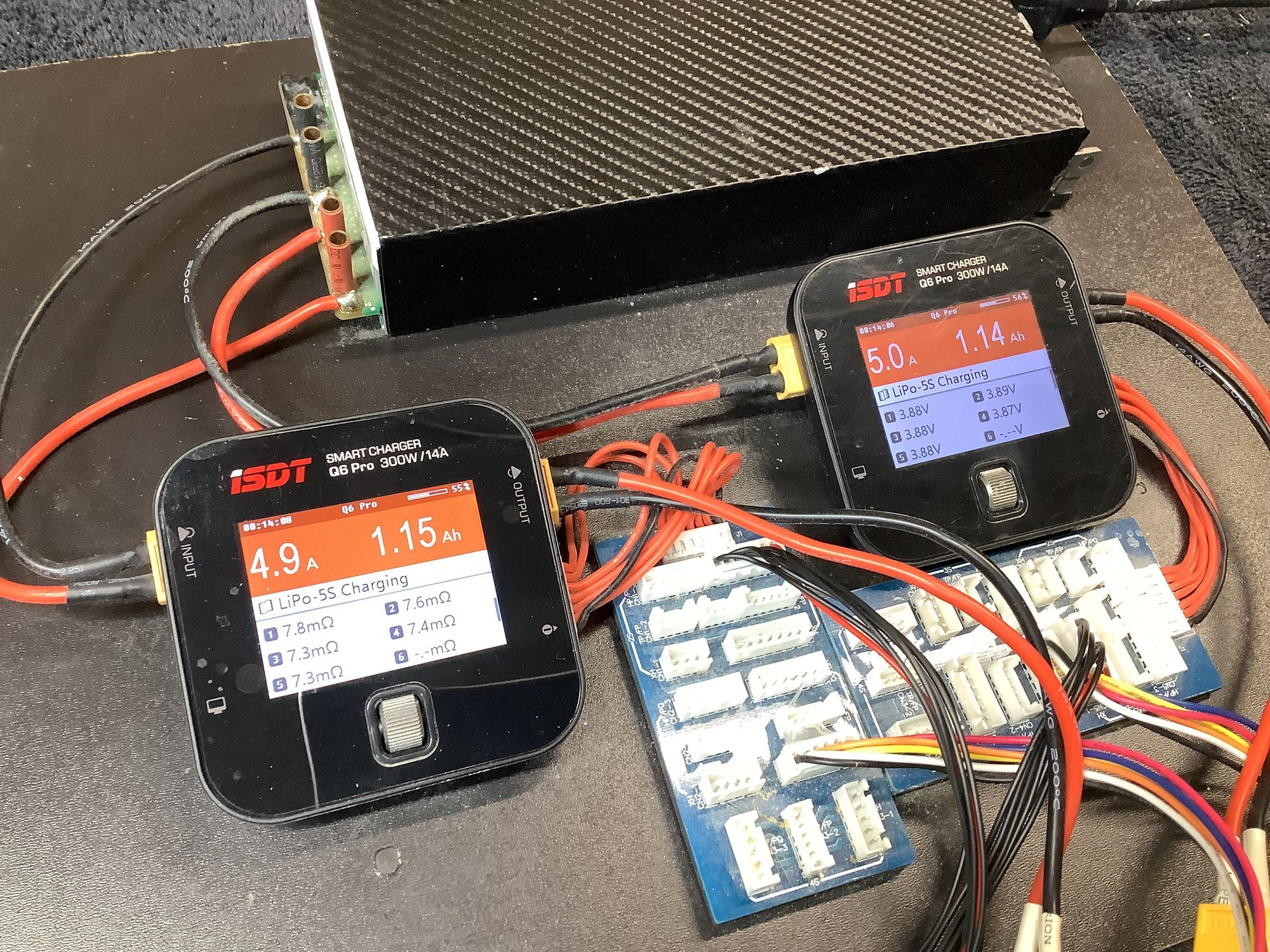

There are lots of options out there and to be honest I haven’t looked for a charger since 2019. Reading between the lines there I hope that you came to the conclusion that I have been using the same charger(s) for 5 years now. My chargers are ISDT Q6 chargers. They are not overly expensive and do a great job but most of all have the safety features that IMO are needed. The bad news is that they are DC only. As you can see from the picture, I run mine off an old converted computer power supply. Easy to obtain one that will put out 15V to 20V at 400 watts. You will also notice the use of balance lead adapter boards and that the chargers are in two different modes, those safety features I mentioned earlier. Every charge I not only check the voltage of each cell but the internal resistance of each cell. If they get to be too far off from one another, it’s easy to catch before a fire can result.
