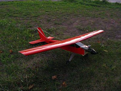

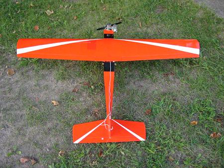

Not exactly sure what the name of the actual plane is. It says fredom 20 on the side, but I think the sticker is off of a different plane. Anyways it uses a os .25 2-stroke and I have a Futaba 6exa radio. Here is a pic of the trainer, any idea what it is??
