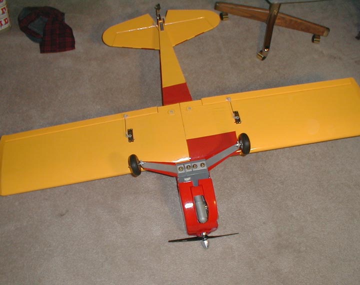

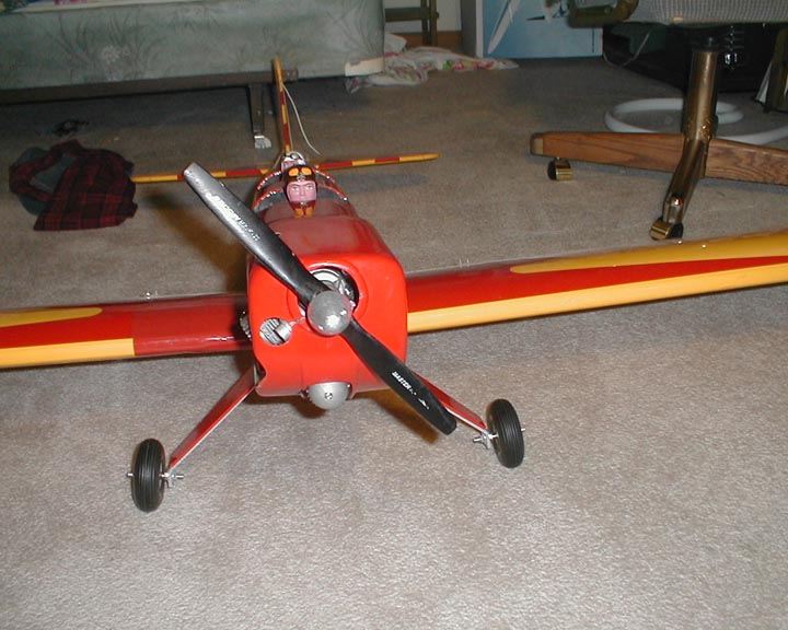

Ok while waiting for the backorder on the new airplane I decided to do a quick fix on the broken one and re-install the magnum 40 engine. The repair was quick but solid and the monokaot is not the same but it was just for a test flight. I took the airplane to the airstrip and left at a 20-30 deg. climb out. No stall and no unusuall behavior , although underpowered it climbed out at a steady speed and continued onward for 4 good flights. I just dont understand why it doesnt roll with the magnum 40 but with the saito 72 it does. I did manage to get some better video this time and it did fly quite well but I still had very little vertical but after 4 flights it is still acting normal on takeoff. Maybe a little smaller 4 stroke in the new one when it arrives?

sounds like a trim problem, could also be part of the reason why it wanted to roll to the left. you said you balanced the airplane fore and aft, but did you balance side to side also? a heavy wing will act the same way.

I could imagine the Saito .72 wanting more right thrust angle.
That's enough engine to fly a GreatPlanes 78 in. Spacewalker.

Yes I did balance it laterally and it balanced pretty well only about 1/4 ounce off wieght so I wieghted the right wing. My giles 202 took 4 ounces of wieght and if flies great. Well it flies ok so im gonna install a smaller enigne in the new one , I think its just too much thrust for the little spacewalker. Thanks for all the responses.

You are definitely experiencing tip stalls due to low powered take offs. The 72 four stroke WILL create a lot more torque than that 40 two stroke, and the effect at low airspeeds is much more pronounced.
You mentioned that next time you'll add full throttle just after it takes off; that's the worst thing you can do! That will maximize the torque effect at the lowest airspeed and almost positively result in a torque roll (stall) into the ground. You want that throttle applied BEFORE the plane leaves the ground, then be ready to apply right rudder not aileron, if it starts to roll left.
Hope you have better luck with your new one.
