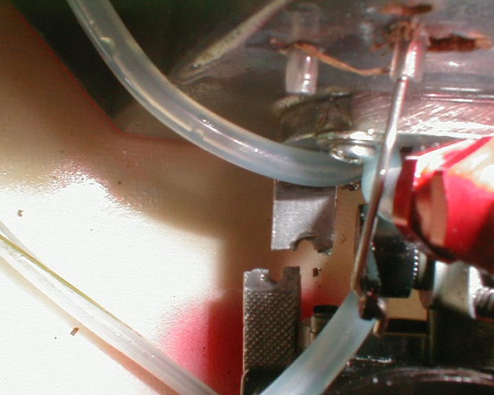

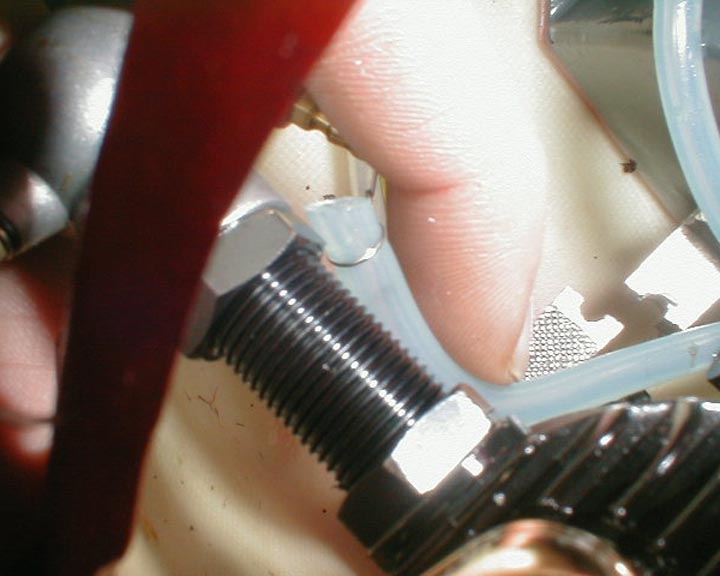

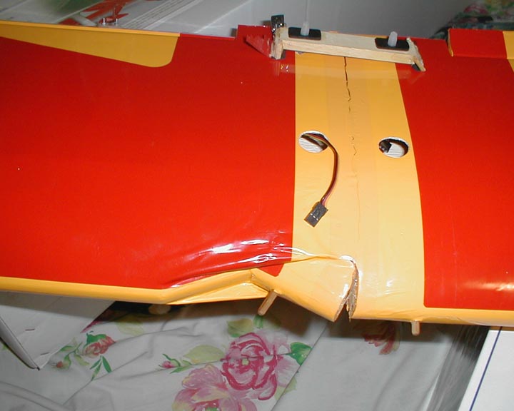

Well guys I thought I had it all figured out but..... I took the spacewalker back up again today, now keep in mind the box it came in calls for a 40-52 2stroke or a 50-72 4stroke , the assembly manual calls for a 46 2 stroke or a 53 4 stroke, and the website calls for a 40-48 2 stroke. I checked all controll surfaces and also did a range check after I tuned the motor (was a little humid today). My buddy was running the camcorder as usuall and the girlfriend was at home......because we cant let them know about all the planes now can we? LOL. I proceeded to the far end of the grass runway (which is 400 feet long ) and did 3 taxi runs. After going approximately 20 feet the airplane wanted to lift the tail and it wanted to leave the ground. I then repositioned the airplane at the beginning of the runway and started to increase the throttle slowly to get it up on the main gear. It increased speed for about 100 feet running on the main gear . When it hit about the 150 foot of runway mark the airplane lifted off at a 25-30 degree climb out. At this time I was at 1/2 throttle and going straight out. When the airplane was about 15-20 feet off the ground it started torqueing to the left and i corrected with right aileron. It then straightend level but as soon as I left up on the right aileron imput it rolled hard to the left and at that point there was no saving it. It rolled almost completely upside down before hitting the dirt. The flying wieght of the airplane is 6-7lbs and has a 61inch wingspan. Could the Saito 72 have caused the torque effect swinging a 13x8 prop? the airplane flew slow with the Magnum 40xl 2stroke engine but was just underpowered and needed all the runway to take off. I later found out my buddy looked up from the camcorder and didnt get the full roll, just a little of the climb out and that was all. I wish i would have the video to show but i do have pictures of the airplane after the crash. My question is why will this plane jump off the runway at 25 feet but wont fly after getting enough groundspeed? Oh yeah I almost forgot to mention the broken motor mount we found right after the crash. I hope the engines ok because it didnt break the plastic nosecone or the prop all the way off.
ID:	77014   Click image for larger version
ID:	77015   Click image for larger version
ID:	77016   Click image for larger version

I forgot to mention I balanced the airplane with a GP planes balancer and got it to balance at a 20 degree angle nose down since i like to keep it a little nose heavy for stability. This is a picture of the front of the airplane with the prop and nose cone still in one piece. I added some epoxy to all joints in the fuse to strengthen it up because of the hot glue they use just doesnt seems strong enough.

I would have used a 13x6 on that saito but the only difference would have been more rpms and better acceleration during take off. What I dont understand is why you kept the engine at 1/2 throttle on take off? Initial climb out needs all the power you could give it and normally as you accelerate down the runway you should be already at full throttle before you pull back on the stick. Seems to me that one wing dipped and the airplane was at the merge of a stall when you added aileron so it aggravated the situation and without enough power to fight the amount of drag it dropped a wing. Sorry for the crash, looked like a gorgeous bird. []

I ordered a new airplane tonight , at $119 its not a bad price . I'm not upset about the crash only the fact that I dont understand why it happend. I would have gone full throttle going down the runway but it was traveling at quite a good speed to begin with. It was moving faster than the 40 would move it but yet it winged over. I am going to install a super tigre 51 on the new one this week and see what that one does. Im just a little leary of putting the 72 back on the new one since it torqued over 2 times in a row with the second crash being the killer of the 2. I dont believe takeoff speed is a issue here but more of a torque issue once the airplane gains altitude. I have other planes in my hanger that have no issues and no flight problems running 4 strokes and 2 strokes alike. Everything from the rascal 110" to the Agwagon and Giant stuka. I even overpowered my T34 mentor and it never rolls like this one. Im trying to get some info because I have the 1/4 scale GP spacewalker and I dont want to make this mistake with the bigger more expensive one.
