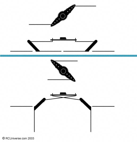

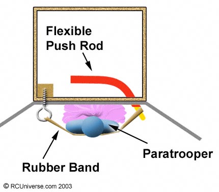

A lot depends on what you want to drop.
If it's a single item, like a paratrooper, you could just hold it in place under the plane with a rubber band that will release via a push rod.
If you want to drop multiple items, like candy, you would need to build a box (internal or external). the door could be operated in a similar fashion, or do a proper "Bomb Bay" type of door.
