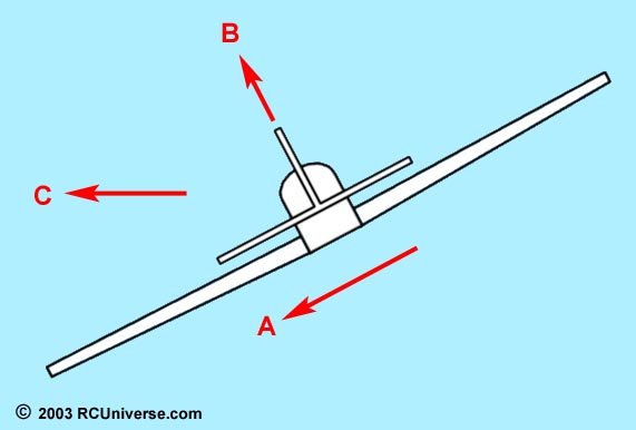

Dave's answer is correct, but I have a more graphic way that I like to explain it.
Look at the image below. Now, for this example, let's say that the wing is symmetrical, so there's little or no lift involved in the process.
When the wing is banked, the plane still wants to fly straight. However, as gravity pulls the plane down, it will want to slide in the direction of Arrow "A".
When backpressure is applied to the elevator stick, the elevator will cause the nose to go in the direction of arrow "B".
The combination of "A" + "B" will bring the plane in direction "C".
So it's really a balancing act, too much elevator will cause the plane to climb through the turn, while too little will cause the plane to dive.
