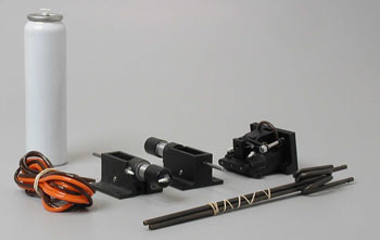

What about the B&D Pneumatic Retracts Tricycle at Tower for $75?
I would buy this one for the Tucano I just bought, but nobody ever suggest this kit. Is this a bad quality one?
Nilo

By the way, this is included for this kit.
Two Pressure lines (53"ea)
One Air Tank (5"x1-1/2")
Mounting Screws (16)
One Flow control valve
One Air tank fill valve
Three Tee fittings
Three 9" Struts
Two Main Retract Units
Two Disconnect Couplers
One Nosegear Retract
One Instruction Sheet
