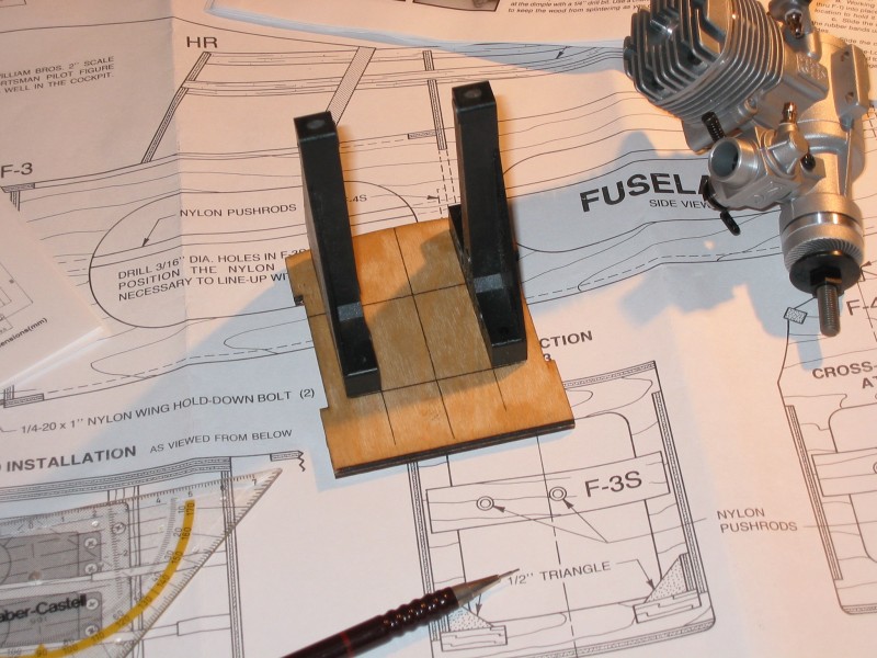

Here are couple of pictures of the engine mount. Can you describe what your problem is.
The engine in picture is 46FX.
Note that the fuse is shaped for the exhaust.

Ok the problem is the engin is sitting to the left. He has the same mount that you have in pic two. The engine is sitting in correctly when the braces are put over the motor and tightend the engine sits to the left (look at your pic #1) and the mount on the right side is bending to the right. I was able to get the engine remounted and it still looks like it is not sitting correctly, we were able to get the engine started but it quickly started to go off to the left. We have not tried running it since the remounting I did, but it does not look very promising. Not sure if the mounts are supposed to bend that easily, but they are bending very easily. I know this sounds weird and it is very hard for a "newbie" to describe what is happing, just wish I have pics avaiable for you and every one else. I also think part of the problem is the fact that the screws he is using for mounting the motor to the mount are stripped. I think he could use new screws but I find it hard to believe that all of is issue is stripped screws.

Do you use braces like most trainers use? The screws go and hold the brace which basicly clamps the engine?
When you said it moved when you start the engine I am assuming thats how you mount the engine.
Put 6-32 bolts through the holes on engine to the engine mount.
