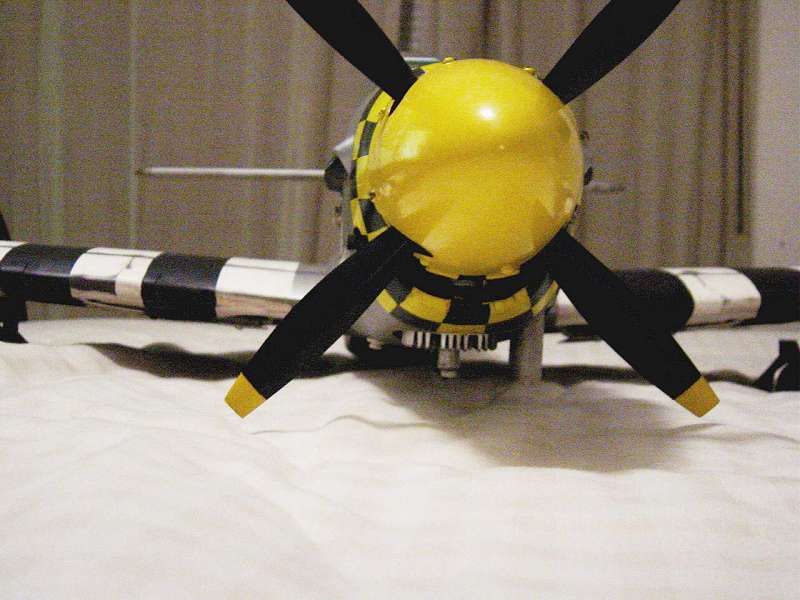

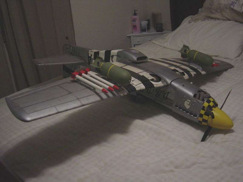

Hi guys....if you look at the LE of my P51 you can see the damage from sitting for about eight years. Question is what should I do to make it better. It was an old ARF, but I don't remember what brand. It is a foam core wing?? but I don't know what it is covered with, it's not monocote and it's not fiberglass. Any ideas on what I can do to get it air worthy again? Thanks, Mike

Do the retracts work ok ? Are the wings warped ? Hows the tail ? I can't see from the photos but if you weigh the cost of repair with the cost of an ARF and then use your plane for spare parts you could save some money there.The plane does look pretty cool though.

From what I can see, partin out this plane would be a mistake.
It's tough to offer advice through your pics so I'll just go with saying "grab your knife and glue and start workin"
Don't be afraid of whackin on the plane a bit. Just cut the bad stuff off and glue new stuff in.

It's difficult to see any damage that would be severe enough to impede flight worthiness. I'd say just fly it.
If there's a chance that it has a blasa ( or any wood) leading edge, I'd make a suggestion; if you can get a small syringe (from a diabetic or....) inject soem water in a number of spot fairly close together, then heat with a covering iron. The water flashes to steam swelling the wood which removes all kinds of dents.

I agree with Dennis, don't see any damage worth worrying about. If you're concerned about the covering pealing back, just add a little CA to the loose seams (Clean well with alcohol first).

I'd ca and fly it. The covering is probably a iron on of some sort that has just gotten brittle through the years. I suspect it will start to peel or break off as vibration gets to it. It should have nothing to do with the strength of the structure however. The only problem I can see with the P51 is the wrong engine in it. Here in MS it is against the law to put a 2 stroke in a War Bird.....

Can't tell from the pictures. But if the covering is the harder plastic, with thin layer of foam under it, I wouldn't use CA on it. It will eat that foam away. There are many other types of foam safe glues out there you can use.

BC, Thanks for the tip...yes it is some type of foam under the plastic covering. I think this is the great planes p51 arf, just an older one (like 8-10 years). Any suggestions about the glue to use??

I have a GP P-51 (Gunnin' for Glory), only a few years old. I had a similar problem, with the covering, I was putting it in the truck, and tore off the wing tip, and ripped the covering. I used Zaps Goop glue to fix the tear and reattach the tip. It dries clear and seals the covering. Make sure you clean up excess glue right away. And you will have a great repair. Mine flies and looks as good as new. Hope this helps.

That's one of the old EZ P-51s. Great flyer. The covering is backed with foam. DON'T use regular CA on it - it'll eat the foam. Some oderless will work with it, some won't. Bob Smith's works, Balsa USA's eats it up.
If you're only trying to seal the gaps, I'd use clear packing tape. Clean the area first, then tape over the leading edge.
